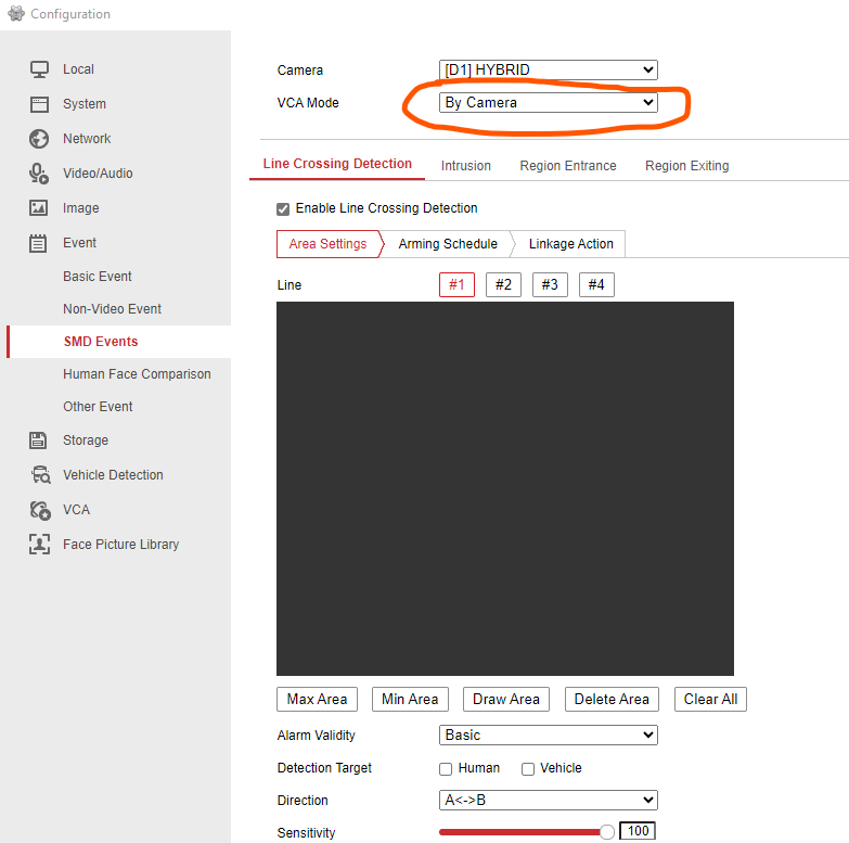

Below is where is my selection for VCA By Camera or VCA by NVR

Hi @alfacivi you must have a different NVR as I don't have the 'SMD Events' sub-section under the 'Event' tab.

Yes this is different. Mine is an Accusense K series
If your NVR is an M series then the similar setting is AI by NVR enable or disable.
I don't know the model but an example is here at page 50:
