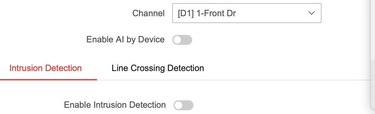

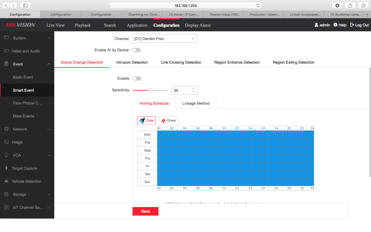

I edited my post. If you delete configured areas and disable the events, turn off the switch and save you can avoid resetting (I was a bit hasty)Ohhh ok, I thought "Use device AI" was meant for camera AI (device=camera imo) like I said interface are quite confusing.
I first bought the camera to test AcuSense and ColorVu, I really like it so recently I bought the NVR, so yes, camera was already configured. and the I adde the NVR.
So not looking forward to it but I will reset the camera, do I really have to reset both? If you think it's better I'll just do it.
You're not wrong about the "Use Device AI" button - it should say "Camera" or "NVR", it's ridiculously confusing and I've made the same assumption as you previously. In the NXI-K series it is clearer with VCA Mode "By Camera/By NVR":
Whereas in the NXI-I series confusingly it shows:

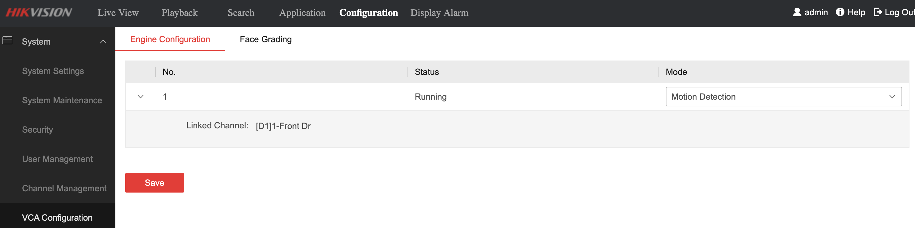

When you've deleted, disabled, switched off the 'Enable AI by Device' switch and saved go to the following page. Configuration > System > VCA Configuration. In the example below I'm using the NVR AI for one older camera that doesn't have AcuSense. In your setup with the switch off, The AI Engine should not be running and should have no linked cameras.
