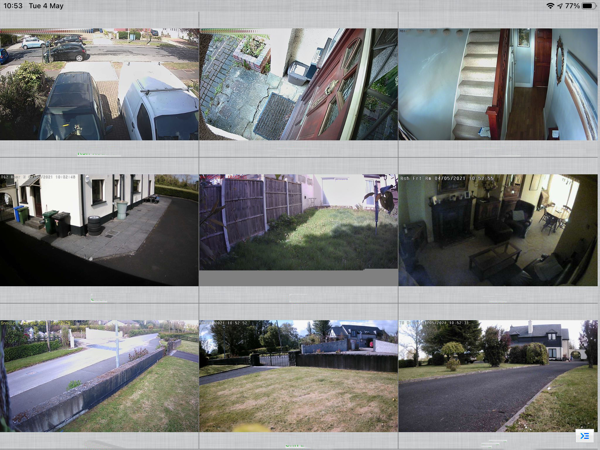

I agree its not been helpful with the ucam app no longer functioning , but it was far from perfect. Pic below showing nine of my cams in different countrys & locations using the IPcam app, and even though it is a little more difficult to make changes to the camera settings, the cameras are far from been redundant. All The Best metroman

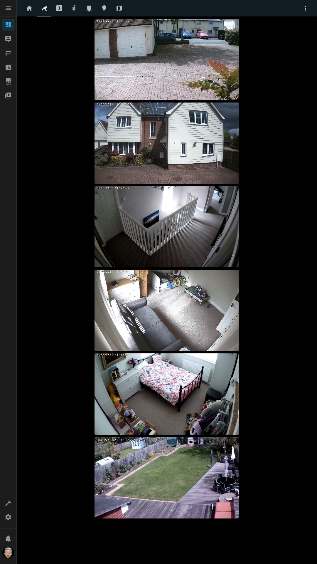

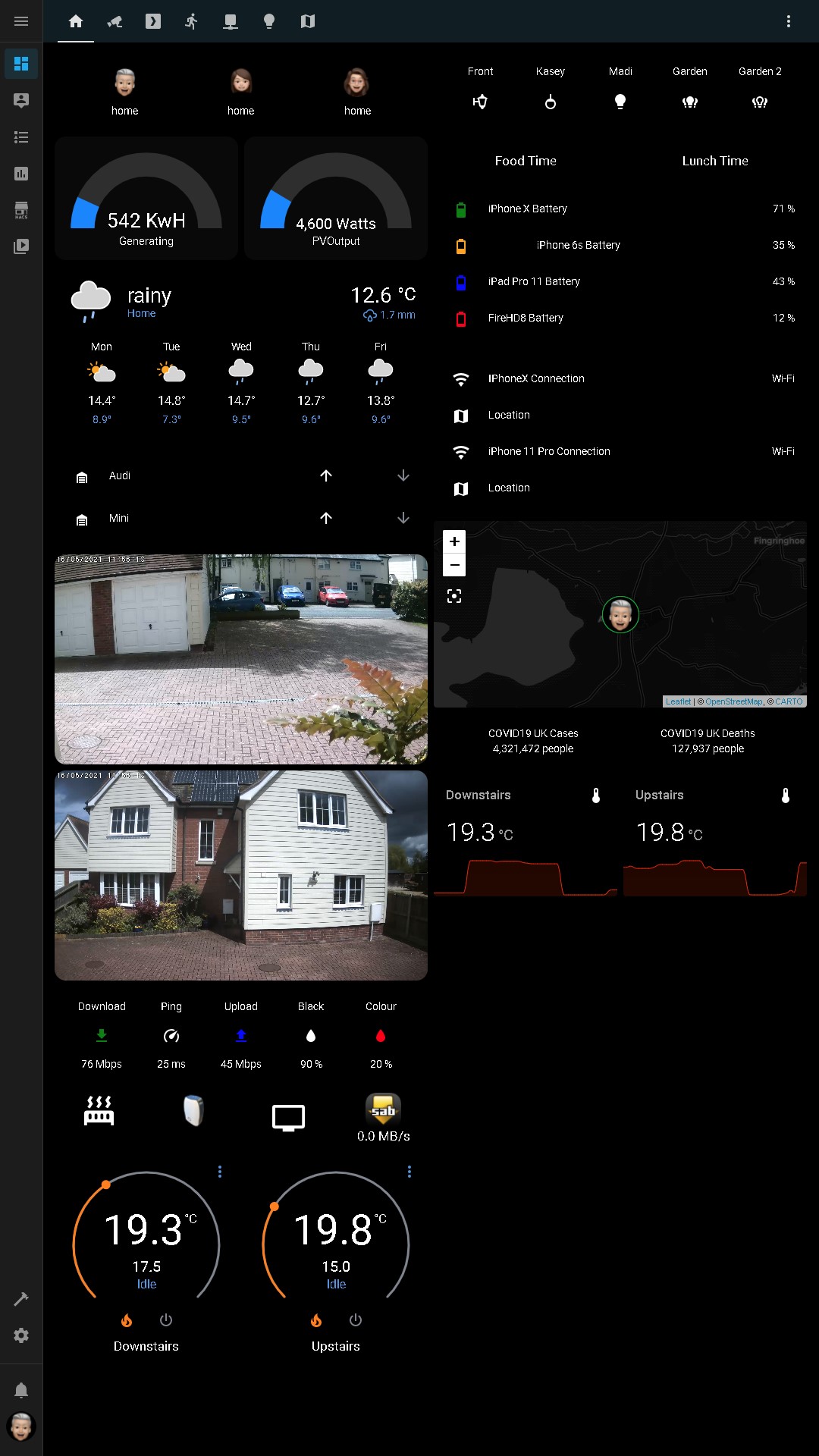

The other reason I've not noticed the lack of connection is partly due to the fact that I've moved my camera monitoring mostly over to Home Assistant.....and this still lets me view my cameras on 4G or another Wi-Fi network when away from home without issue...where they are basically viewed as IP cameras and therefore don't rely on the P2P network anymore....I'm also lucky enough to be running a Synology NAS which has licenses for two cameras as standard so I can also use the DS Cam app to view my two most important cameras (at the front of the house)

For those who like to tinker even more, I can heavily recommend home assistant....of course this isn't an out of the box solution and does require some additional kit (a Raspberry Pi 4 and an SD card will be enough but I run mine in Docker on my Synology NAS). It’s fair to say this , in its most basic form, only give you viewing ability, but it works on your internal network and most importantly on 4G or any other Wi-Fi connection. It is also possible to setup notifications from it as well but even I haven’t bothered with that for now as the ucam cameras, at this moment in time, still manage to send emails on alarm triggers and record footage back to my NAS. Home assiatnt does a hell of a lot more as well....mine now monitors my entire home, all of its smart kit and a whole lot more.....its certainly not for everyone but as a tablert which will sooon be wall mounted, it for me, is the best way forward for any smart home control. I t also has phone and tablet apps, and runs on any browser too...Ive attached a copy of some of my screens from my PC to give you an idea of how it can look with a little work

Images below are two of my home assistant pages.....they display pretty much the same on my phone and tablet
