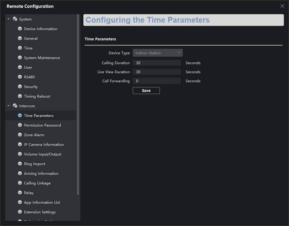

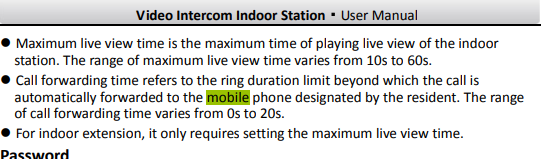

There is setting called Forwarding time or something like that. Set it to 0 if it isnt. This means after how much seconds it will forward the call toward application
I've been looking into the setup. And it's set to 0.
