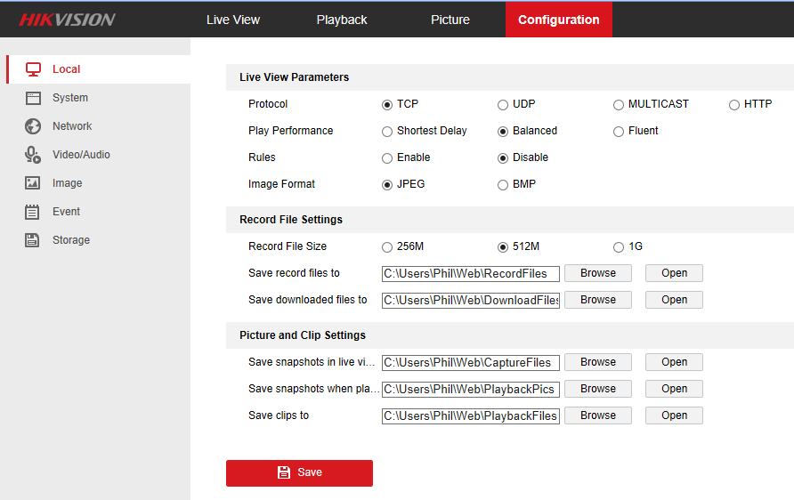

Hi, You can configure the pathname for where they are saved - Picture and Clip Settings as below:
(NB stop playback, use Internet Explorer in 'Run as administrator' mode)

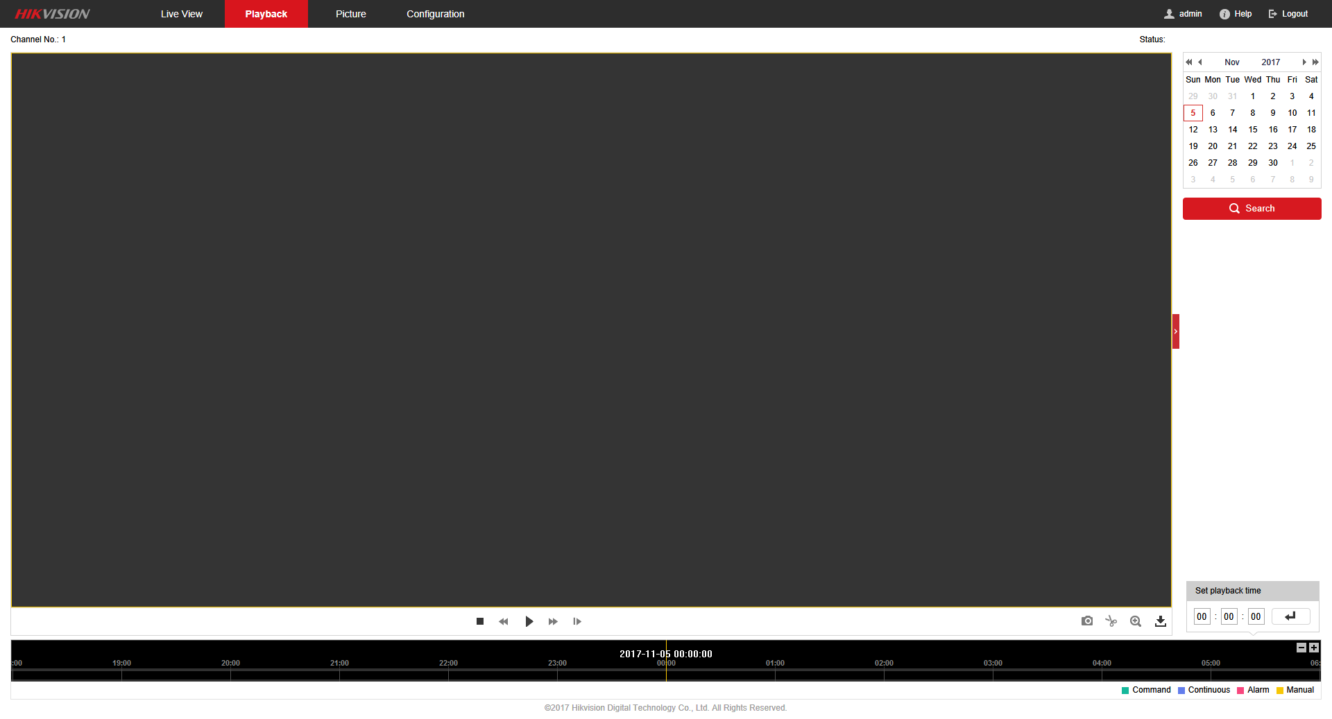

Use Internet Explorer.
Enter the camera's IP address in the browser address bar.
Login.
Select Playback from the top menu bar:
