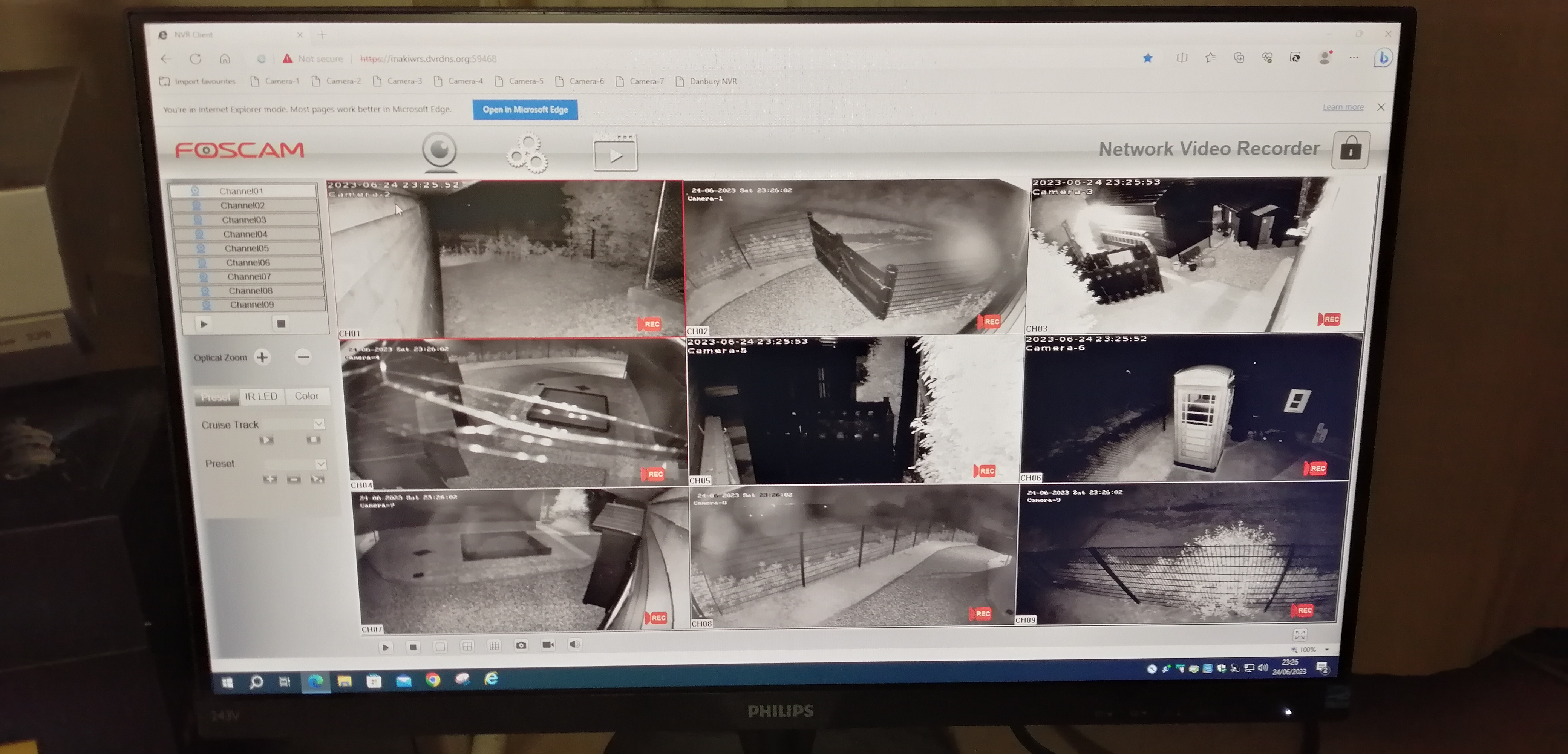

This is the standard way I monitor the larger site - live viewing 9 cameras simultaneously using just Edge, over the internet, forwarding just a single custom HTTPS port.
I sign in to the Foscam NVR and get this:
I then click on the "full screen" button in web interface window and get this:
And then it can just sit there. All 9 camera streams combined into one with ZERO effort.

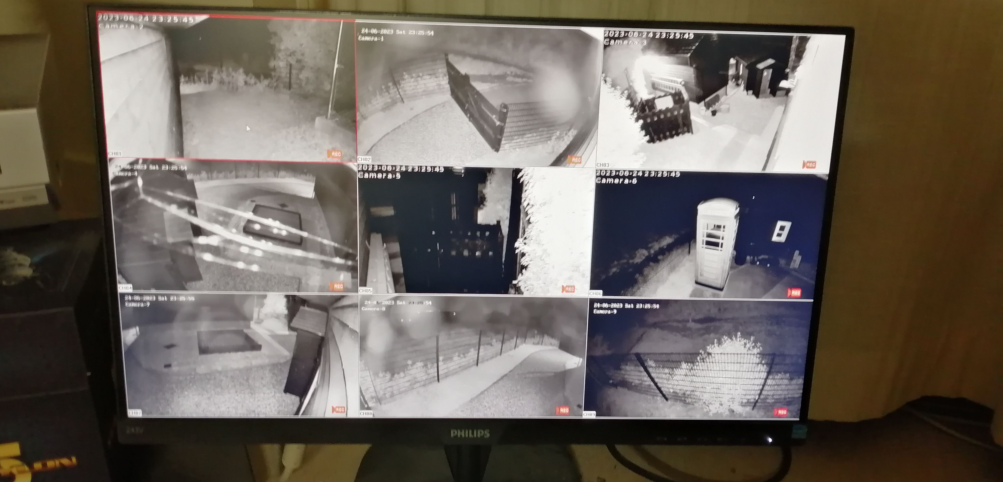

And (with their rather dire plugin) playback recordings from any four channels simultaneously.
In that view 4 of the cameras are Foscam, the other 5 are all HikVision connecting using ONVIF.

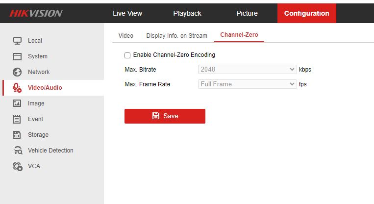

I do but I'm not sure that it's a requirement. You need to access the local configuration (using the local menu and monitor) to switch it [channel zero] on. I don't use channel zero and just turned it on briefly to test that RTSP stream url. I'll try it again when I get a moment and disconnect the monitor to see if it still works. I think another user mentioned plugging in a HDMI emulator. I wonder if somewhere like www.lindy.co.uk do one.
On my NVR it is under the Video/Audio settings, not local.
So I can turn it on - but I don't get any image.

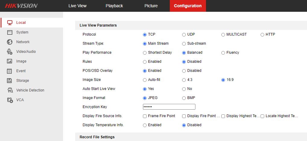

Interesting, the web GUI on the newer M series is different and the option for Channel Zero appears to be missing. When I mentioned 'local' I meant by selecting the configuration using the mouse on a directly connected monitor.

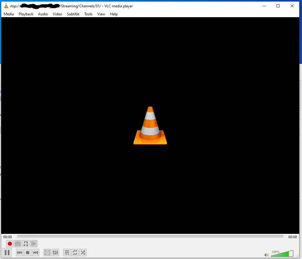

When I enable Channel Zero on mine and try remotely viewing it over RTSP all I get after the sign in prompt is this:
@George-H. It works fine for me. I tested the following:
  • rtsp:local_ip_address:nvr_rtsp_port/Streaming/Channels/01/ - tested with monitor connected, while connected to the same network
  • rtsp:local_ip_address:nvr_rtsp_port/Streaming/Channels/01/ - tested with monitor disconnected, while connected to the same network
  • rtsp:wan_ip_address:nvr_rtsp_port/Streaming/Channels/01/ - tested with monitor disconnected. MacBook tethered to an iPhone with WiFi off (using 4G mobile connection to prove it works remotely via forwarded RTSP port)

Ignore that...I'd forgot to configure it on the NVR.....
System > General > Live View > Channel Zero (to enable it).
System > General > Live View > General > Video Output Interface (select Aux CVBS/Channel-Zero) > Live View Mode (set to 3 x 3) and it works as wanted.
Alternatively I can set it 2 x 2 or even 1 x 1. By combining that with a dwell time it will sequence the 2 x 2 screens (or full screen image). That would work a lot better for you, as you can utilise the full 2,048 kbps into fewer (or a single) camera which is drastically improving the image quality.
