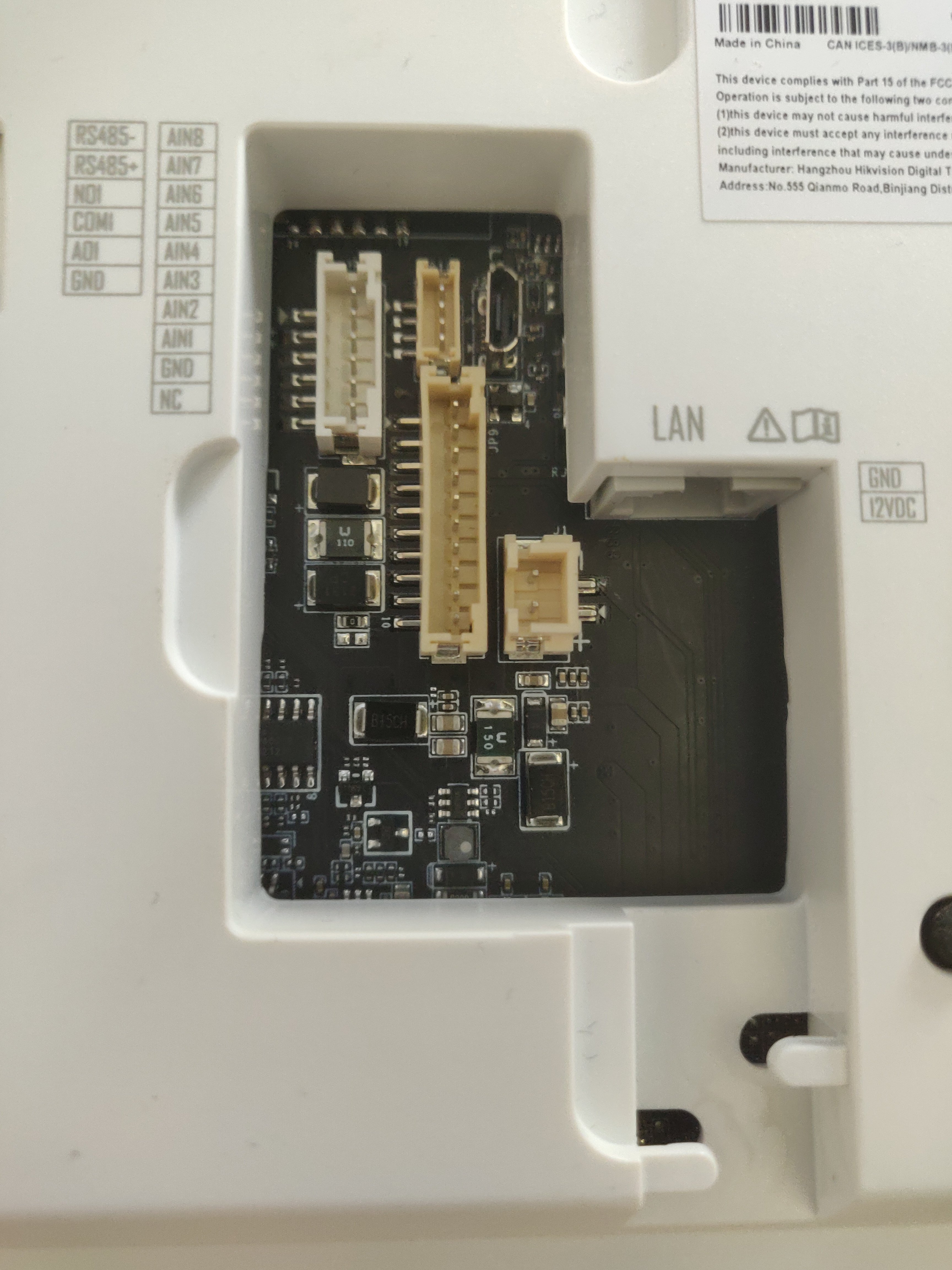

Door Entry RS-232 cable, where to get?
Ok, I will check output first of that USB rs232 to TTL convertor, if it gives 3vdc , I should be ok?
Yes but you also need to check the device as well. What model indoor station are you using?
Ds-kh9510, hikvision gave me the picture I showed in first post, the connector on it is also JST ZH
The 4 pin JST ZH connector looks the same as mine on the NVR. The black Tx wire on the JST ZH connector assembly should be around 3Vdc, I measured mine with an oscilloscope, a DVM should be the same.

It should be, but even mine bootloader didnt came up, it was replaced eventually by another device
