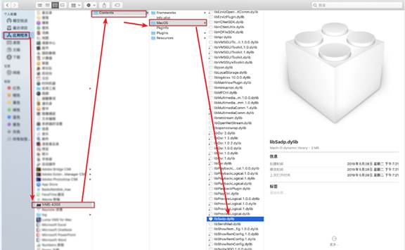

I have the fix for iVMS-4200 on MacOS Catalina :)
Unzip this file and replace the one in the apps bundle.
iVMS-4200 now works for me on MacOS 10.15.2

Sorry, I should have said. I was sent it by Hikvision. If you click `Get Help` on this support page Support then say `iVMS-4200 doesn't work on Mac Catalina` it tells you to email them and they'll send you the file to fix it.

No offence taken, but you can follow the same procedure I did to get a fresh copy of the file if you wish.
Go to Hikvision website and in the help chat bot enter "iVMS-4200 doesn't work on Mac Catalina" and it tells you to email them to retrieve a file. You can email them and get your own file, it only took them 2 days to send it.

The file and fix is genuine, it was shared with us in late December when we were trying to solve the issue with one of our own customers, but we didn't share it at the time as 1) it looked like a fix that could easily confuse people and lead them to break the software further 2) it did not fix the problem for the customer we were dealing with.
But now other users have also been given this file and it would appear to work for most users, it is meant as a temporary patch to v2.0.0.10 of iVMS-4200 until they release v2.0.0.11 which they are working on but is still a way away from being released.

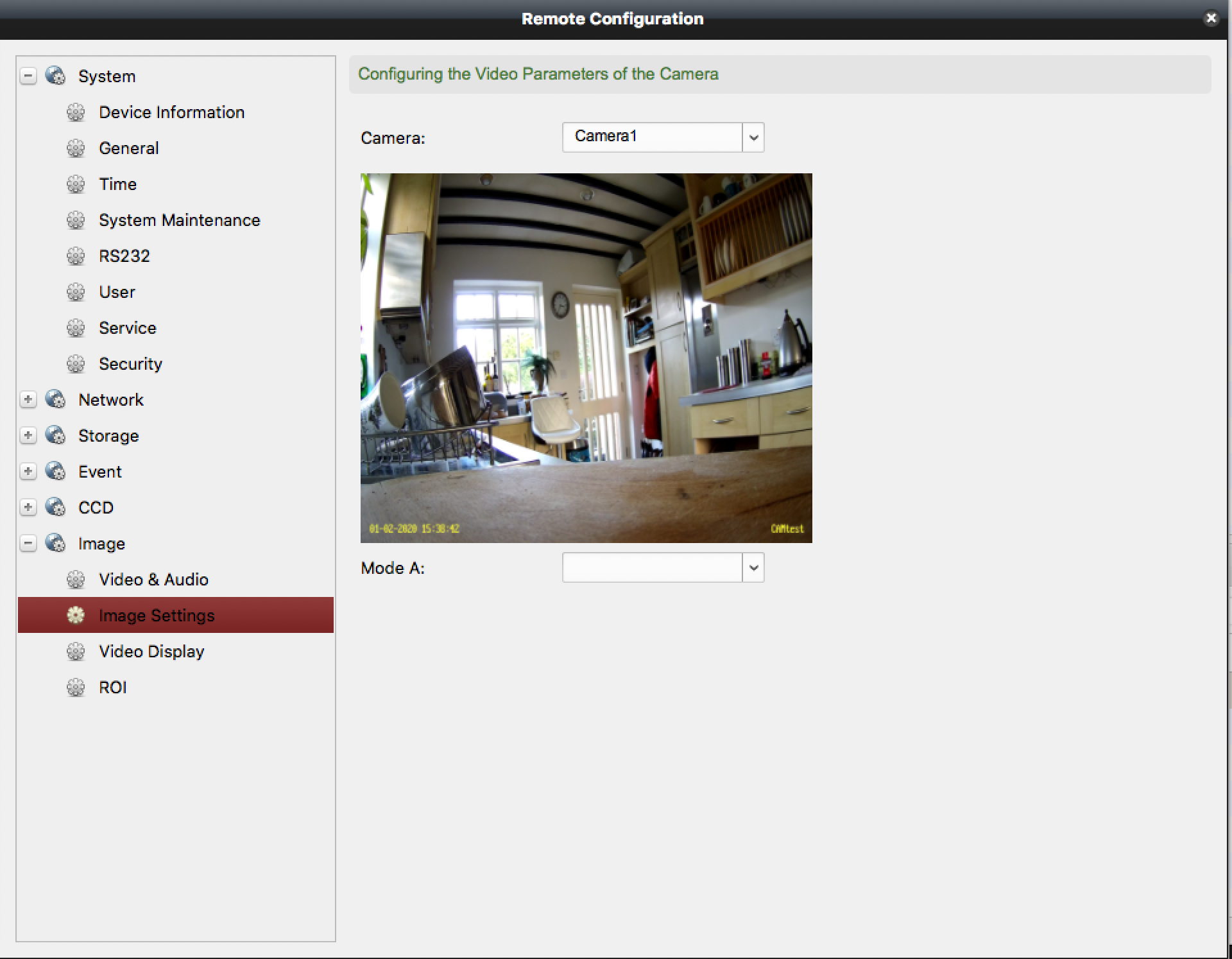

2.0.0.11 feels like a more solid performer, albeit slower to launch and quit for me and a tad slower to jump between config panels. It did take several attempts to get it to display Live View from a bench-test camera but it did find it eventually. I'm seeing mini Live View displays in all the right config screens; but for reasons unknown, I'm not being offered any settings to configure in the Image Settings window. Where'd they go? I can get them via my browser but it's a bore to have to switch - and of course my browser has the opposite problem in that it shows my Image Settings but not the live feed so I have to adjust brightness, WB etc in the dark.

I think 2.0.0.11 is the latest. Are you able to get live feeds showing in any Mac browser?

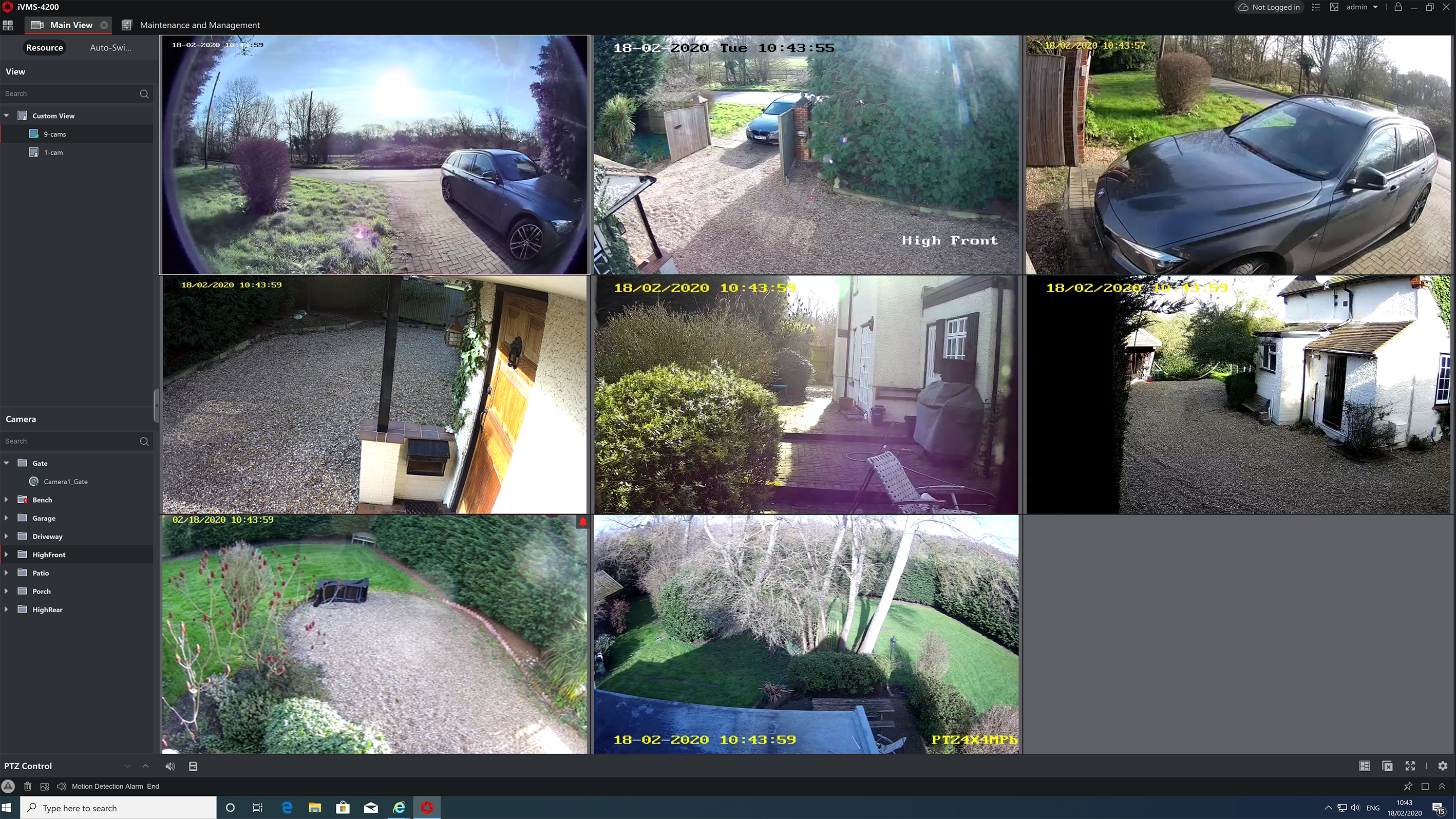

FWIW, the shortcomings of iVMS on MacOs led me to install Parallels so that I could run the Windows version of iVMS and especially Windows Explorer (not the pre-installed Edge browser) which does load web configs properly once the prompted web plugin has been downloaded. Switching to Parallels is as fast as switching to any other open Mac app so it's a pretty good workaround even if iVMS runs a bit slowly in Parallels. It's certainly usable for as long as you need to access the web configs and you can then switch instantly back to MacOS for day-to-day running - in iVMS or the much-faster and much-more-stable Security Spy (expensive for any number of cameras but really well-written exclusively for MacOs). For fun, here's a screenshot of my newly installed cameras from iVMS running under Parallels:
