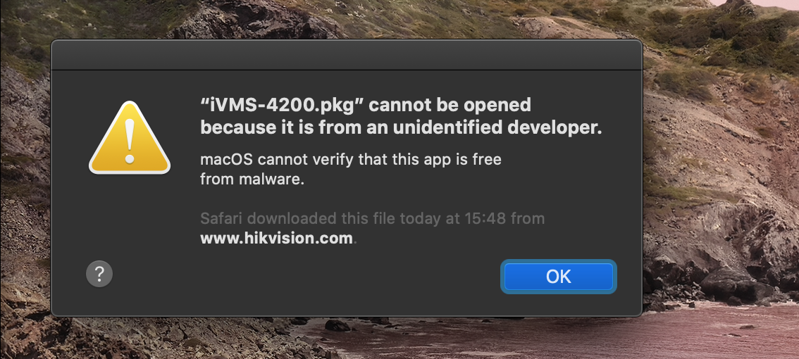

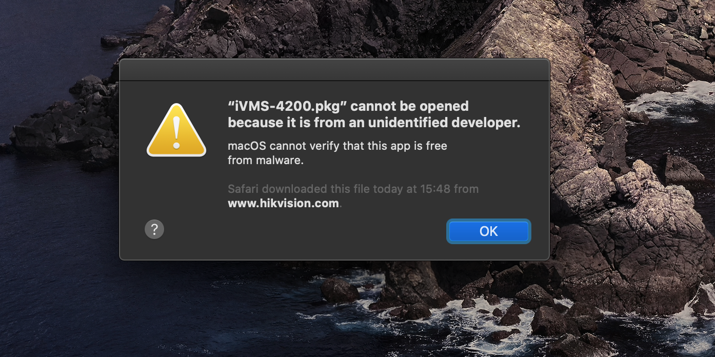

We have had several customers and forum users reporting problems running iVMS-4200 since updating to MacOS Catalina (10.15), the reports have varied from some saying the software runs ok but does crash unexpectedly to others saying the iVMS software does not work at all.
If you have G1 cameras (2xx3G0/2xx5FWD/2xx5G1) and/or an I-series NVR you can get around the iVMS issues by updating to the latest firmware and logging in to the NVR/cameras with any browser using the 'plug-in free' solution.
But if you have to use iVMS-4200 for a particular reason or have older Hikvision R6 (2x22/2x42) or R0 (2x12/2x32) cameras and/or K-series (and older) NVR models then your best solution, for the time being, is to NOT update to any version of MacOS Catalina. If you have already updated to Catalina and you need to access your NVR/cameras urgently then there are a couple of things you can try:
