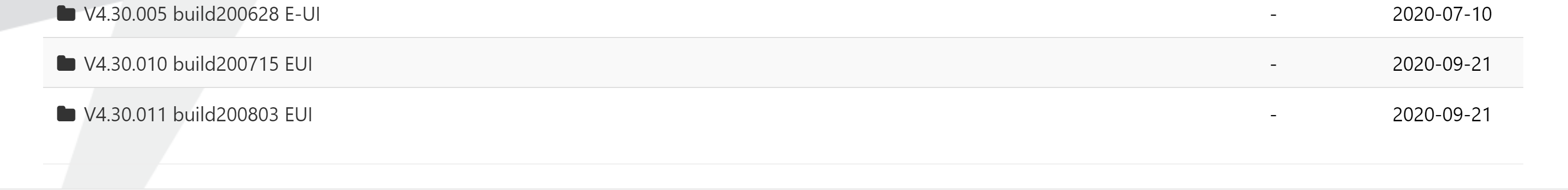

Could someone help with the latest firmware for DS-2CD2346G2-ISU/SL?
When i navigate direct to the DS-2CD2346G2 product page (which contains all the specs etc) you can also download the latest firmware on there. When i do i get 5.5.135 build 200610.
However when i navigate through the link on the forum for firmware, and through the usual tree hierarchy etc i get 5.5.134 200430 (by this route: G3 platform(2XX6G2 3XX6G2) » DS-2CD2XX6G2).
Just wanted to check that the firmware main navigation page is out of date and i should be using the 5.5.135 found direct on the product page?
Hi @ImRickyTan
There are different versions available depending on your region, as some regions require specific updates.
You should use the UK Portal if you're based here, which actually has a newer version than the two you mention - Hikvision UK Portal - G3 Camera Firmware V5.5.150 build200927
The portals are always the first places that the updates are made available, so is always the best place to download them from.
