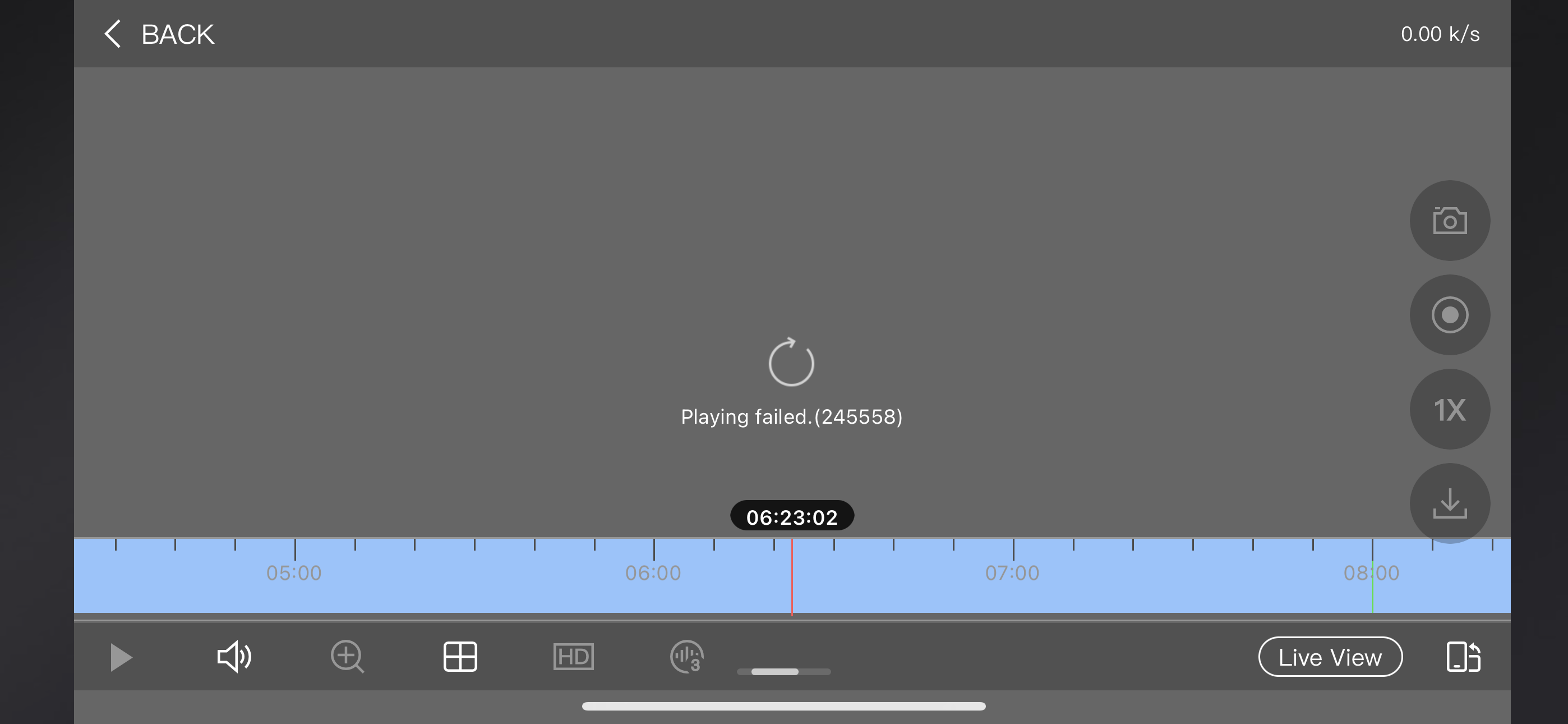

The reason is that on occasions and on different cameras (I have four of the above model), I have been getting “Playing Failed” error message when trying to playback footage from my Hik-Connect app on my iPhobe. See screenshot.
If I go to the affected playback directly on the NVR then the playback is ok so I thought maybe try installing the latest firmware on all cameras.

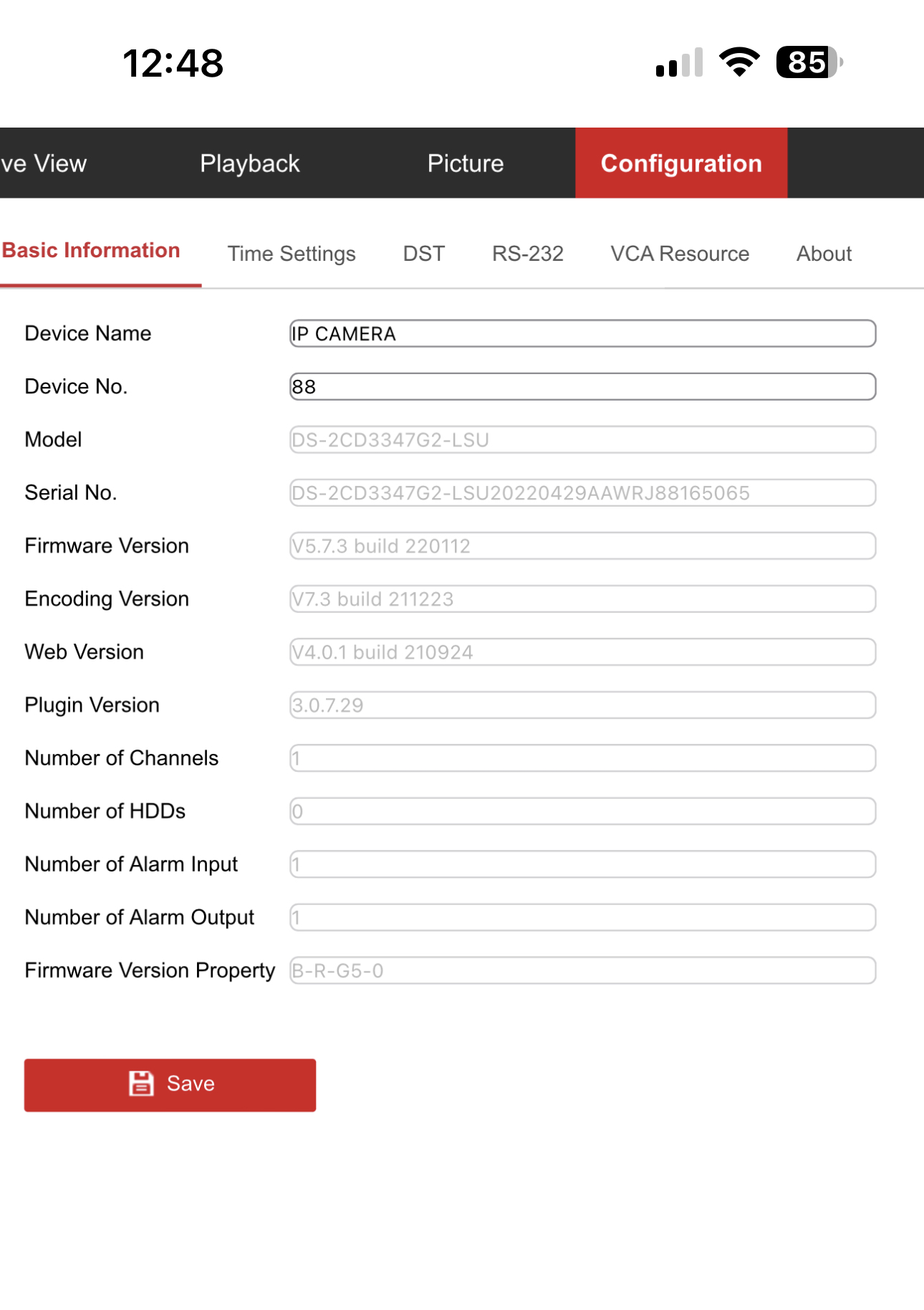

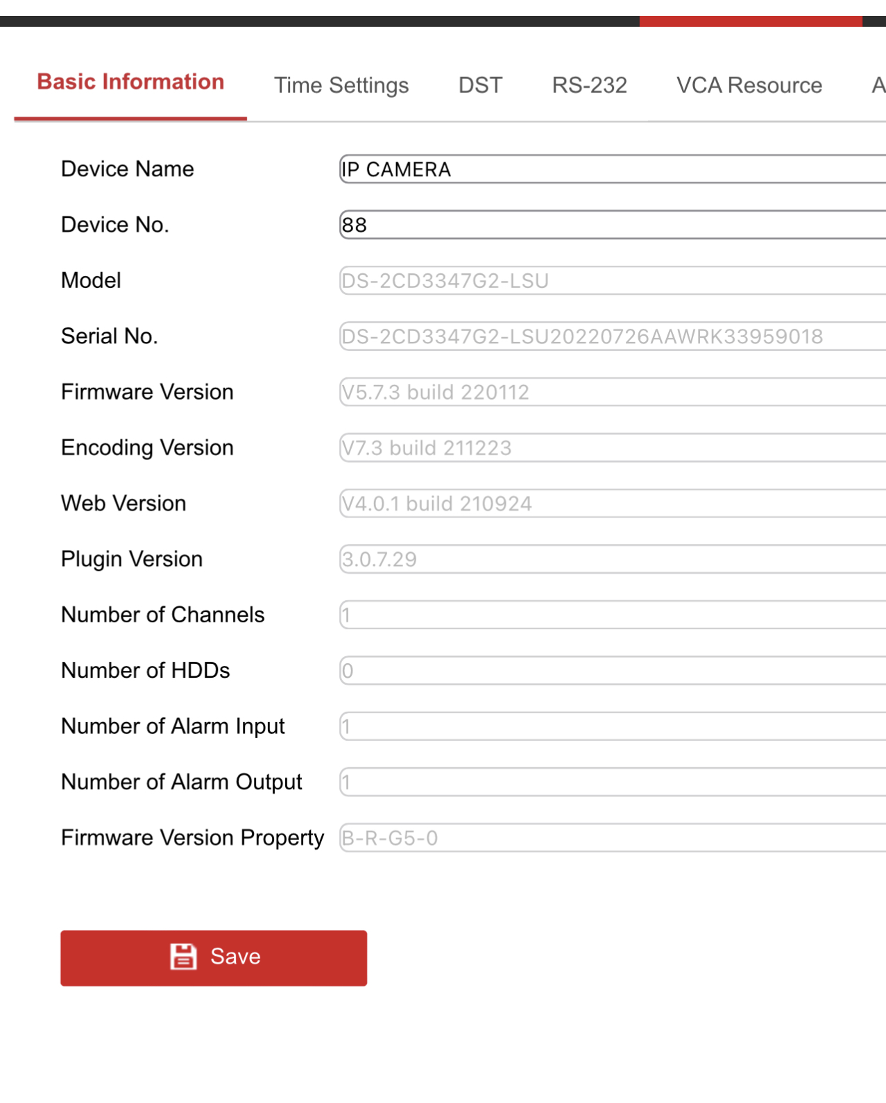

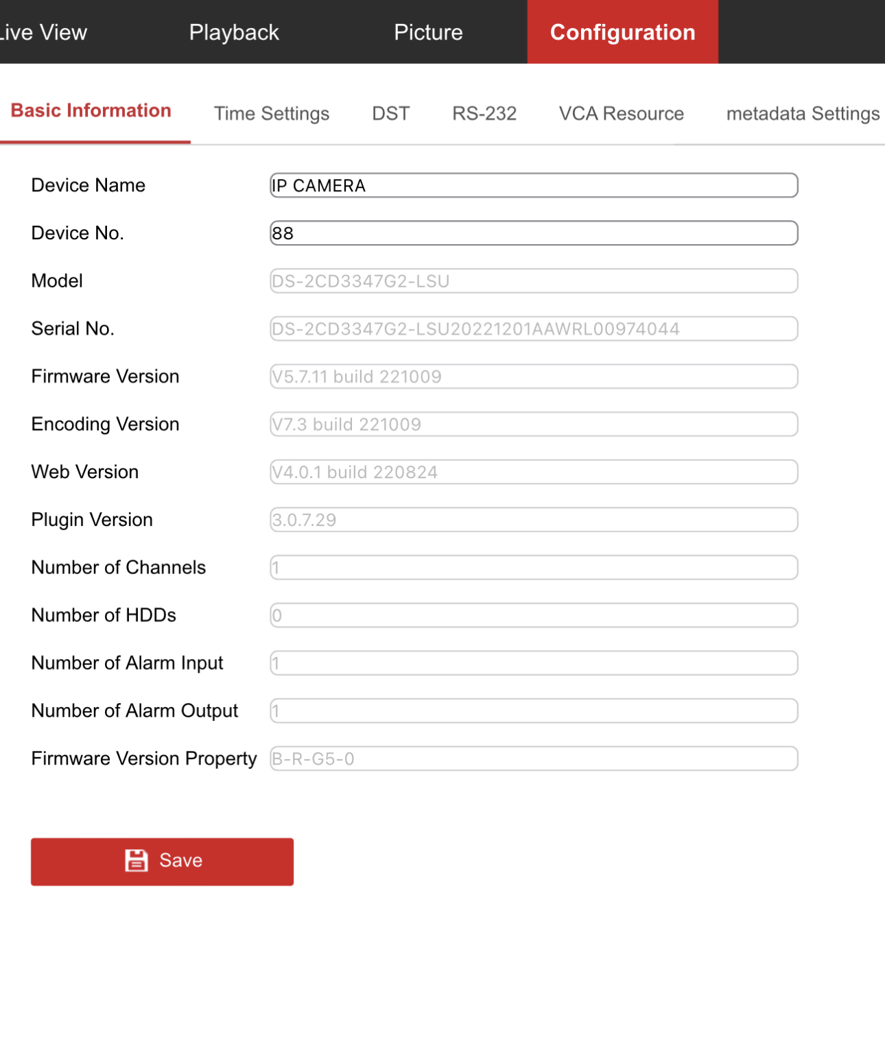

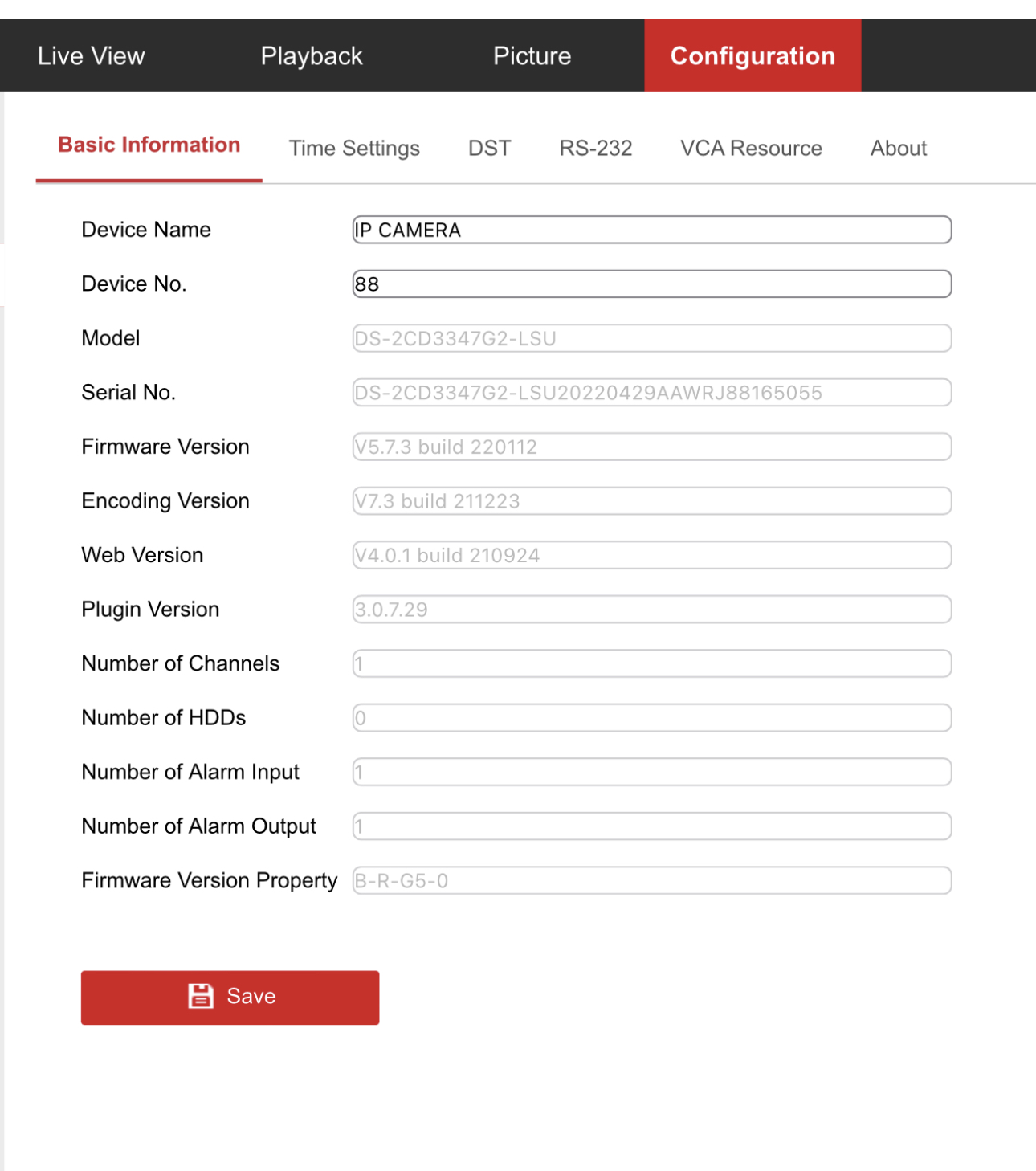

Please find attached the screenshots of each camera showing the current firmware versions. On one then I think it’s a different firmware.
However, the issue is occurring on different cameras and today there was a playback error on a different camera from midnight to around 8am after which it was ok on my phone app.
Going on to the NVR and playing back the time frame and it’s all fine so is it something to do with the Hikcinnect app on my iphone which is up to date I think v5.4
Also, I thought if I can get the link to the latest firmware for the camera model then I could try installing this on each camera.
