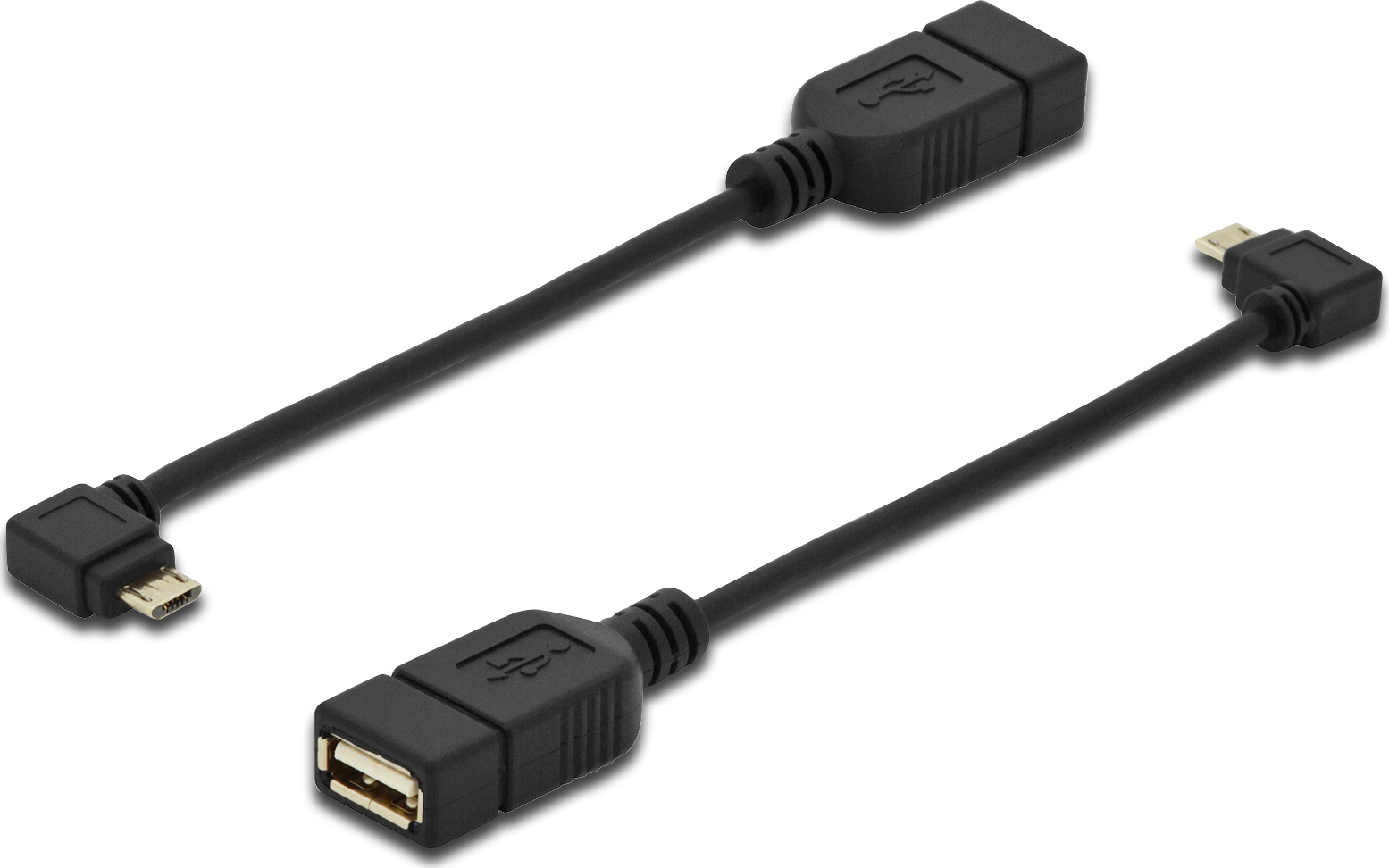

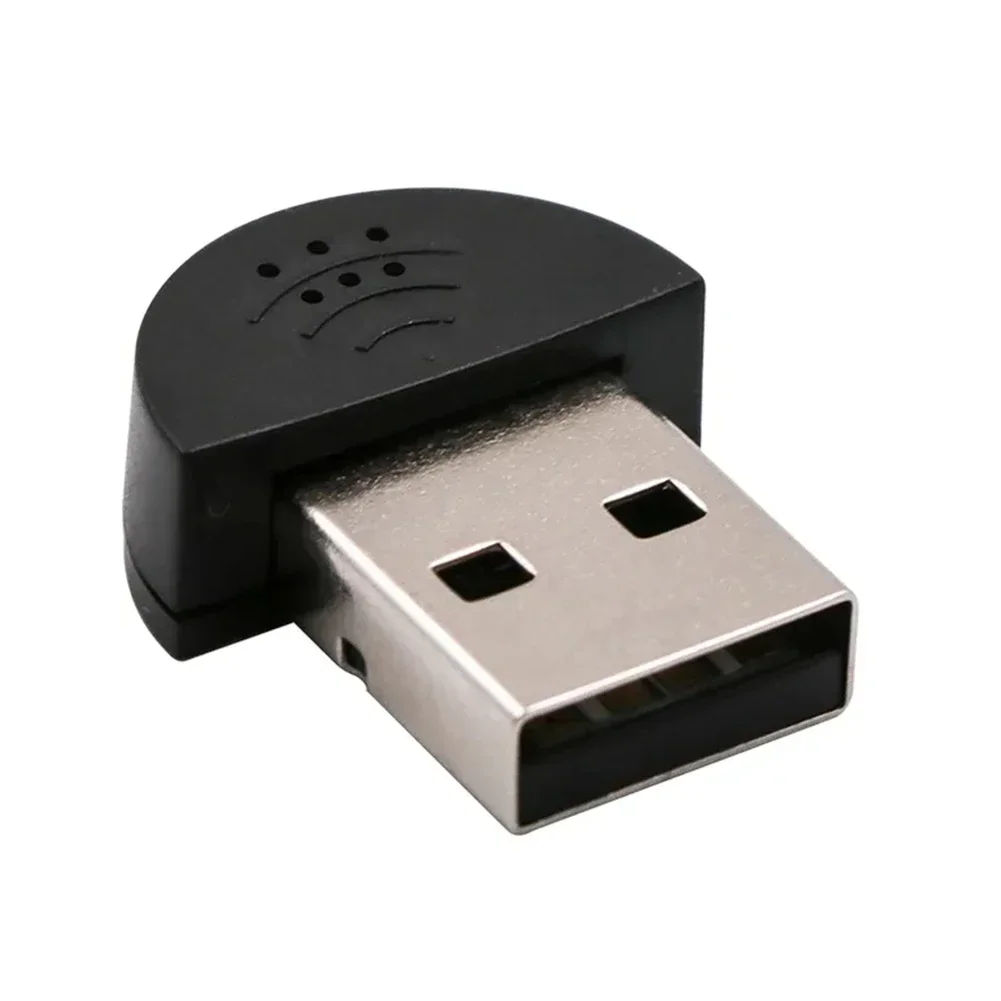

I have a semi-solution for DS-KH9310 indoor unit; The back panel has a micro usb port that means you can connect an external microphone and automatically Android uses this microphone as the main one. I managed to do an experiment using the following:
1. Using the following MicroUSB (M) to USB-A (F). Please note the angle of the MicroUSB
The MicroUSB cable must be capable for OTG else it will not work.
2. Plug a small USB A microphone
USB-2-0-Microphone-Portable-Mini-Omni-Directional-Stereo-USB-MIC-for-Laptop-PC-Computer-Chatt...webp
The sound was much better and completely different than the unit's microphone.
( Most of these products can be found at your local electronics store (and/or AliExpress) or you can create a custom one by chopping down a MicroUSB OTG cable and a cheap microphone and later do the connections)
