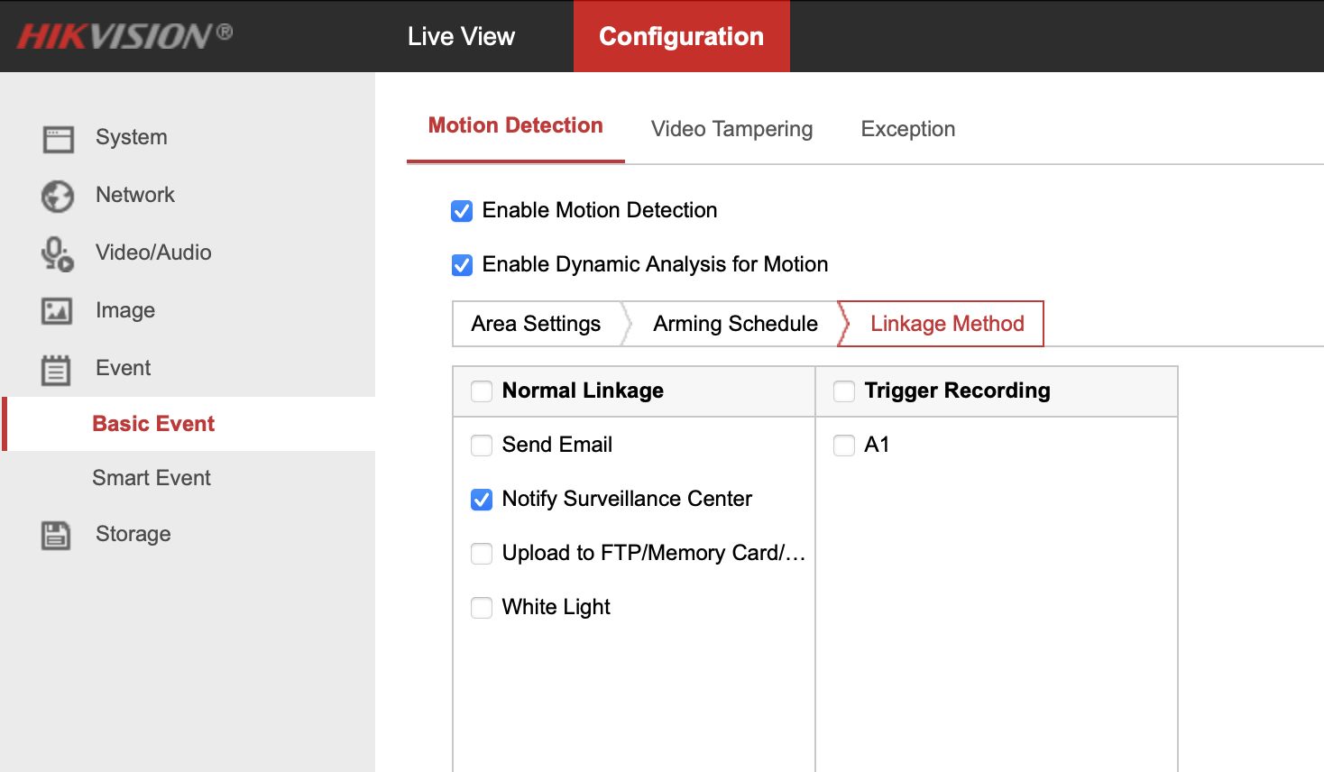

Do we have any way to activate LED light only on event on above mentioned model ?
Thanks a lot.. One last question,
Not a clue on that one as it's not a model that's available in the UK. If it's an available option you will see it in the settings - there will be a tick box called 'White Light' in the Linkage Actions as in the image below:
If the option is not there, you should check to see that you're on the latest version of firmware for your camera. It's an option that was added to various camera models in newer firmware.
Thanks for the update. But the option is not there even i updated to the latest. :(
Current version - V5.7.12 build 230614
