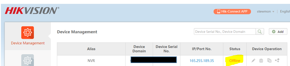

If you log into your account on the hik-connect.com web portal, what is the Status reporting?
Thank you for coming in on this StewartM. I have looged in and the status is showing as 'offline in red text on a yellow background.
However, I know that I am not offline as I am looking at the live images on my Hikvision monitor and it is showing as Sunday 20/10/19 at 19:18
