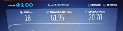

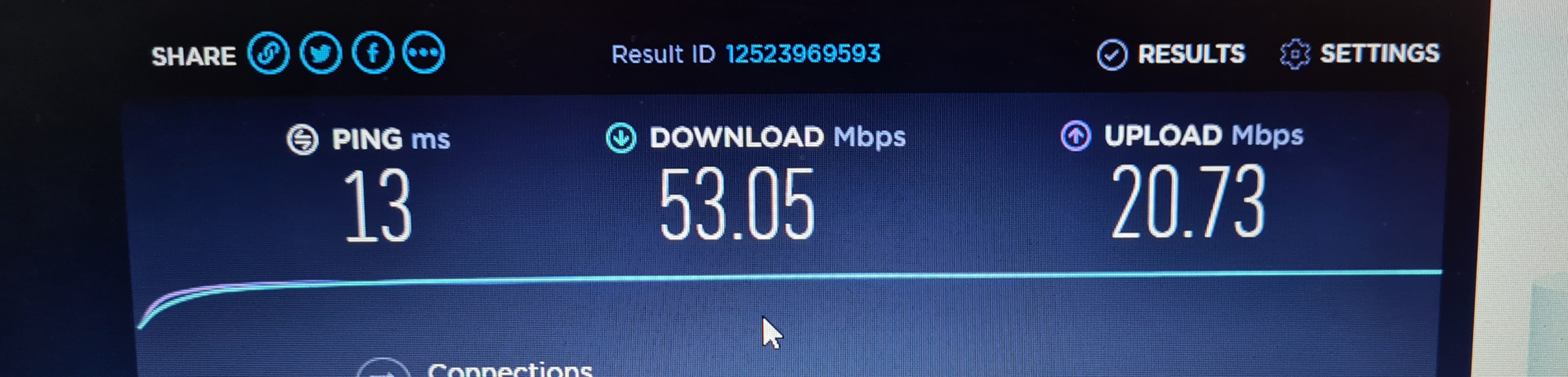

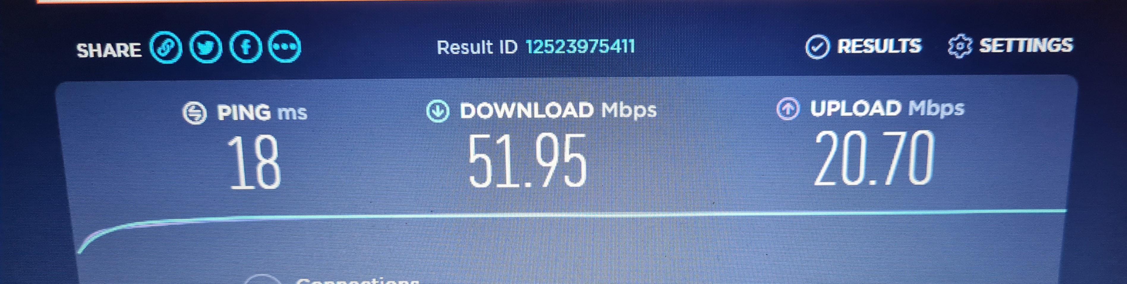

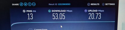

Had it plugged into an extension on the old swann system and it was problematic sometimes. These are in to the wall socket.

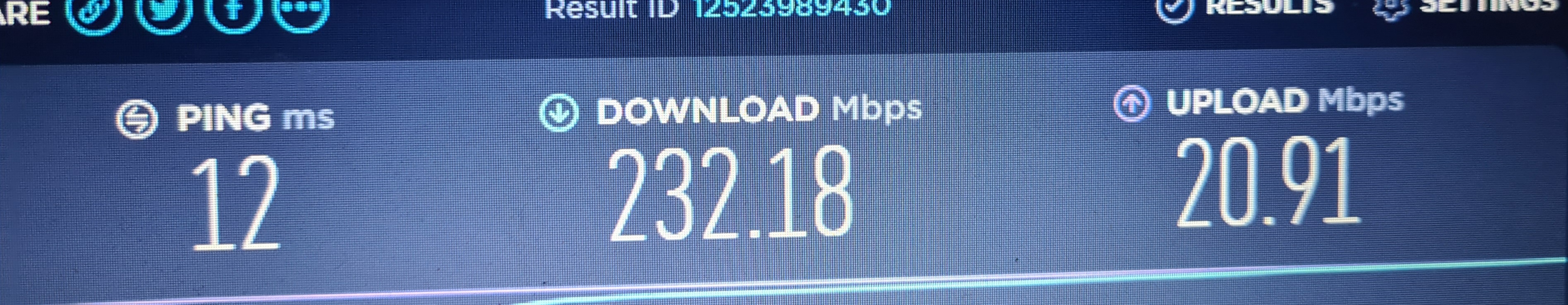

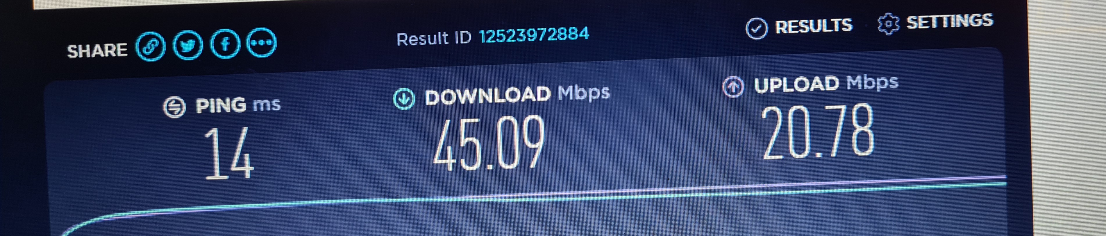

Just run a test with laptop direct to the router and got 216 dl 20 upl.
Repeated the test from the tp link and got 45 to 50 dl x3. Upl was 20.
I repeated the direct to router and got 230+ upl.

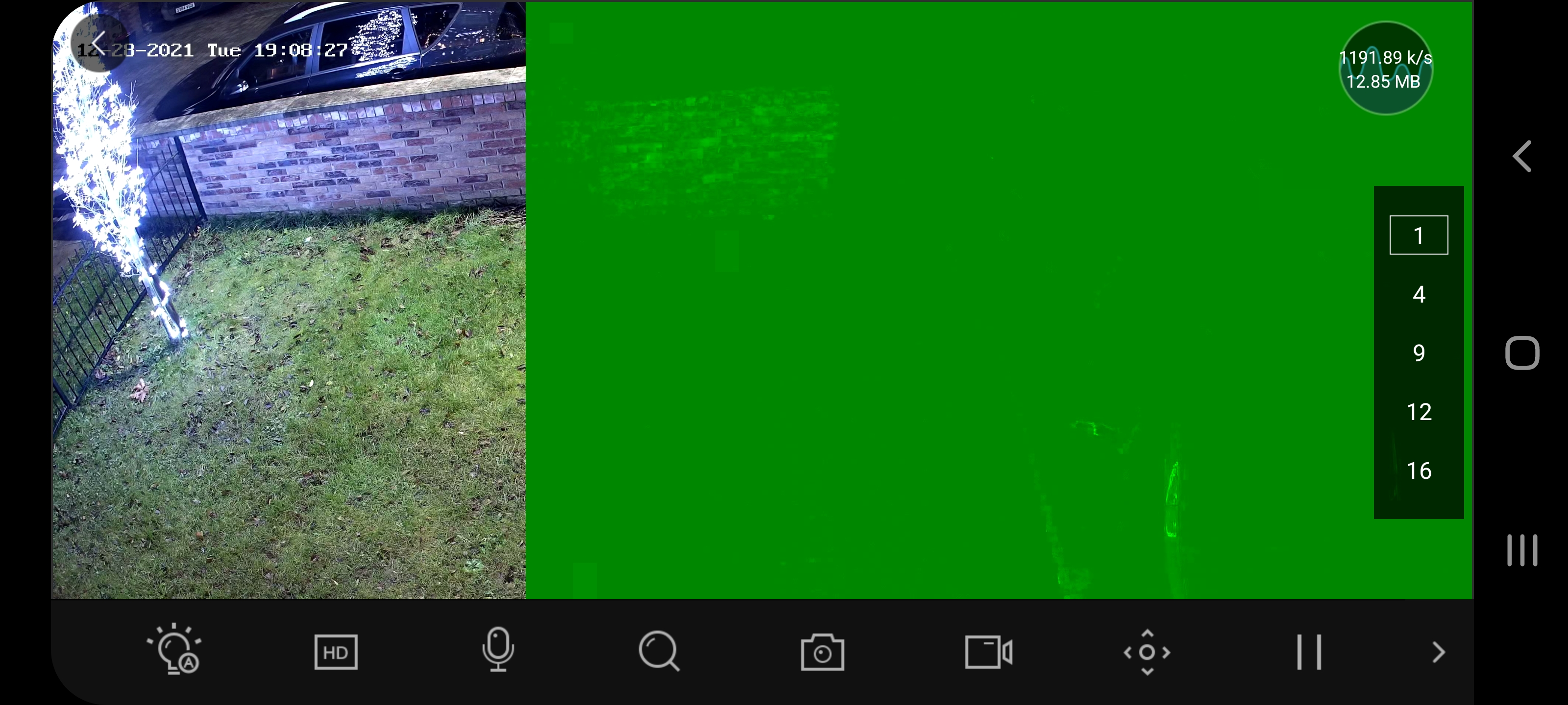

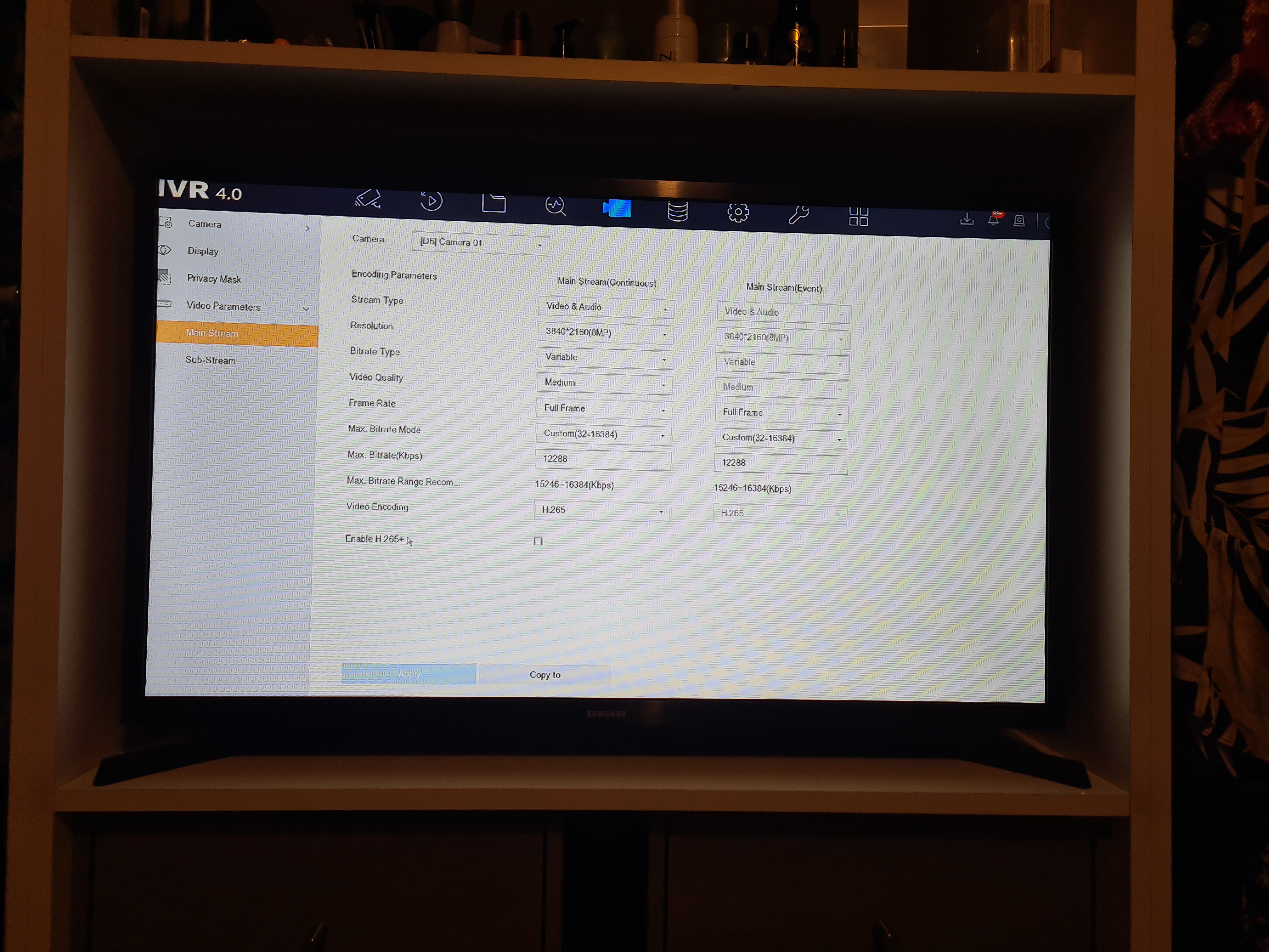

So I've linked a cat6 cable from the router to the nvr temporarily and changed the bit rate to the recommended settings but still get green screen in HD viewing.
I guess the HikConnect app can't handle 4k images. I'm now stuck as to what to do. Will have to live with clear 2k images on my 4mp and bleary is images on basic setting on the 4k.
HikConnect can certainly handle 4k images. I have three different 4K cameras on my system and can view them all via the HikConnect service, while set to HD without getting the green screen that you are seeing. It could still be related to the network. As I mentioned in post #10 port forwarding in your router generally works better than letting the NVR automatically map the ports. It's relatively easy to set up - you just need to:

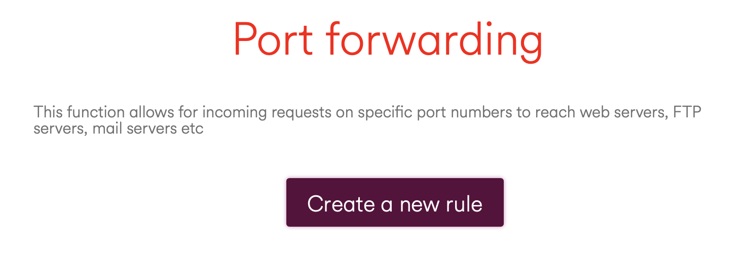

Port Forwarding for VM example.
In the example below before accessing the router, I've done the following with the NVR (local menu shown):
  • System > Network > TCP/IP > TCP/IP. Set a static IP address. In the example pics (and this is suitable for a VM network) IP address = 192.168.0.200, Subnet = 255.255.255.0, Default Gateway = 192.168.0.1, Preferred DNS = 8.8.8.8, Alternate DNS = 8.8.4.4
  • System > Network > TCP/IP > NAT. Disable
  • System > Network > Advanced > More Settings. Server Port from 8000 to 50001, Http Port from 80 to 50000, RTSP Port from 554 to 50002. (leave the rest)

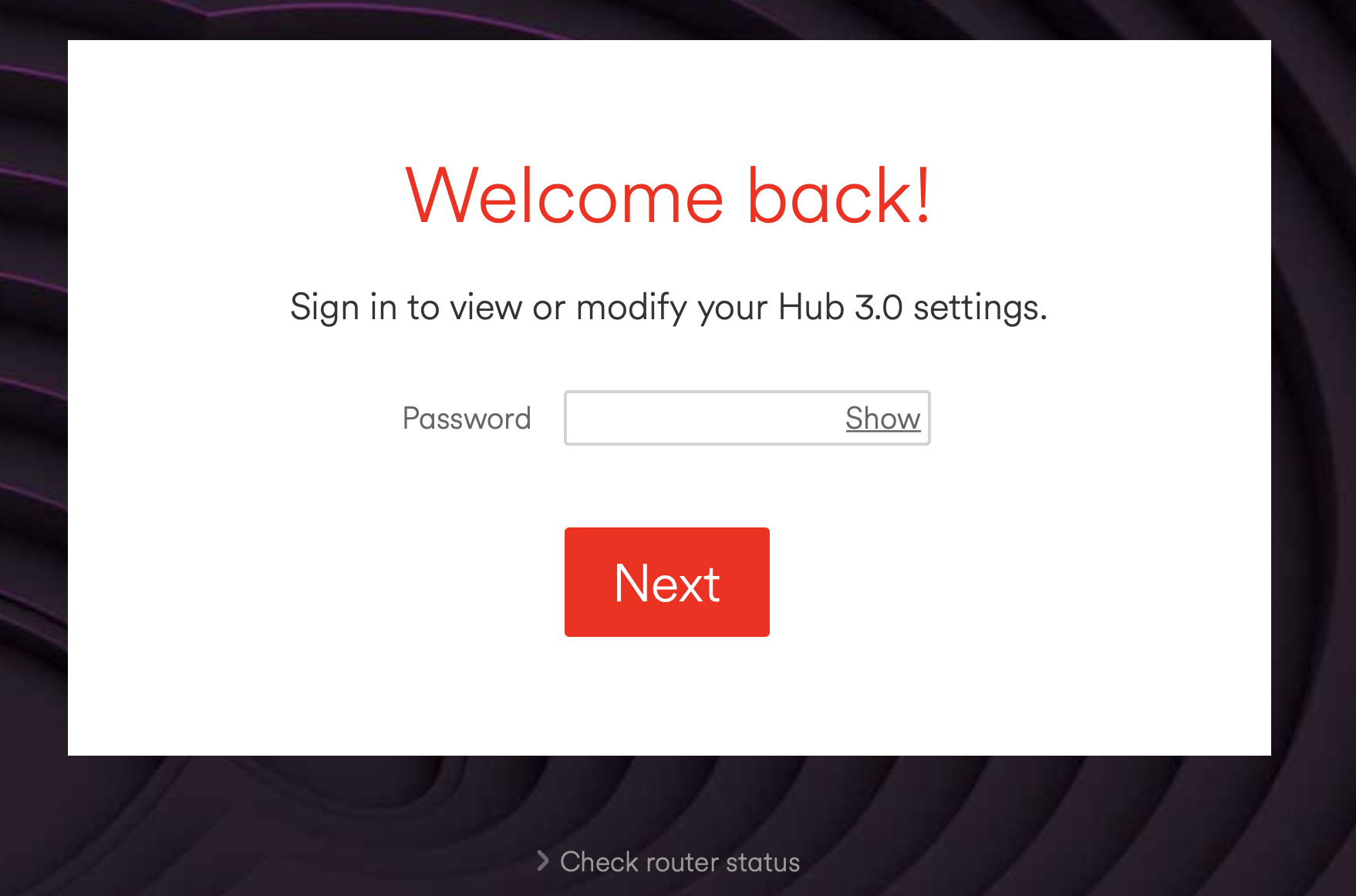

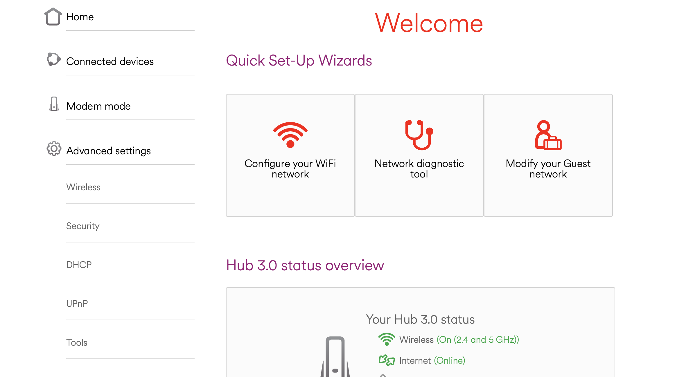

Navigate to http://192.168.0.1 with a web browser
Enter the settings password from the bottom of the router
Goto Advanced Settings > Security > Port Forwarding

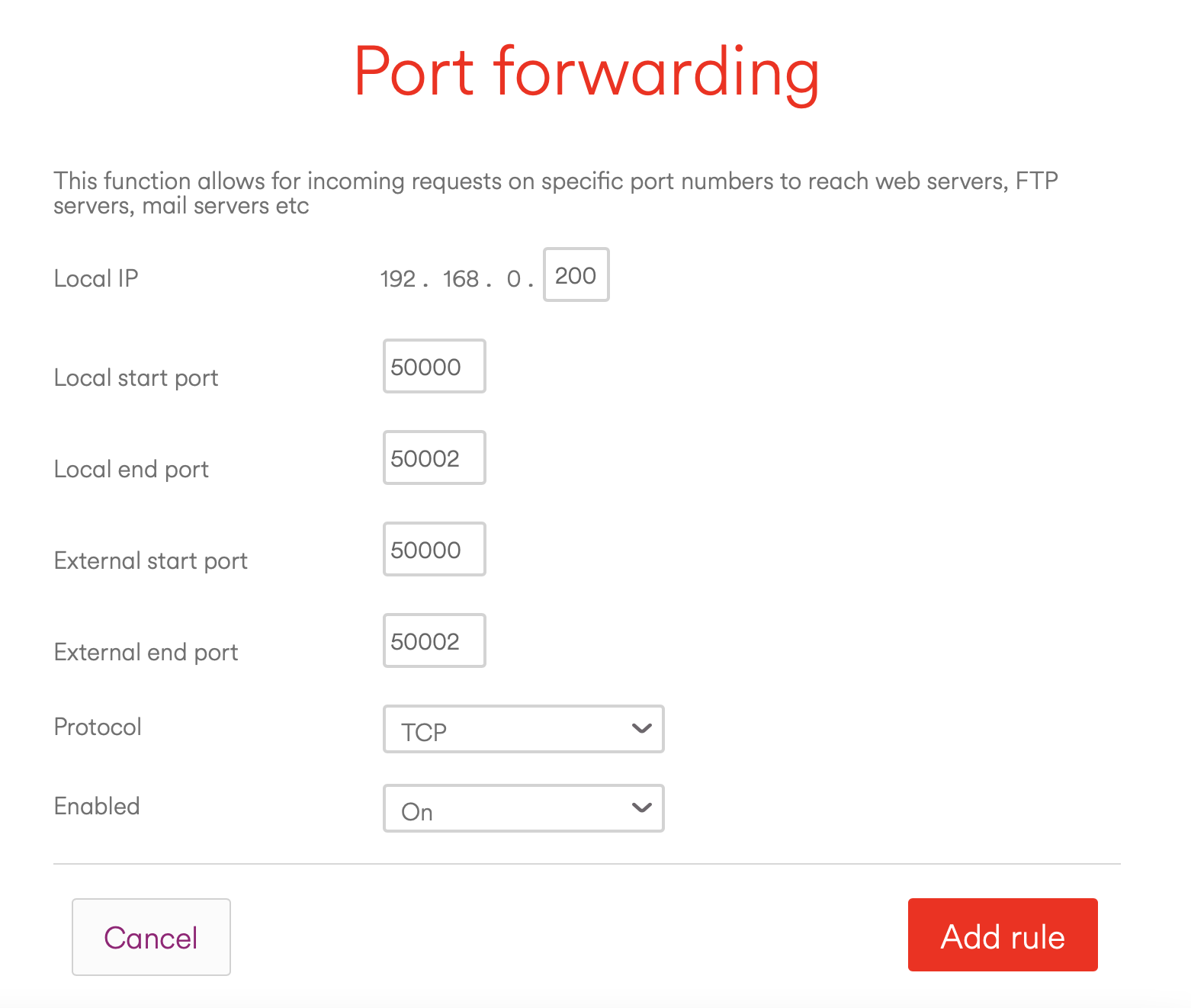

Click Create New Rule and fill in the boxes with the NVR IP address from earlier, the start and end ports for both local and remote, set the protocol to TCP and be sure to select Enable before clicking Add Rule. The picture below shows it using the IP and ports set in the NVR. If you had left your ports at default; you would need to add 3 rules one for port 80, one for 8000 and one for port 554. Some routers allow you to add a number of non consecutive ports to a rule by listing the numbers with a comma between them, but the VM Hub does not. For that reason I always set 3 consecutive ports as standard on all installations regardless of router model.
After clicking Add Rule, you'll be returned to the main port forwarding page where you will see a table showing the rule. Below that you need to click Apply Changes to save the rule into the routers memory.
And that's it for port forwarding. As I've changed the http port from it's default of 80, the NVR would be accessed in future using http://192.168.0.200:50000

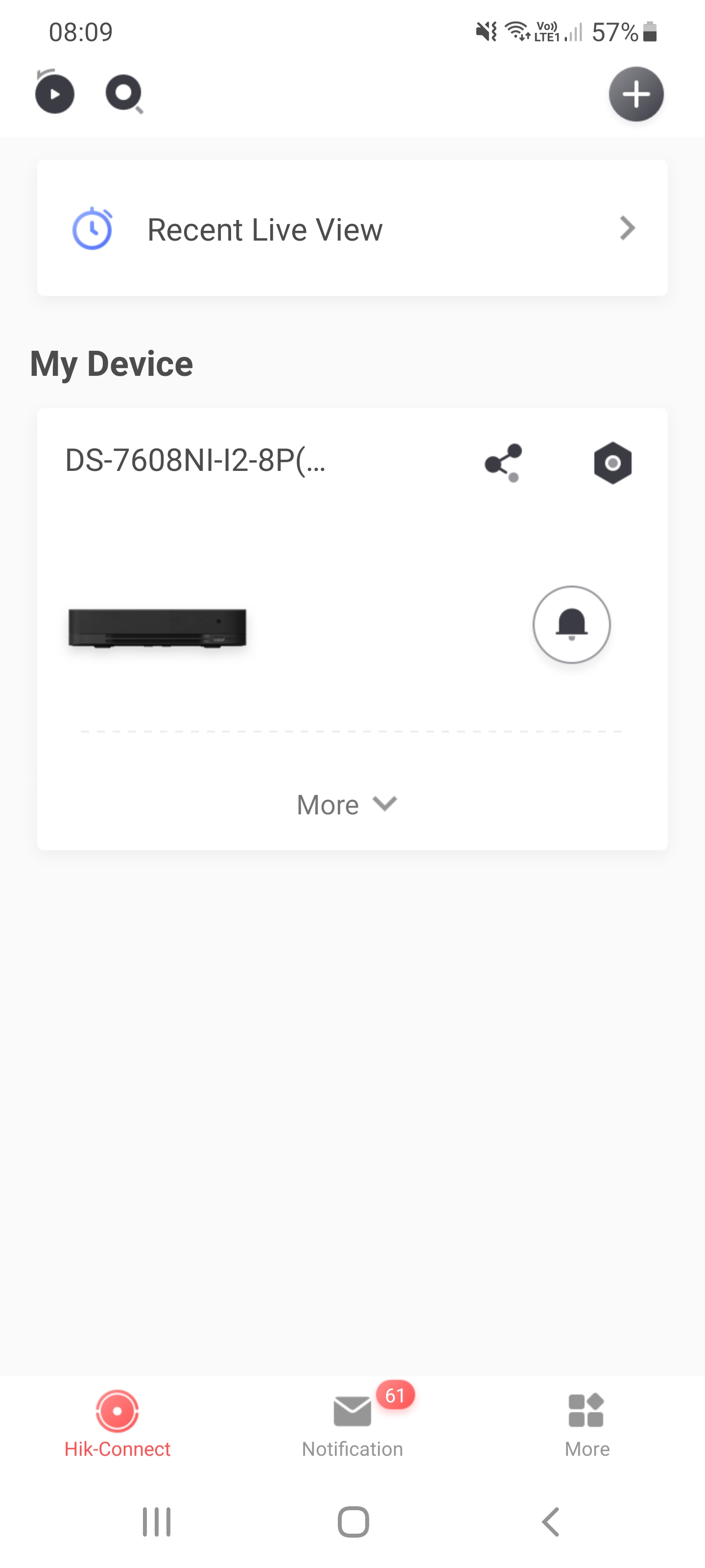

As of this morning I can not playback any cameras via hikconnect. It just keeps error message no more connections allowed.
That's the page I get when I open my app. No rectangular box
Your pic confirms that the NVR is registered to the Hik Connect service and online. Delete your second image as you've exposed your device ID!
