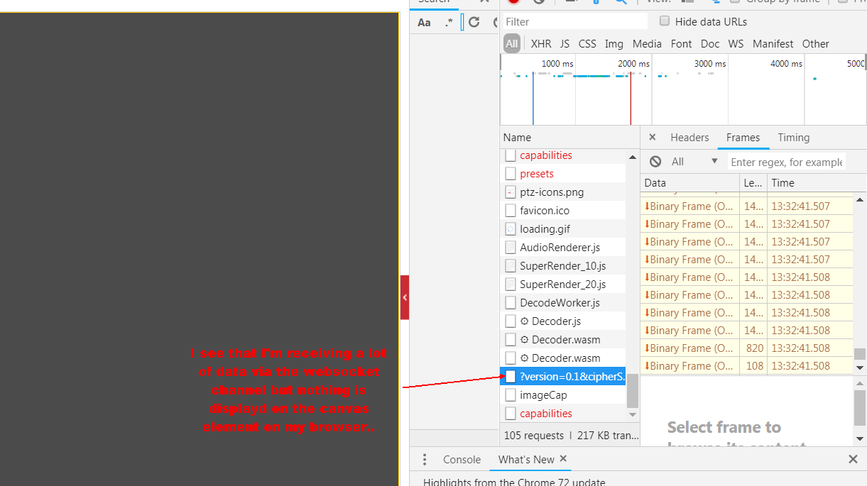

don't know if anyone here has any thoughts on my issue (I've tried fw versions 5.5.80 and 5.5.82). My issue is that I'm not able to get any video input to my browser if webcomponent is selected (see the attatchment). If I switch to MJPEG then I can see the httppreview on the browser (canvas) but I don't want to use this. I've also been having some email conversations with Hikvision EU support about their websocket implementation and how to utilize it but every response what I receive from them is just trying to shuv me towards using a plug-in based solution (in my case that's not an option due to I have to display the camera feed on a QtWebEngine-component which doesn't allow any plug-ins to be installed on it..).
If anyone has any thoughts on this matter or has any inputs on the settings that I should have activated on my IPC then I would be more than happy to see those.

Until they introduce/release new firmware that has generally become known as the 'no plugin' solution I think you are going to struggle to get it working without using Internet Explorer, or the Chrome browser with the IEtabs extension added.
Maybe you could use one of the streaming url options?

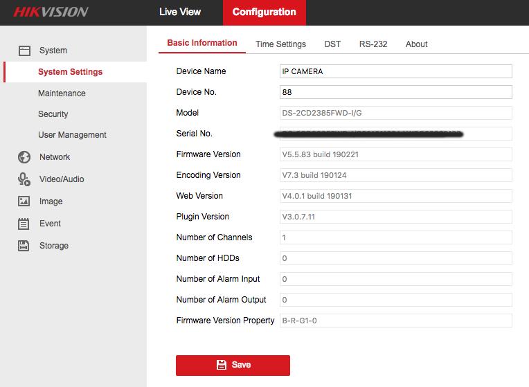

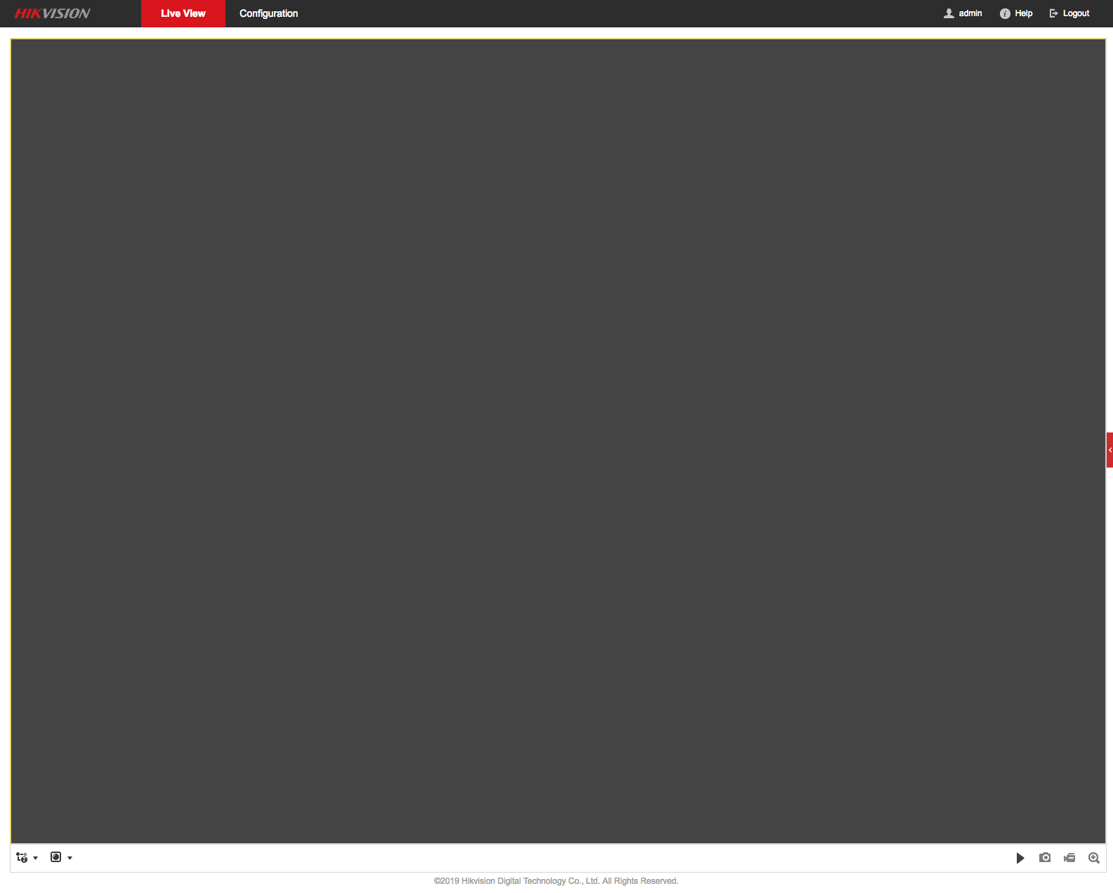

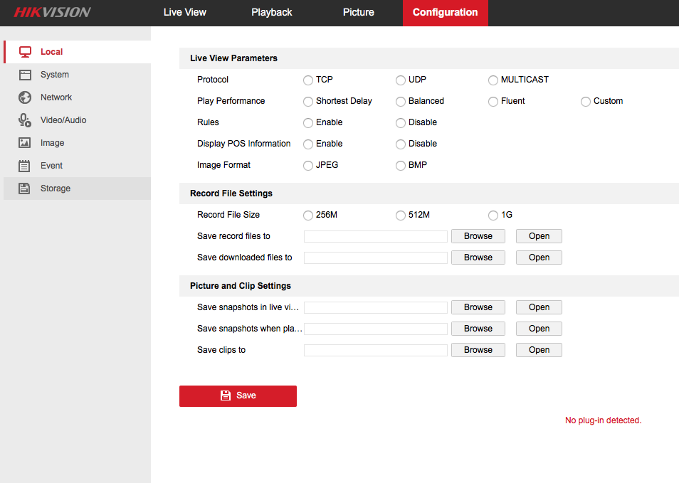

Screen snapshots attached.
Note that Camera Live view image, the 'Playback' & 'Picture' items are missing in top menu!!
Also, in the firmware page, you can see that the 'Local' item is missing from the left hand menu.
If I access it via Safari (Mac), they appear, but the local settings are blank.
Update: Managed to get camera live view working on IE after I physically powered off everything. On the Apple Mac (Sea Monkey) there's still no live view on Camera, but NVR Live view does work!

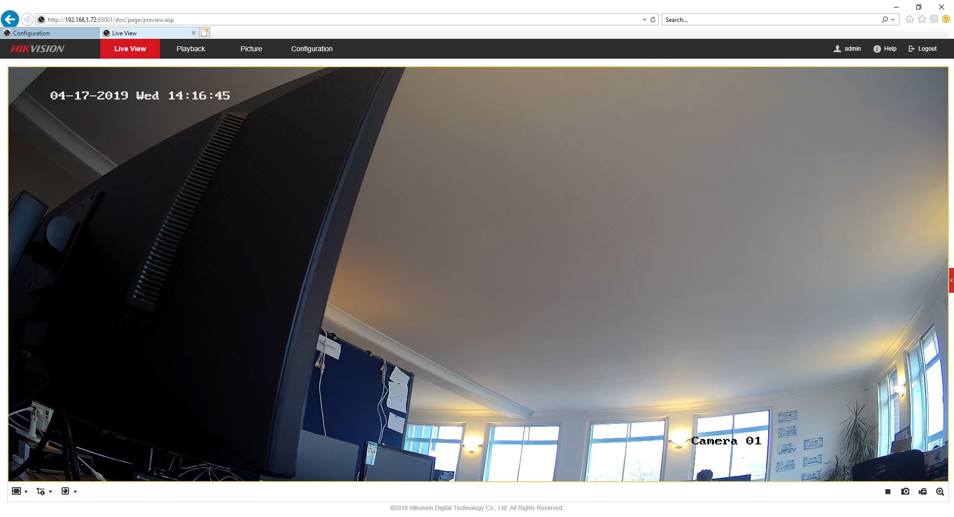

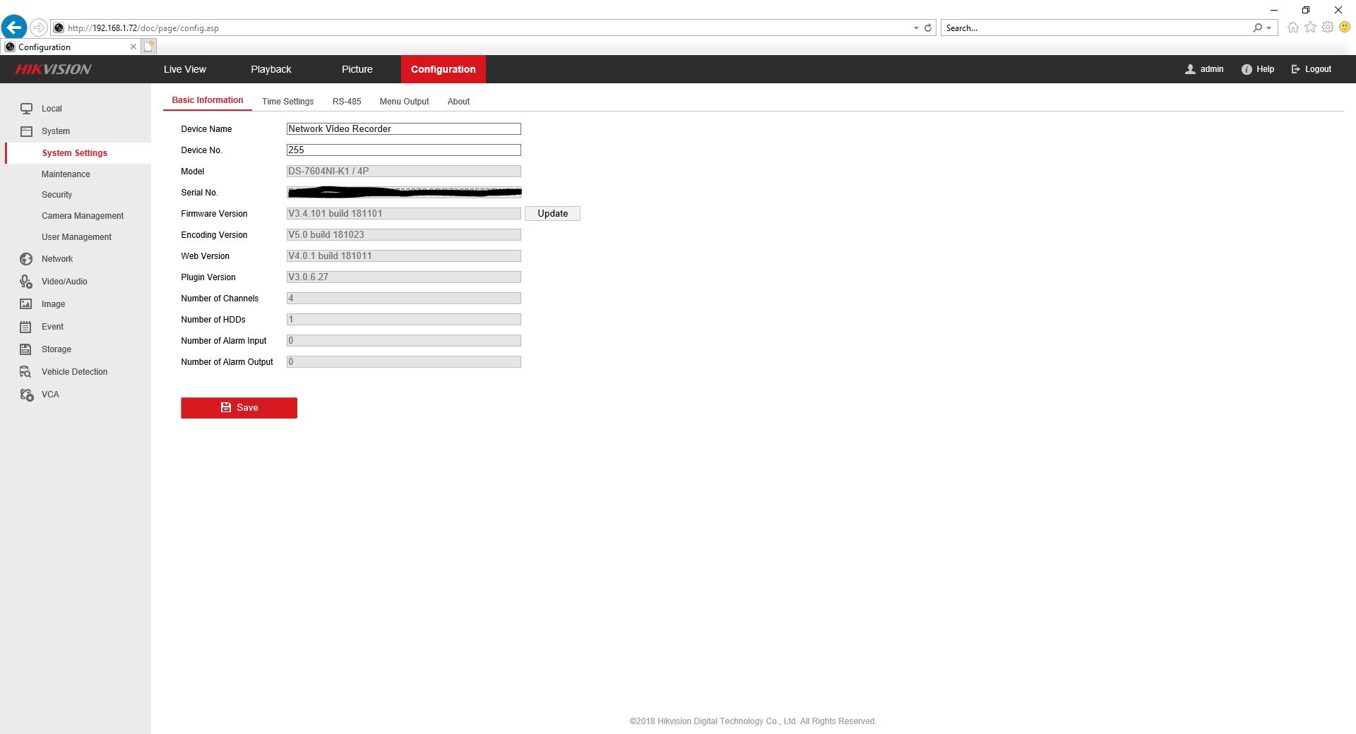

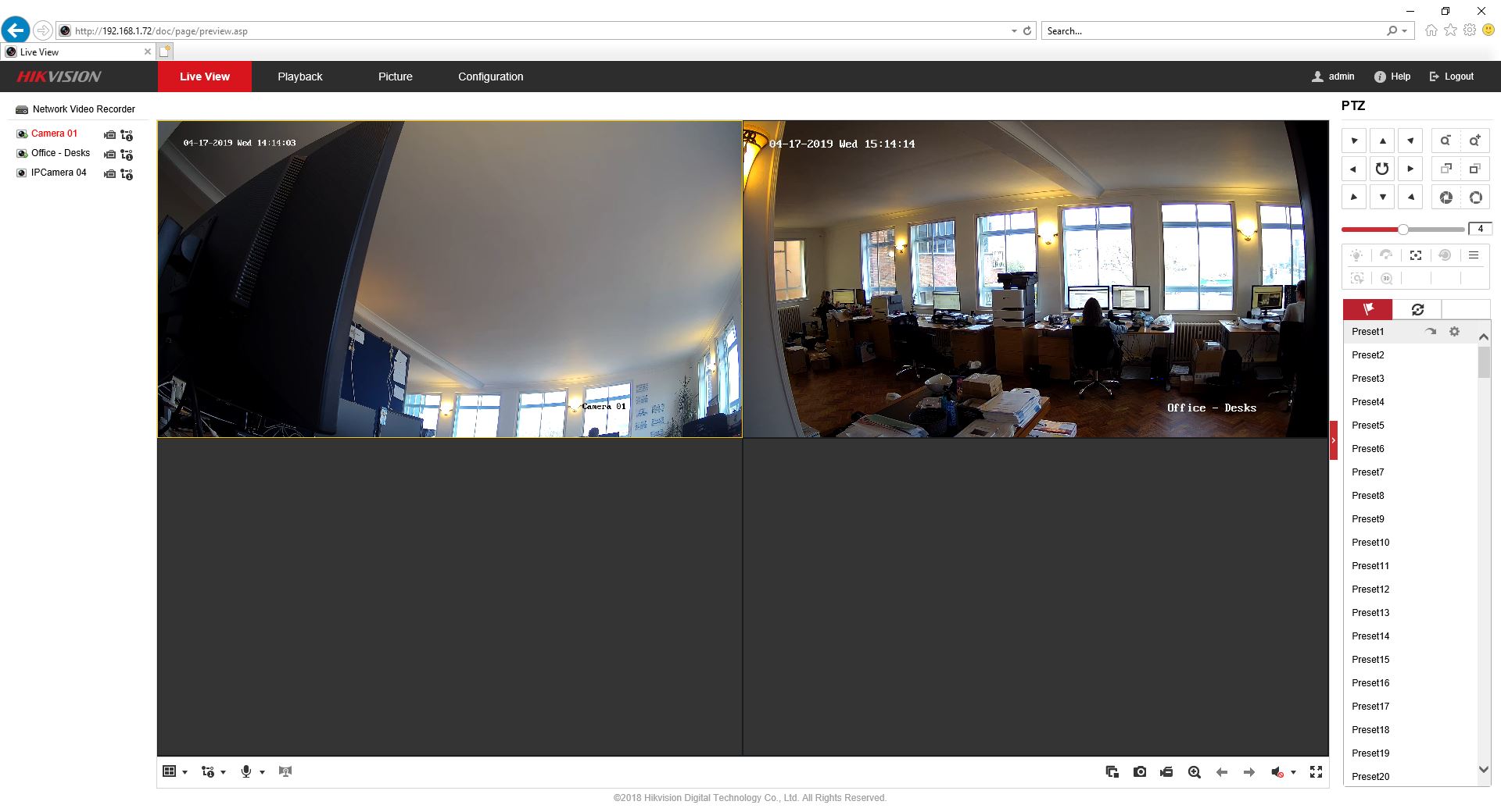

Everything you are seeing is very odd, as you will see from the attached screenshots our 7604-K1/4P is on the .101 firmware [we have also tested a (B) model with .100 firmware] and when accessing with Internet Explorer we could see live view, playback, and all the other menus. Then when I access one camera (2385) with the virtual host I also get live view, playback and again all the other menus, and that camera is also on the 5.5.83 firmware.
As already mentioned above we have tested a non-(B) NVR and that works fine, we have also got a brand new (B) model out of stock and that works fine also. I highly doubt it is anything to do with firmware as the 5.5.82 firmware has been out for months and we have had no other reports like this and if the firmware was going to cause any problems it would be with the older non-(B) model as they are now pretty much EOL.
This makes me think that it has to be something to do with your setup:
- Are you a Mac or PC user, or do you have access to both?
- Are you on the latest version of Internet Explorer 11? (v11.706.17134)
- Have you tried clearing your browser cache data?
