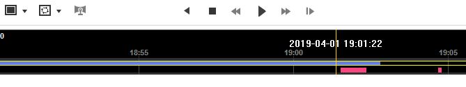

I re-enabled motion detection to make sure it still works....and it does. The pink area in the screenshot below is some motion detection:
1883

But obviously you still need to be able to see when line crossing has been triggered in the playback timeline, it was this part that was annoyingly simple, you were correct in selecting the line crossing detection button in the bottom left but what is not so obvious is that after you have clicked this button you then need to click 2 points on the playback image to draw the line where you want the crossing data from (see in our example image below we just put the yellow line over the existing line crossing line) and it will then highlight in pink in the timeline all the times someting large enough crossed that line you have just drawn.
2022
