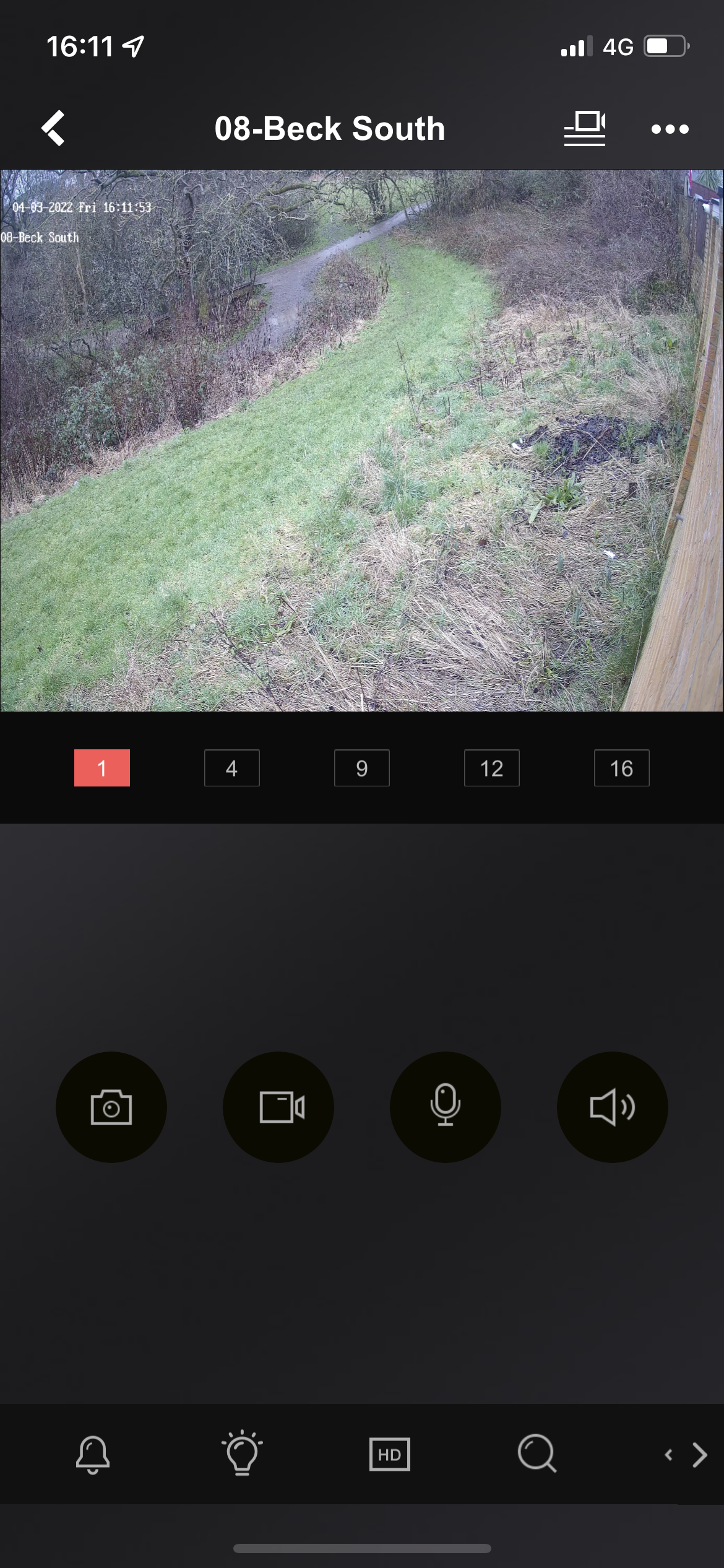

Is there a 2nd manual alarm icon? What does that look like? I guess I am only seeing the 1 that does the nvr output. Hopefully that's due to the firmware.

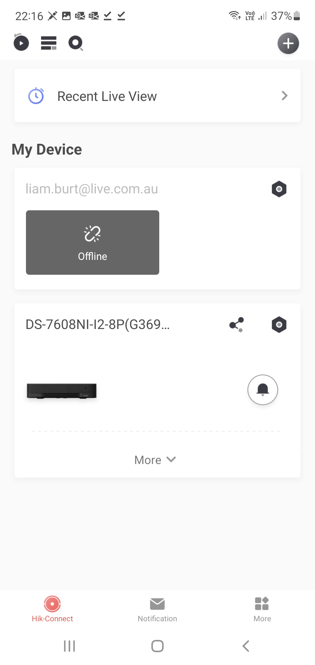

See image, I only have the solid alarm bell icon, but also should the bell with lights also be showing.

When connected to a compatible camera with siren/strobe light (ISU/SL or LSU/SL) you’ll get two additional icons on the toolbar below the picture. They’ll appear at the left hand side of the toolbar (you need to scroll the toolbar to the right hand end to get the one that fires the alarm output) See mine below for the two far left icons:

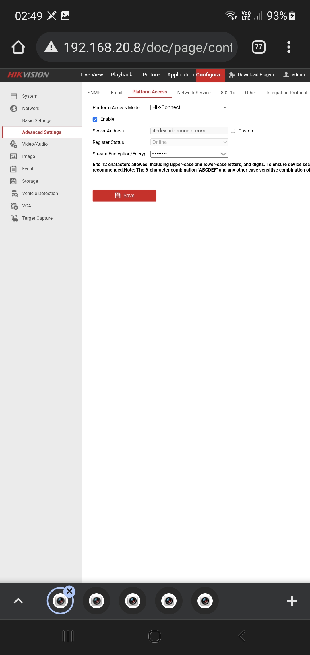

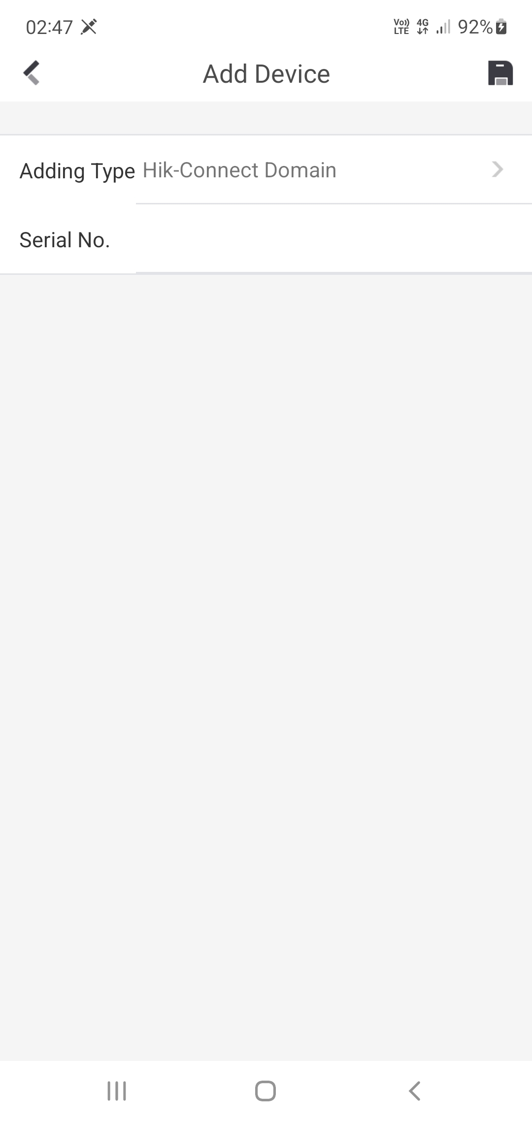

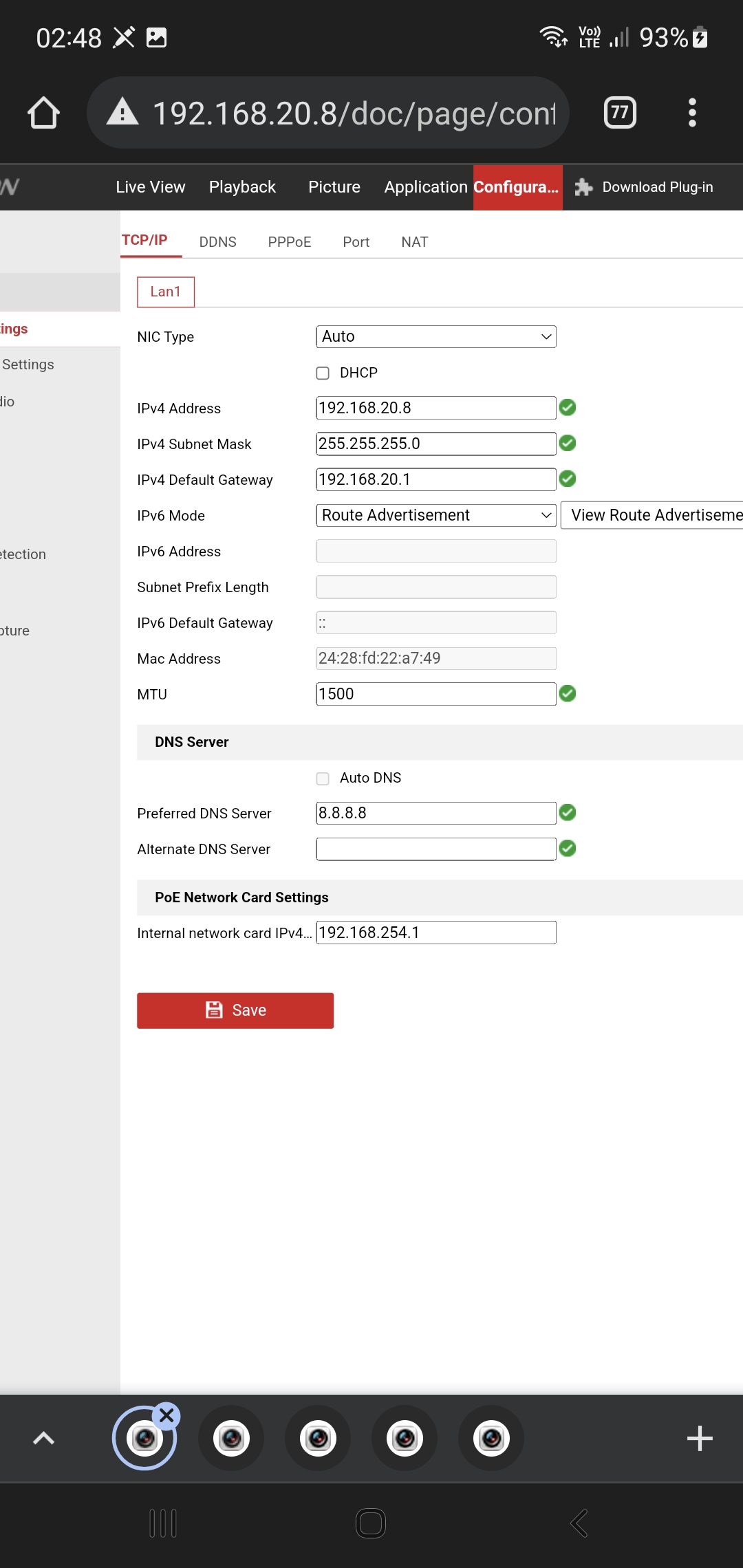

I take it you are connected to your NVR using the Hik Connect service (NVR is linked and online in platform access)? Some functions are only available when the NVR is registered with HikConnect and bot available when connected directly using IP address
I ticked the check box in NVR gui.
There was an issue where it was off-line, and I have to add 8.8.8.8 in the port settings, then I added the NVR as a device using its serial number

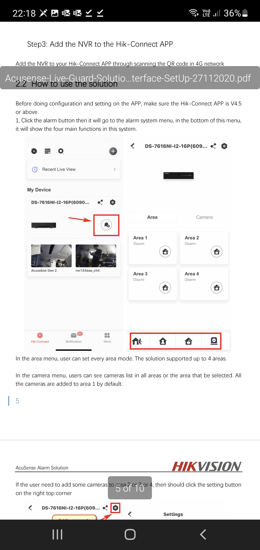

I've also had a look at a post about the firmware update. They mention the one touch button to mute notifications. With that 'new' button, where would I expect to access the page where you arm the areas and open the camera details.
The old button was a bell with a hexagon/cog. Now it's a plain bell.
My current screen can't open areas/partition to arm
Old screen (screenshot from a how to file, that looks similar)

I've got the bell icon next to the device in the home page where I can enable/disable notifications for that device and I still have the icon to get to the settings for the device. I've never seen that screen before with the areas/partitions.

Do you have a way to choose the armed state. Like
Away - all smart events armed for all cameras
Stay - only some of the cameras armed (and which ones are bypassed) ie: when I am home, I still have the front line crossing armed, but not the ones in the back yard.
My button to get to there was where the notification bell icon is.
The other buttons open the settings for the NVR
