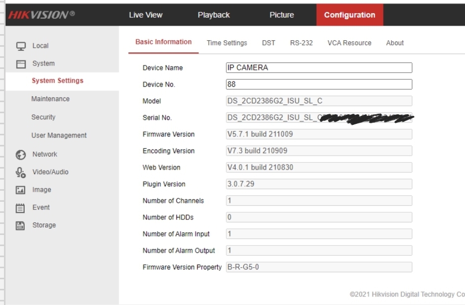

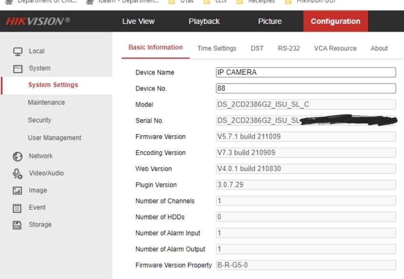

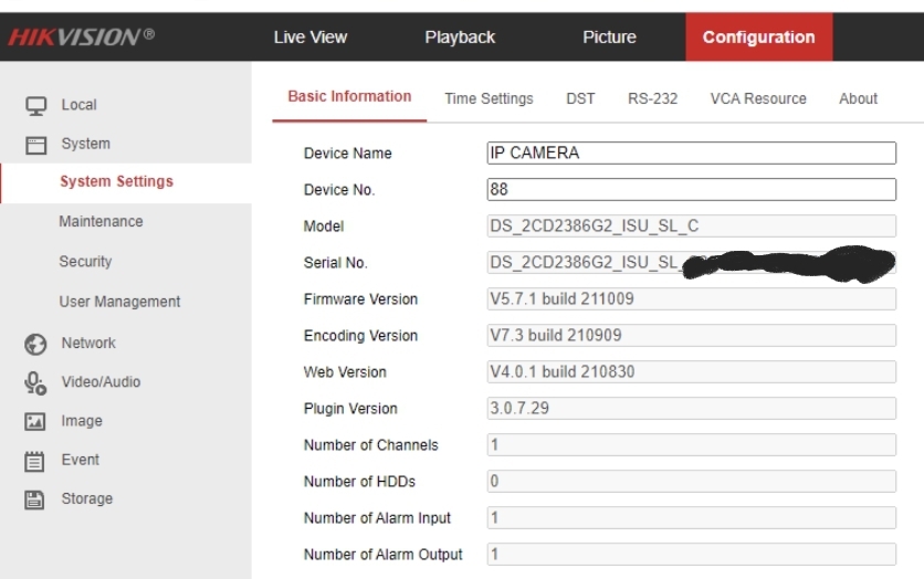

Hi All
I am using hik connect on an Android phone. I wanted to be able to manually trigger the siren/strobe
I have just tried the firmware update, for cameras and NVR.
Now, I can't arm the system (away, stay, home etc). Pressing the bell icon just turns notification on/off. So it can't arm the smart events. I also can't open the "area' or individual cameras.
Now there is is a bell icon when using live view, to manualy trigger the alarm, but it doesn't work, and openes up another menu.
More details in attached images. Stopped updating the cameras firmwarw when I ran into the problems.
This is a link to screen recording.

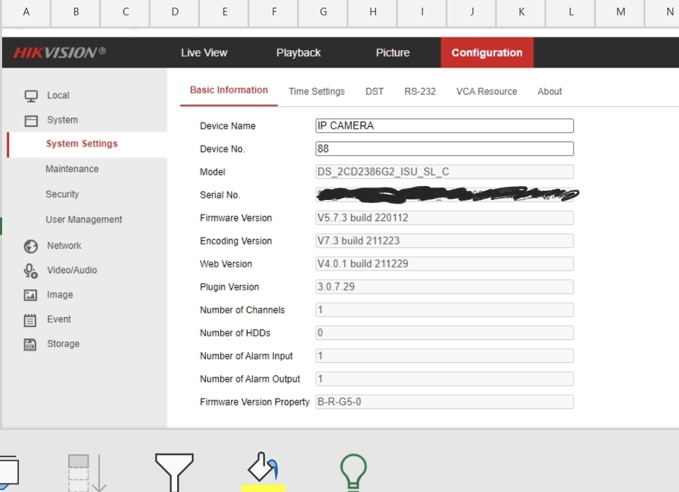

I have got this model camera.
Model: DS_2CD2386G2_ISU_SL_C
Firmware at installation: v5.7.1 build 221009
Updated firmware to: v5.7.3 build 220112

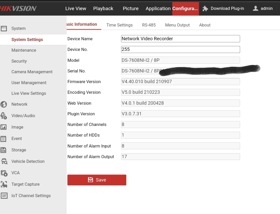

Currently connected to NVR which is
Model: DS-7608NI-I2 / 8P
Firmware at installation: v4.40.010 build 210907
Firmware updated to: v4.40.017 build 220126

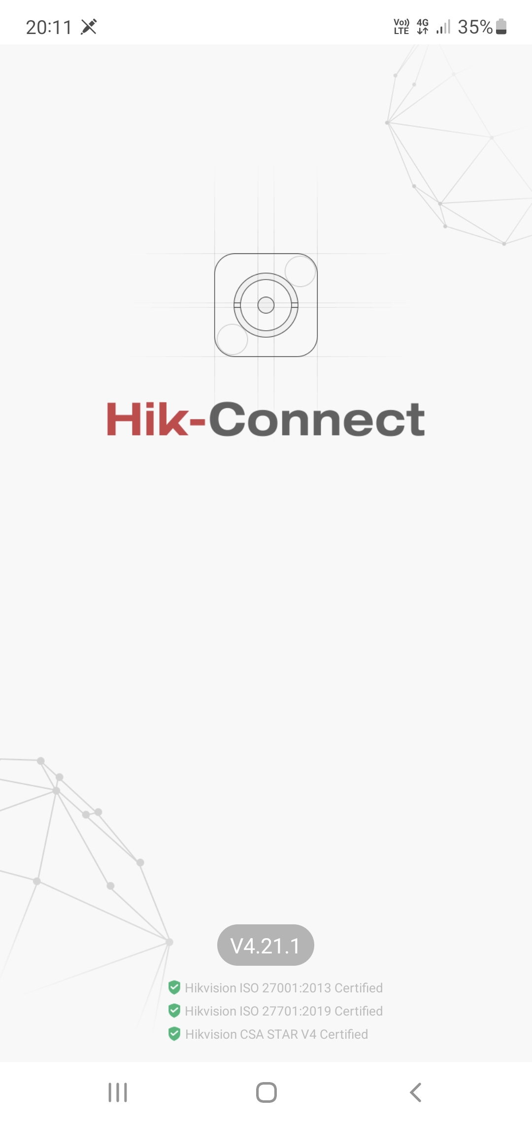

I also note there has been a recent app update, but I believe that I updated the app prior to any of these issues.
Does anyone have a screenshot screen record of video of what this should be like?
Another issue is there's no audio on playback. It works on live view. I have audio and video selected in settings.
Any help much appreciated.

Hi All

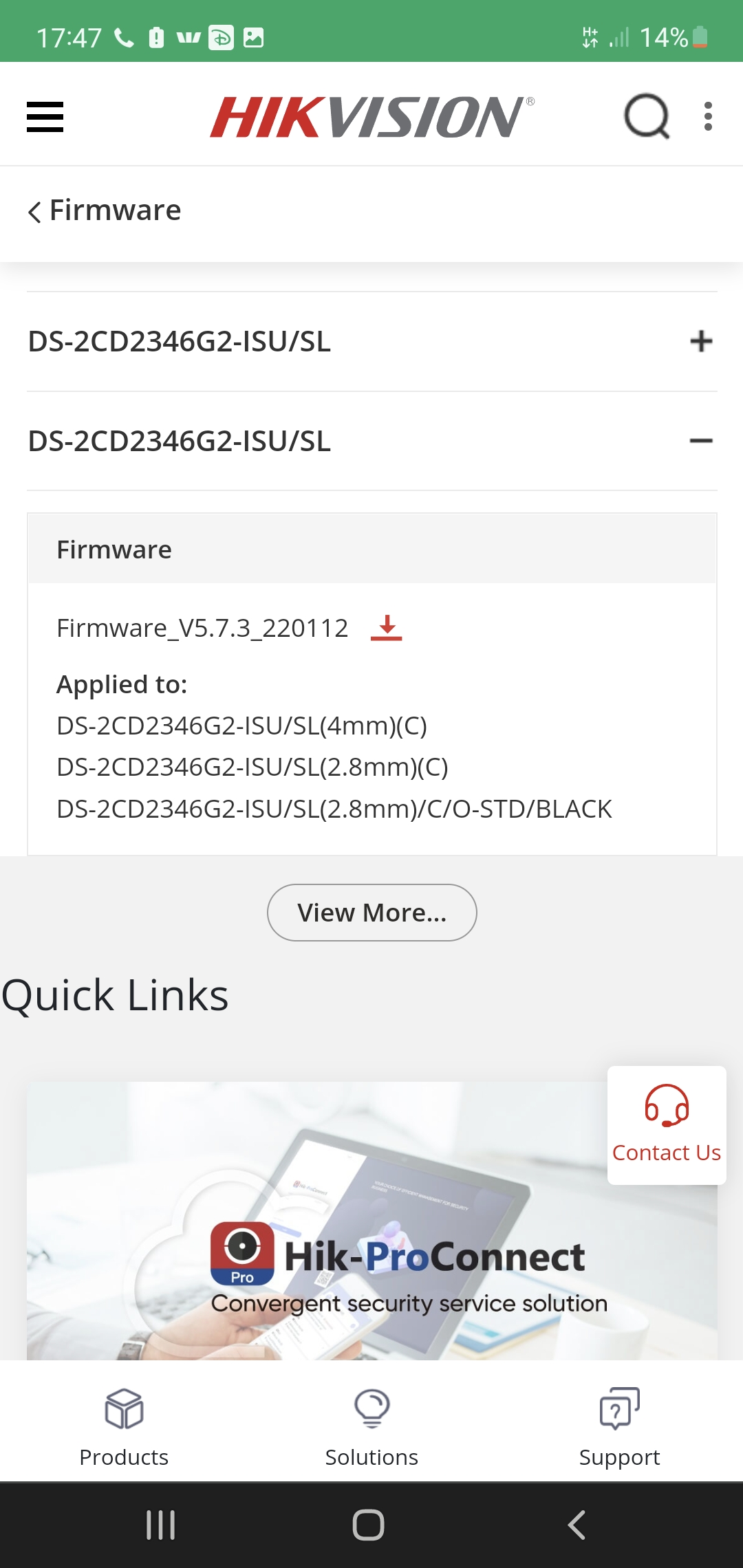

Here Firmware , how would you decipher which is most recent?
Images attached

Hi.
An updated
I have upgraded firmware for all 4 cameras, to v5.7.3
I still can't arm the system, and am not sure that the manual alarm icon is doing anything. usually the top right "bell icon" opens the page where I choose the armed state (away, stay etc), and can go from there to more of the camera settings, like the flashing light.
See screen capture New video by Liam Burt
when in live view, and I click the "alarm" icon, and then toggle the "Alarm output 01", it actually actuates the relay in the NVR, so it's making the NVR output close circuit. - theoretically, I could use that and wire the NVR output to one of the NVR inputs, and then link that to the cameras light/sound. But this doesn't seem right either?
Hi.
An updated

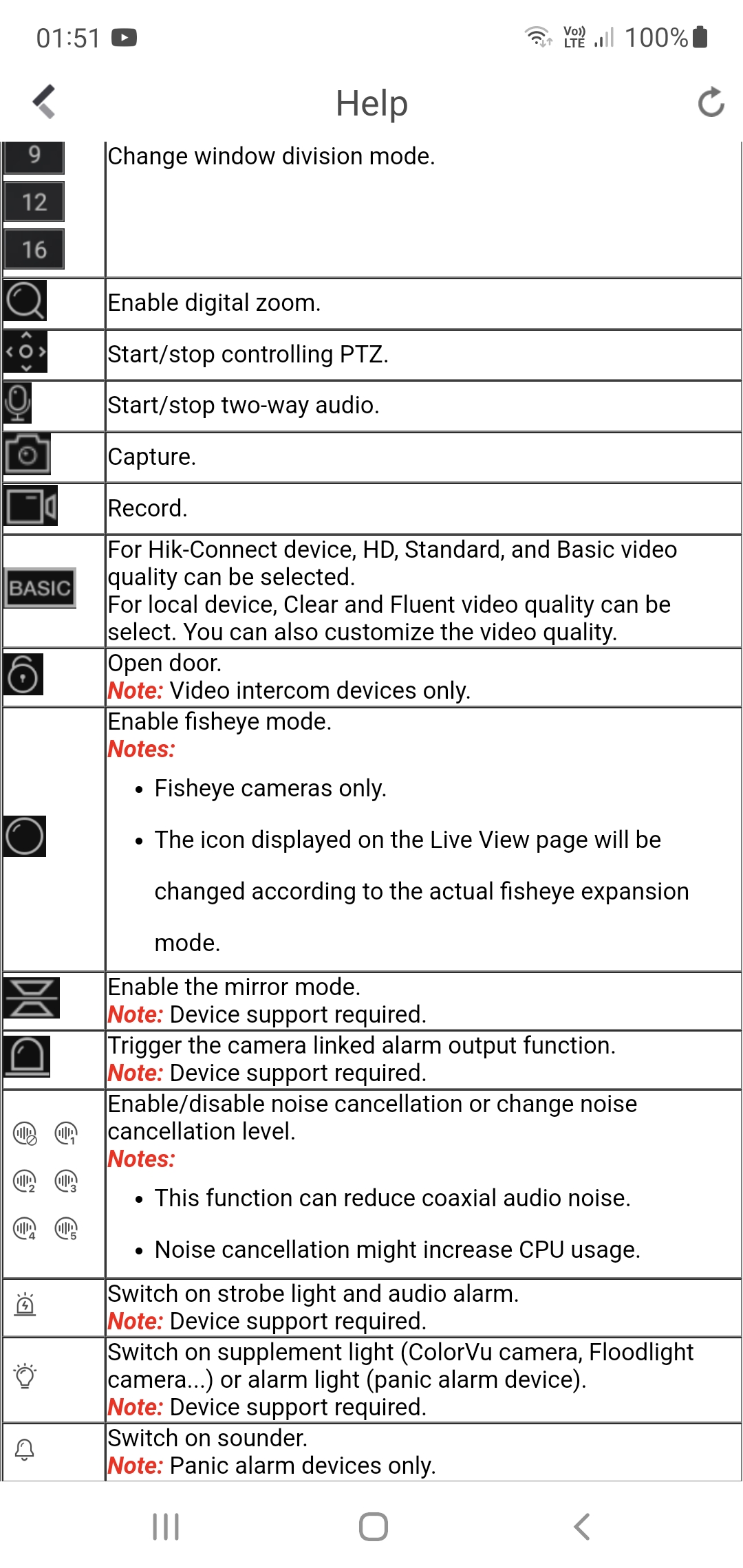

Just to clarify, the 2 manual alarm icons for sounder and light will just trigger them on the camera. That is, you see something suspicious maybe and can fire off the siren or flash the light. It’s manual and so disconnected from the alarms operation.
Your last statement regarding the alarm output is correct. That’s to manually trigger the NVR output. I use that to trigger some security lights.
Firmware builds. Usually any change results in a new dot revision, but occasionally, as in this case, a new revision of 5.7.3 was released to deal with the issues you’re seeing. The build is just yymmdd so the newer the better. It looks as though the newest “fixed” version has not filtered through to the AU site yet.

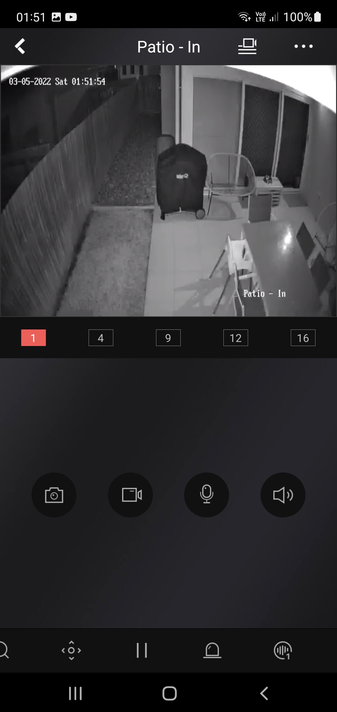

Is there a 2nd manual alarm icon? What does that look like? I guess I am only seeing the 1 that does the nvr output. Hopefully that's due to the firmware.
So now, maybe best to contact hikvision support?
Any chance anyone has screenshots or screen recording of how it should look/behave. That could help convince hikvision to help.
See image, I only have the solid alarm bell icon, but also should the bell with lights also be showing.
Again, thanks for all your help.
