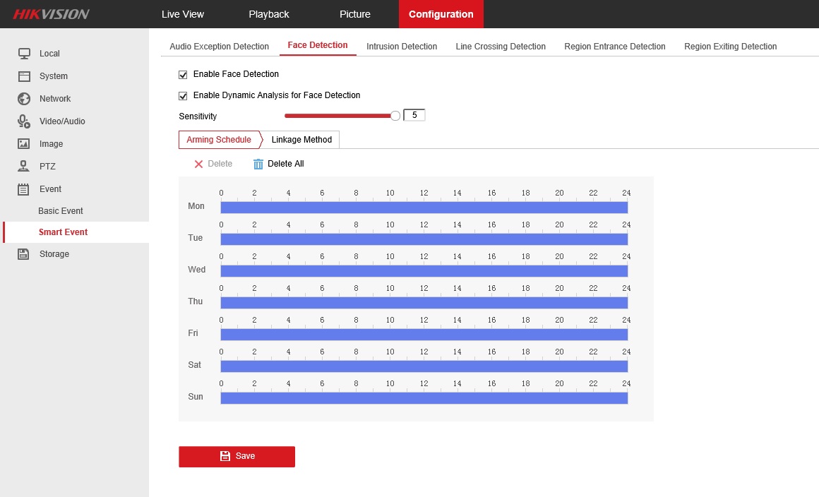

I have this, Weather it is Disabled or Enabled seems to make no difference and the NVR ignore any events or Captures. Im not a professional but i love to learn.
I set up my PTZ via Intrusion, So i get less Fake Auto tracking alerts on bushes and leaves ect. only thing i changed.

In Smart Analysis i see facial Detection it is enabled with Save VCA picture ticked.
In Perimeter protection i only have
Line cross, Intrusion, Region Entrance and Region Exiting
Is this normal ?
When i try to set it up in VCA on the NVR..
I get the Message that this camera don't support Face Detection. So maybe data sheet is wrong.
