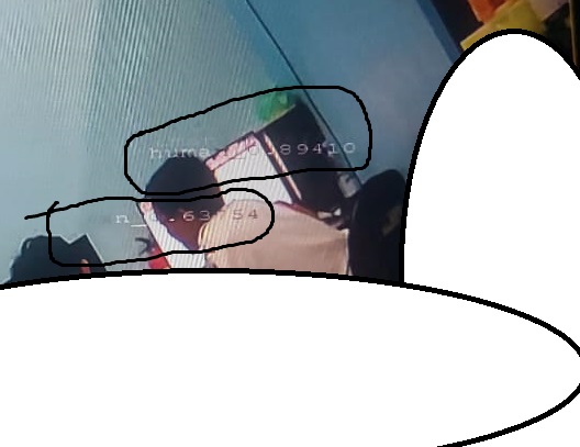

How can i get that label (human_numeric or human_coordinates) by using ISAPI hikvision or another tools?
gandul
I use a Hikvision IP camera and DVR which supports human detection. When a human is there, the live streamer DVR automatically displays label (human_numeric or human coordinates). I need coordinates or that human data by using ISAPI. How can i get that label (human_numeric or human_coordinates) by using ISAPI hikvision or another tools?
You cant get this exact labels with ISAPI, it is an SDK function which isnt made into ISAPI yet.
But you can run alertStream where you will get image + trigger coordinates in XML/JSON part of a multipartdata response.
Or run HTTP Listener server service and then push that events there. The data you receive it will be the same.
Sadly under XML there still isnt any information regarding detection source aka if its Human/Vehicle or something else. You only have coordinates of a trigger.
or you know just use SDK :P
