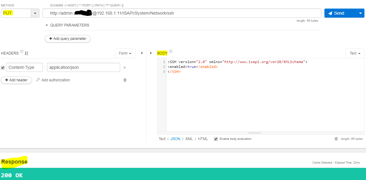

If you don't come right, you can use RClient or cURL to enable it. Let me know if you need help doing so.
Load the Restlet Client for Chrome I linked to above.
Skip the sign in when prompted.
Method must be PUT
URL: http://admin:xxxx@192.168.1.xx/ISAPI/System/Network/ssh
Body:
<SSH version="2.0" xmlns="http://www.isapi.org/ver20/XMLSchema">
<enabled>true</enabled>
</SSH>

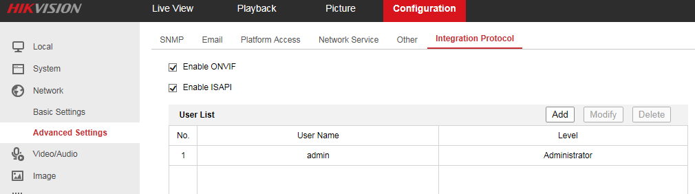

Check under Integration Protocol, do you have a admin level account?

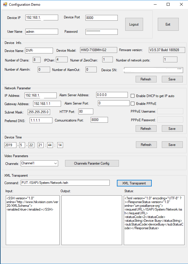

Strange. The 401 error might be related to the previous session and it expiring on reboot. The only other way I can think of is trying via the Hikvision SDK. You could download the SDK and compile the Remote Configuration project in Visual Studio (a chore if you don't have VS installed) or I could compile the project and post the application. Still no guarantee it will work...

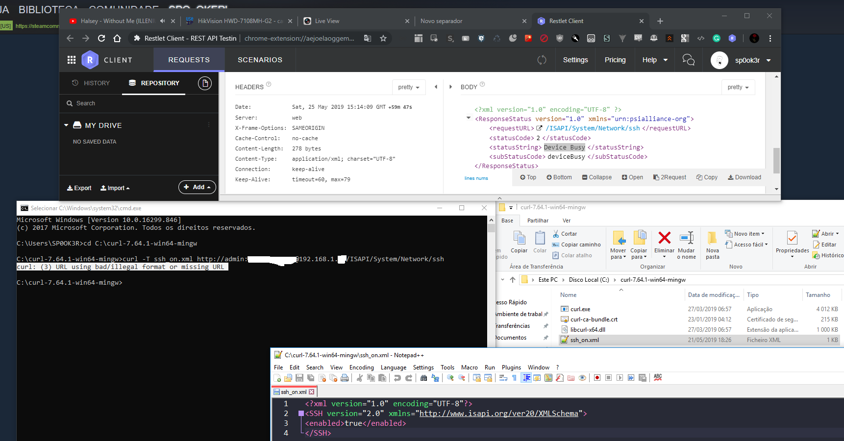

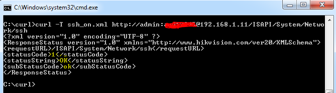

Back to curl...
Check you have WEB Authentication set to digest/basic. Then run the command again.
