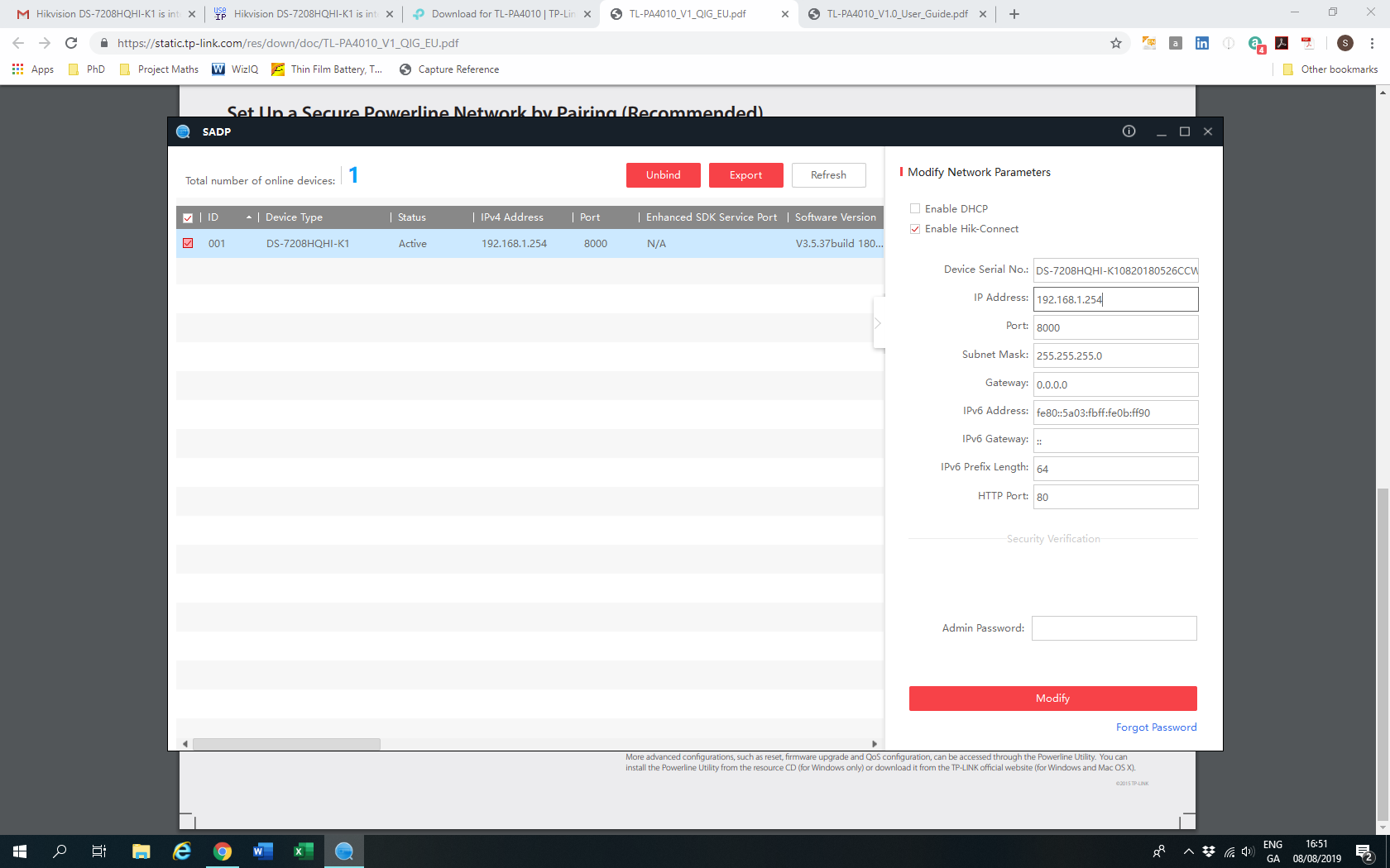

hi phil, i ran sadp tool on my laptop, no npf issues this time but the SADP page is empty, showing no online devices

Because your DVR is not currently connected to your network.
Therefore, SADP is unable to find it.
You need to get the Powerline pair working again.

That did the trick. My device is back online on my app. thanks so much for your troubleshooting help. I hope the rest of you with 'device offline' get a resolution.
