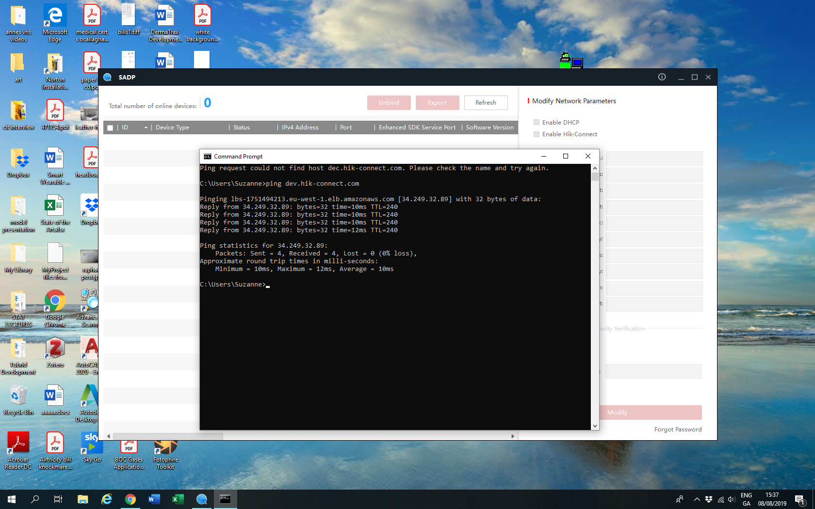

When i installed the sadptool, it reported an error: failed to install the npf service. I dont know what that is
Nor do I.

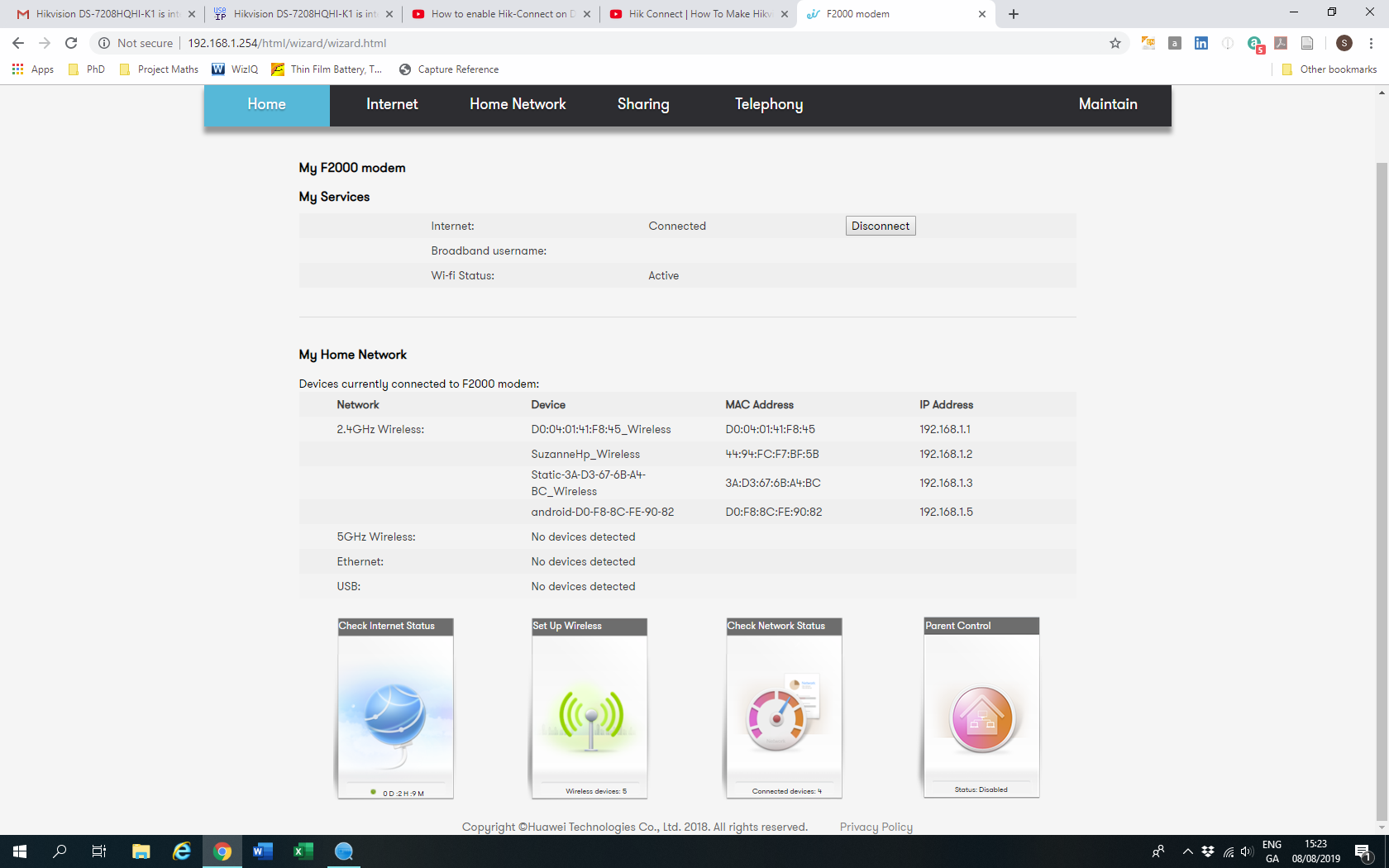

Can you login to your router and see the DHCP assignment?
See what IP address your router has issued to your DVR.

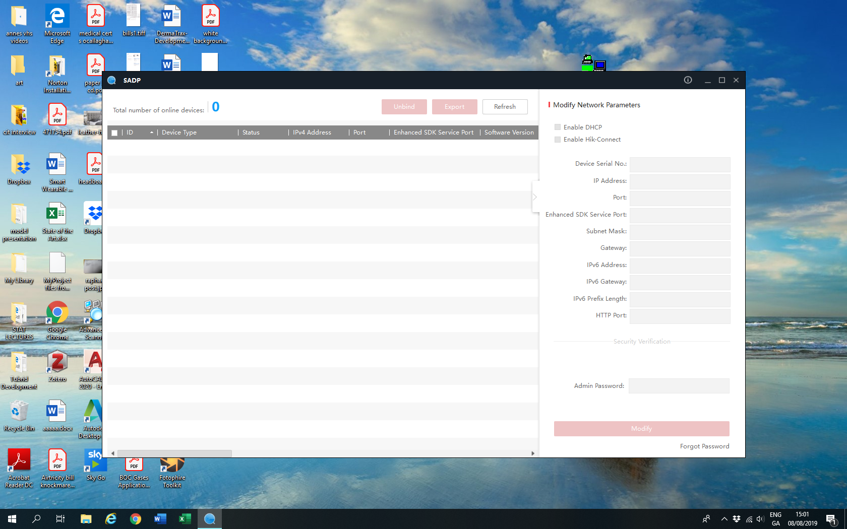

Your NVR is not listed.
The list shows no devices in the Ethernet section.
Only x4 wireless devices.

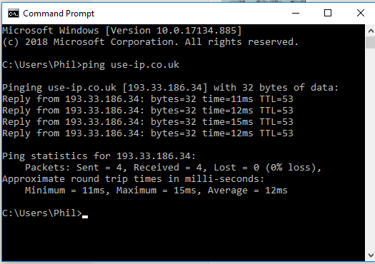

You have only pinged their web portal.
Same as pinging our website/server:

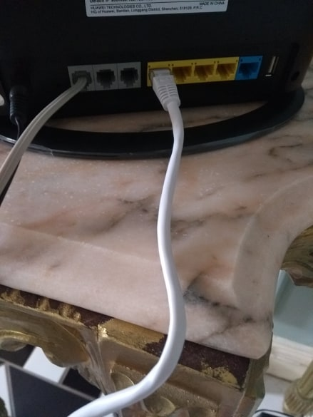

just checked and there is only one LAN connection to my router which is plugged in to a tp-link, which also powers the router. DVR is located in the attic. dont know how they could have connected it other than wirelessly? There is a wired connection into the back of the tv, hdmi, i think

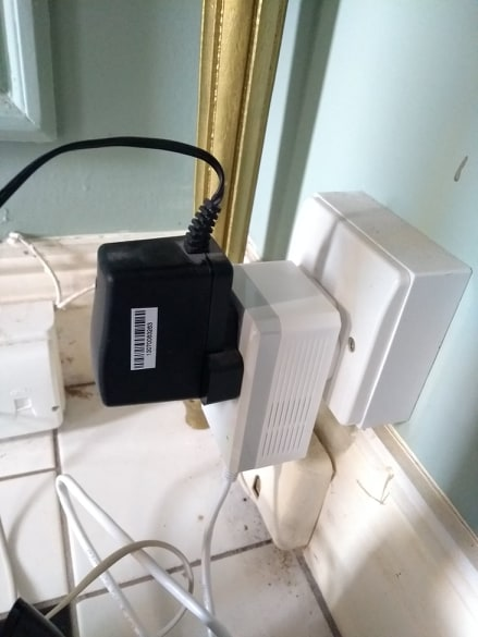

The 'TP-Link' may be a Powerline device, which uses your mains cabling as a network connection.
You may have another similar adjacent to the DVR in the loft.
Check the model code of the TP-Link, to see what it is / does.
wow, ure right phil, it transmit data through shared power line. didnt even know it existed. Im installing sadp on another pc to see if we can get dvr data
