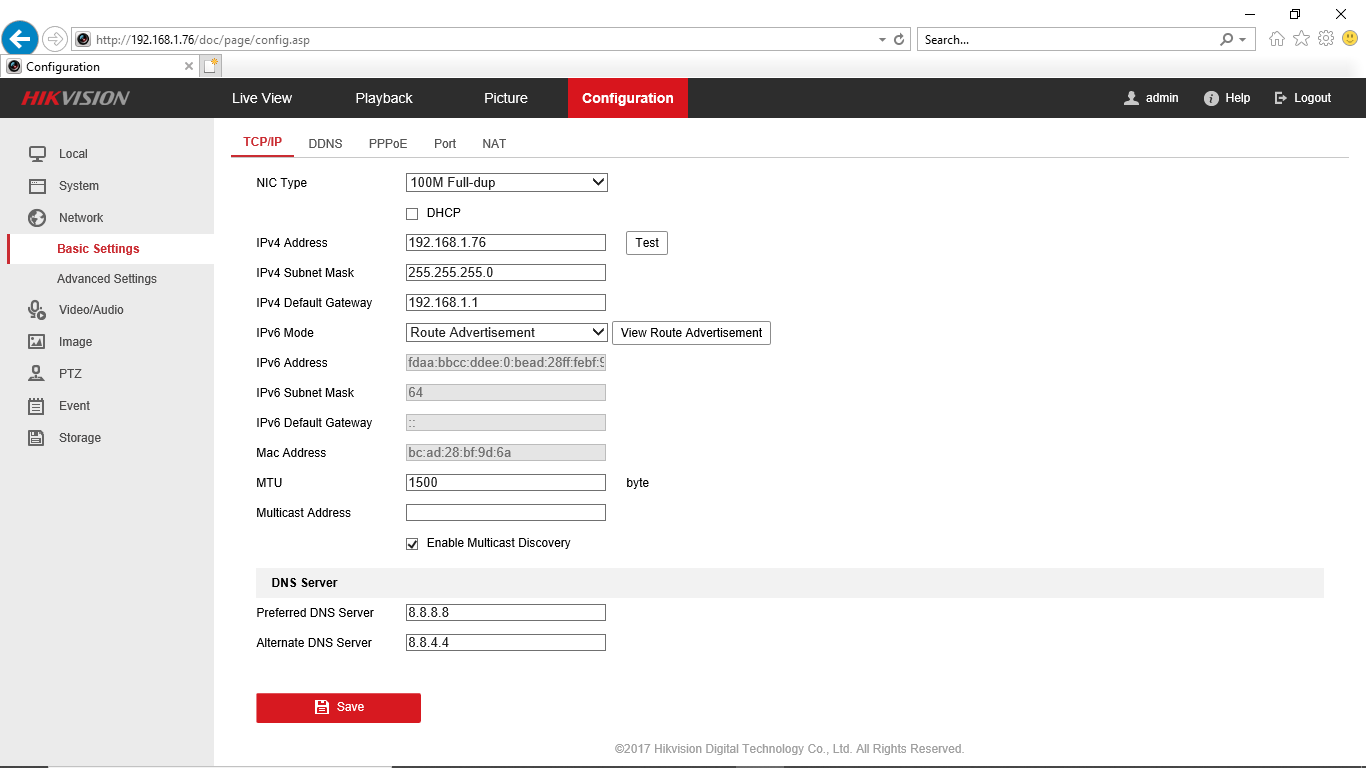

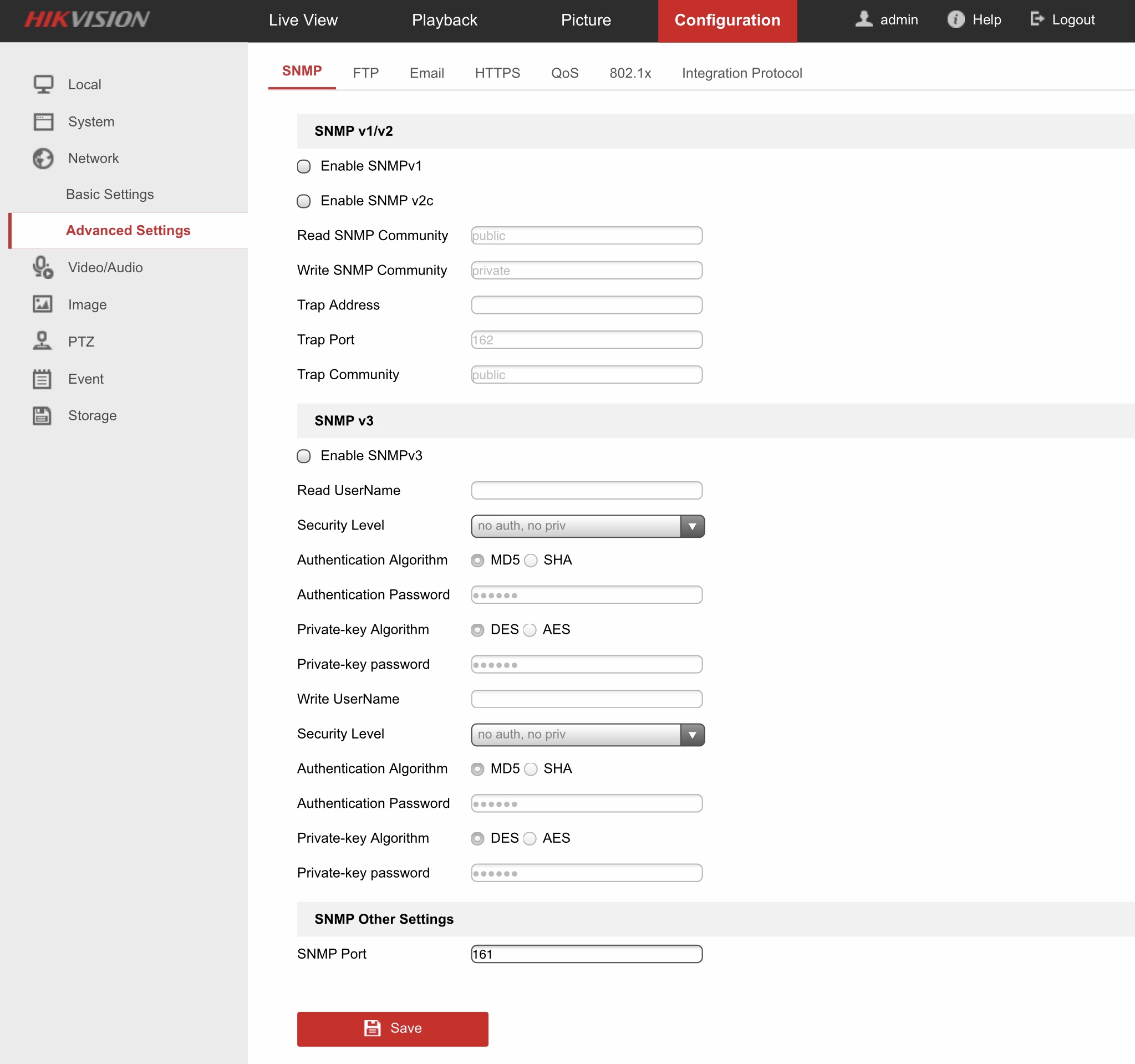

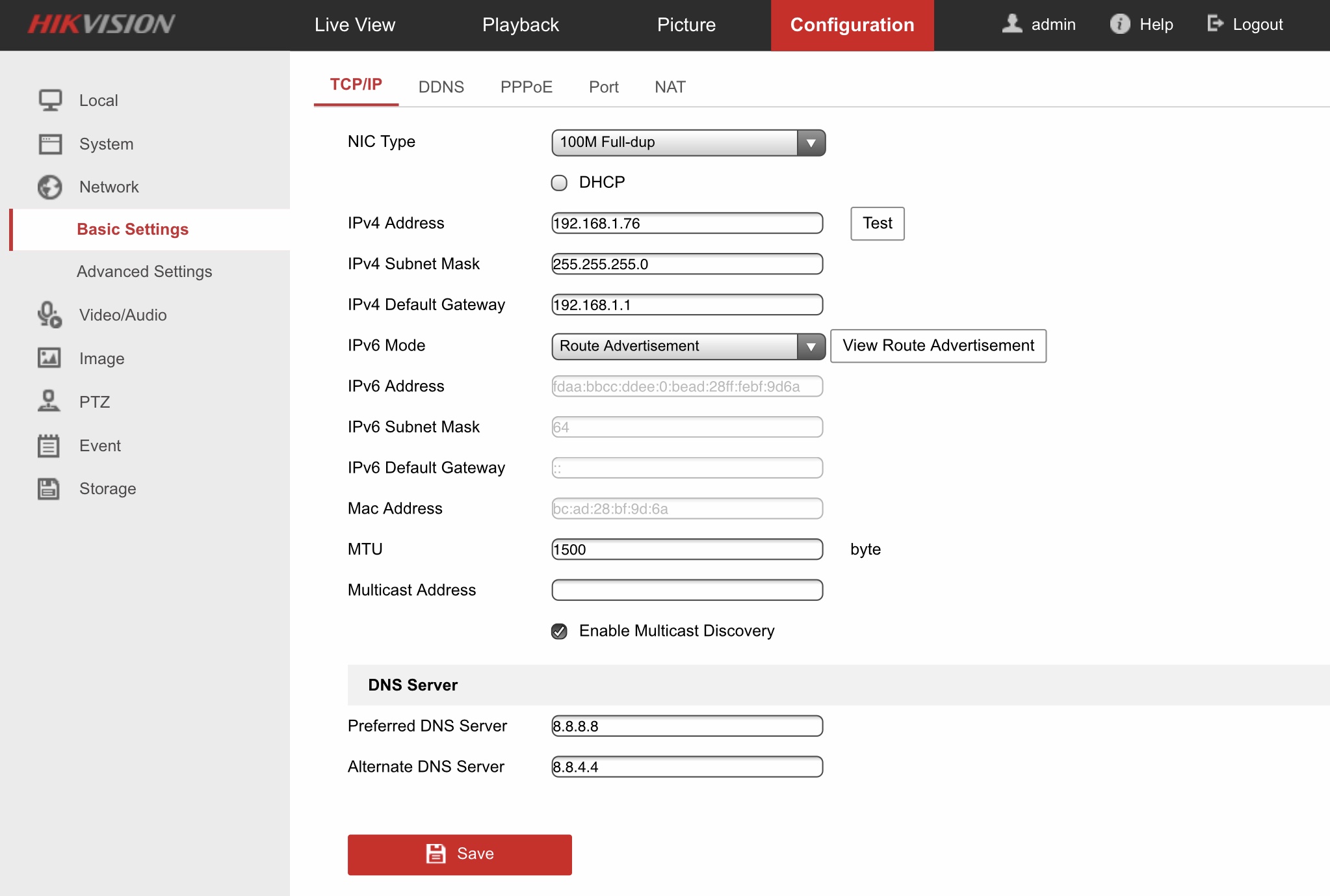

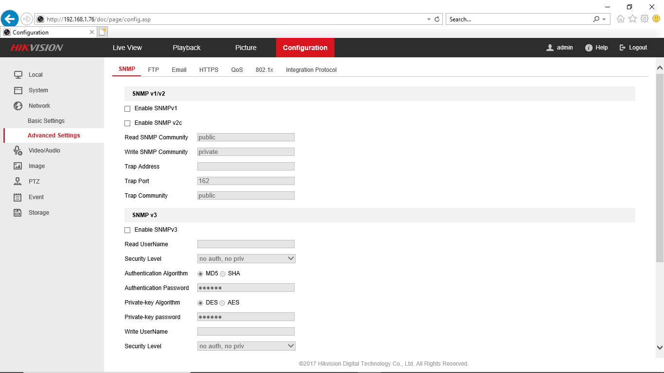

I have uploaded a number of screenshots showing the cameras basic settings and the network basic and advanced settings.

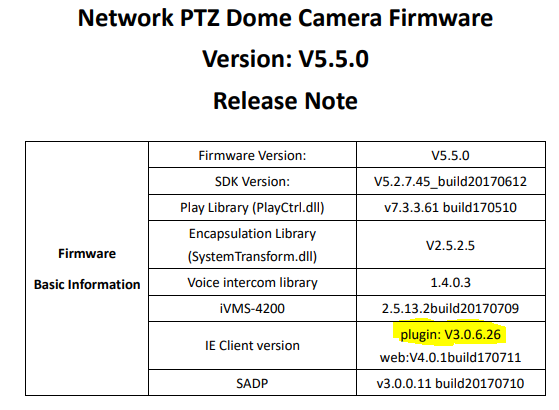

Your PTZ is listed as R3 series. The attached v5.5.0 release notes mention hik-connect functionality. The DS-2DF7286-AEL is listed on page 11. Maybe a lead.

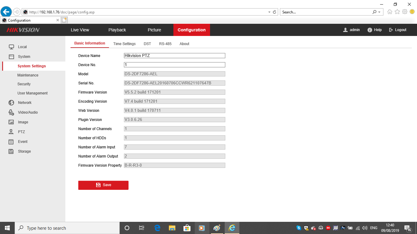

Are you able to get it back on the latest UK firmware and send us a full screenshot - of your browser, when logged-in to your camera please?
Hi Phil,
Thanks for your message.
I have downgraded the firmware to the UK version 5.5.2
After installing the UK firmware I deleted the Internet Explorer cache and then used CCleaner to remove all IE Information, except passwords.

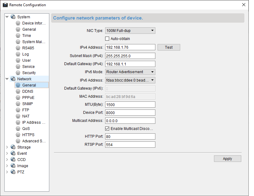

Please see the various full screenshots below, including one from iVMS

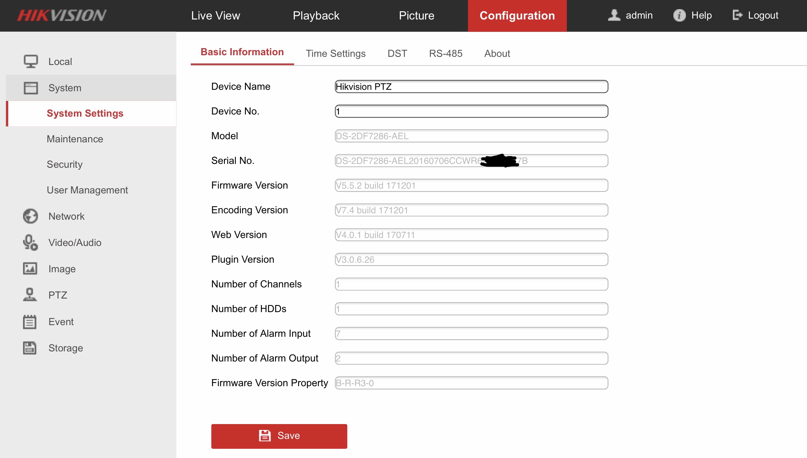

I'm stumped.
I can see that you are logged-in as admin.
You have the latest firmware.
Confirmed at the UK portal - HIKVISION UK PORTAL
And at the EU portal - DOWNLOAD EU PORTAL
The Release Notes at the EU portal confirm the firmware is for your camera model.
@StewartM (and you) spotted confirmation of Platform Access in the previous firmware version.

Your web-plugin 'might' be the issue. It's quite an old version. I'm not aware of a repository for the various versions of Webcomponents.exe plugin but I've attached v3.0.6.46, a much more recent version than you have installed. The release notes for v5.5.0 firmware leads me to think this might be the issue.
2511
Uninstall your current version of WebComponents.exe from Windows>Programs and Features. Make sure all your browsers are closed and then run the file as admin (right click the executable for the menu option). Only use IE11, it's still available in Windows 10, and allow it permission to run always if prompted. Chrome and FF won't support this version of the plugin fully. Also, I wouldn't go any higher than v3.0.6.46 of WebComponents in case you run into compatibility issues.

I see your version is current, missed that. Enable ONVIF, Network>Advanced Settings>Integration Protocol. It might be possible to activate it via ISAPI. You'll need the Restlet Client plugin for Chrome loaded to proceed.

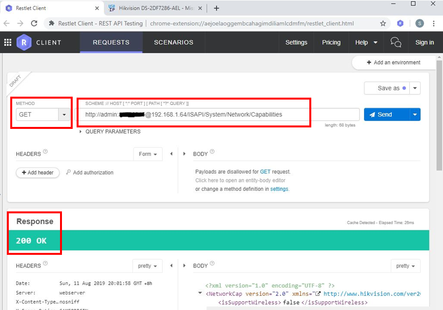

The Restlet client is to send commands via HTTP requests. There is a possibility that you can activate Platform Access and setup a user even if the option is not visible. I'll put the steps together in a walk-through this afternoon.
Enable CGI in Integration Protocol in the meantime too. I see you have already created a user called admin. To keep things simple make sure you set the user password to the same password you set for the camera (if you had not already).

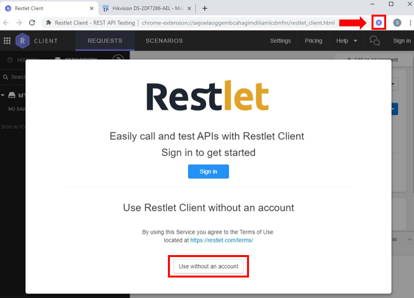

Using the Restlet client:
Open Chrome. If the Restlet extension is installed you should see an icon at the end of the address bar. Click it. Once loaded, click 'Use without an account' on the splash screen.
2520
Next we need to test the camera will accept HTTP requests. Amend and paste the following into the address field:
Method must be set to GET. After you have pasted the address, click the Send button.
Hopefully you will receive a Response 200 OK.
Before we continue, let me know the result.
2521
