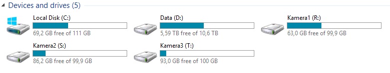

I got three identical cameras (DS-2DE3304W-DE), the same settings on main stream, but when they record to my server (NAS) one of them takes a lot mot space, than the other two. Anyone know why?
As you can see in the screenshots, disk R, S and T is where i store the recordings. I started these yesterday, almost at the same time.
And the other screenshot shows the video setting on the main stream, that are beeing recorded.

Are you absolutely sure the settings are the same?
h.265+ is OFF in your screenshot.
I clicked on it before i took the screenshot.
But it is switched to on at all the cameras.
The only thing that is different is the firmware version (also the encoding version)
The camera that takes up more space is the one that had the oldest firmware, so i tried to update it, but did not help.
