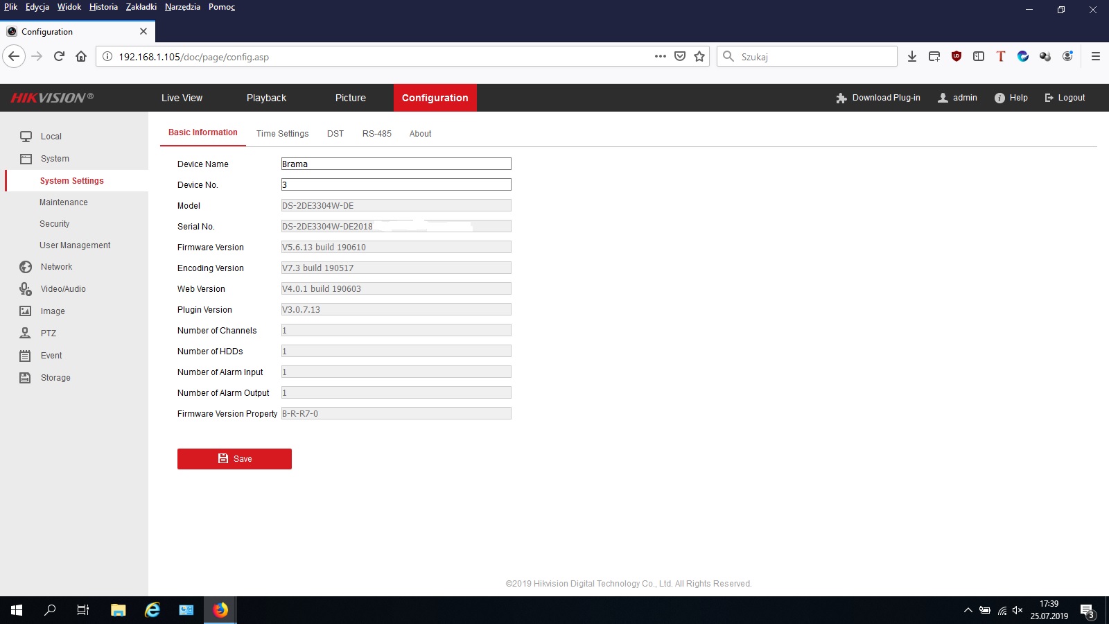

hi, 2 days ago I installed 5.6.11 and then 5.6.13. Unfortunately, it still saves the recordings only in the datadir0 folder.
It's better to stay with the old firmware.
