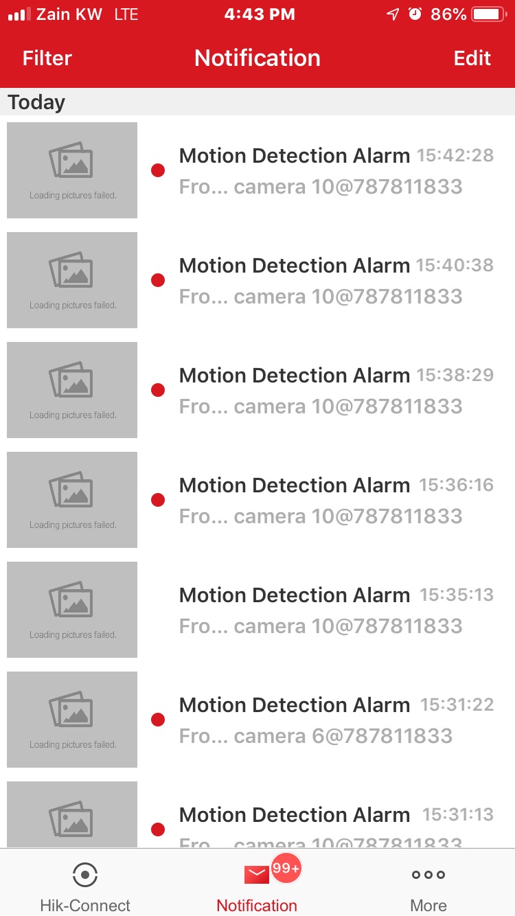

Any one facing in hik-connect ISO "loading picture failed" in the notification screen? if yes please help to fix it. it was working fine for a while then stoped loading picture right.
latest hik-connect software for IOS. even before it happen to me with different release.
thanks for your help..

Check the app has full permission to receive push notifications. In IOS I believe it's in Settings>Notifications, choose the Hikconnect app and toggle all the switches to ON. Close and restart the app and see if it makes a difference. Keep us posted.
Thanks StewartM for your replay,
all the setting was on, even I can see and review all the event, my problem was the picture in the event not showing in the list. actually now is working. All I did make the port from manual to auto in the network setup.

Did you ever find a solution for this? I am now having this same issue. I can watch the play back video recorded or watch the video live but the thumbnail image is display "Loading pictures failed."
Did you find the solution? This is happening to me, but I just discovered that is only by using WIFI. If I turn off WiFi and use my carrier network all images get loaded like a charm. So I believe the router is blocking a channel or port.
