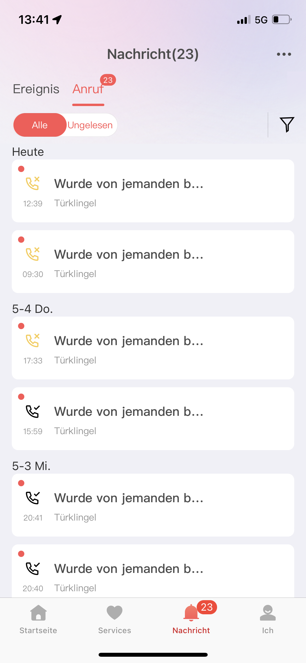

Update, just tried it out, it works and shows the photo under notifications. But the photo quality was only 720p
