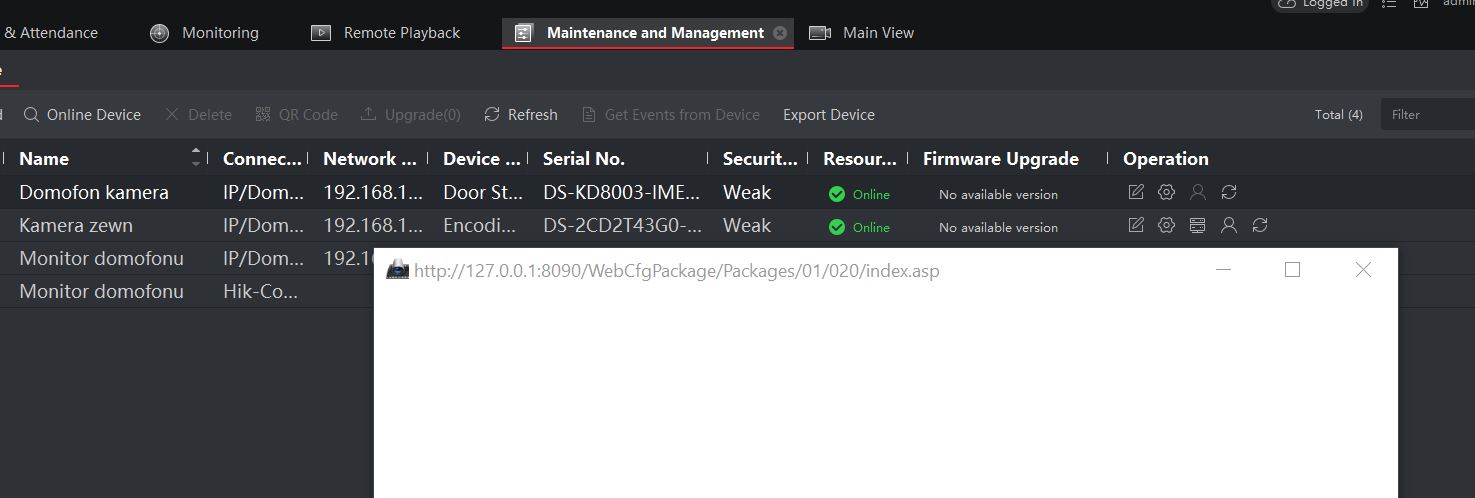

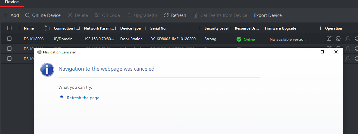

- I did a firmware update of outdoor station to the newest release V 2.2.62 built 230110. Update was successful, everything works fine (live view on the indoor unit, on the app, calls) etc) but after the update, I have no access to settings of outdoor unit over iVMS-4200 (the newest version 3.6.1.3)
When I click to cog wheel of DS-KD8003-IME1 I see only a blank page linked to http://127.0.0.1:8090/WebCfgPackage/Packages/01/020/index.asp
So I am not able to see any settings nor to make a firmware upgrade (or downgrade)

How to solve problem of lack of access to setup of outdoor unit over iVMS-4200 ? It seems to me that it might bring about problem with missing pictures.

Do you have a picture of the steps mentioned. It is not clear to me where I can make a change. I can no longer go to the website of DS-KD8003-IME1 : Via the website I get this error message : Access Error: 404 -- Not Found Can't locate document: /

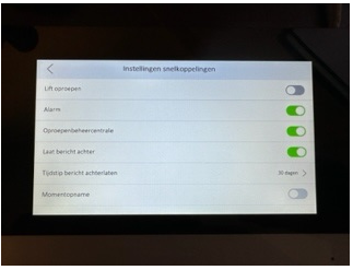

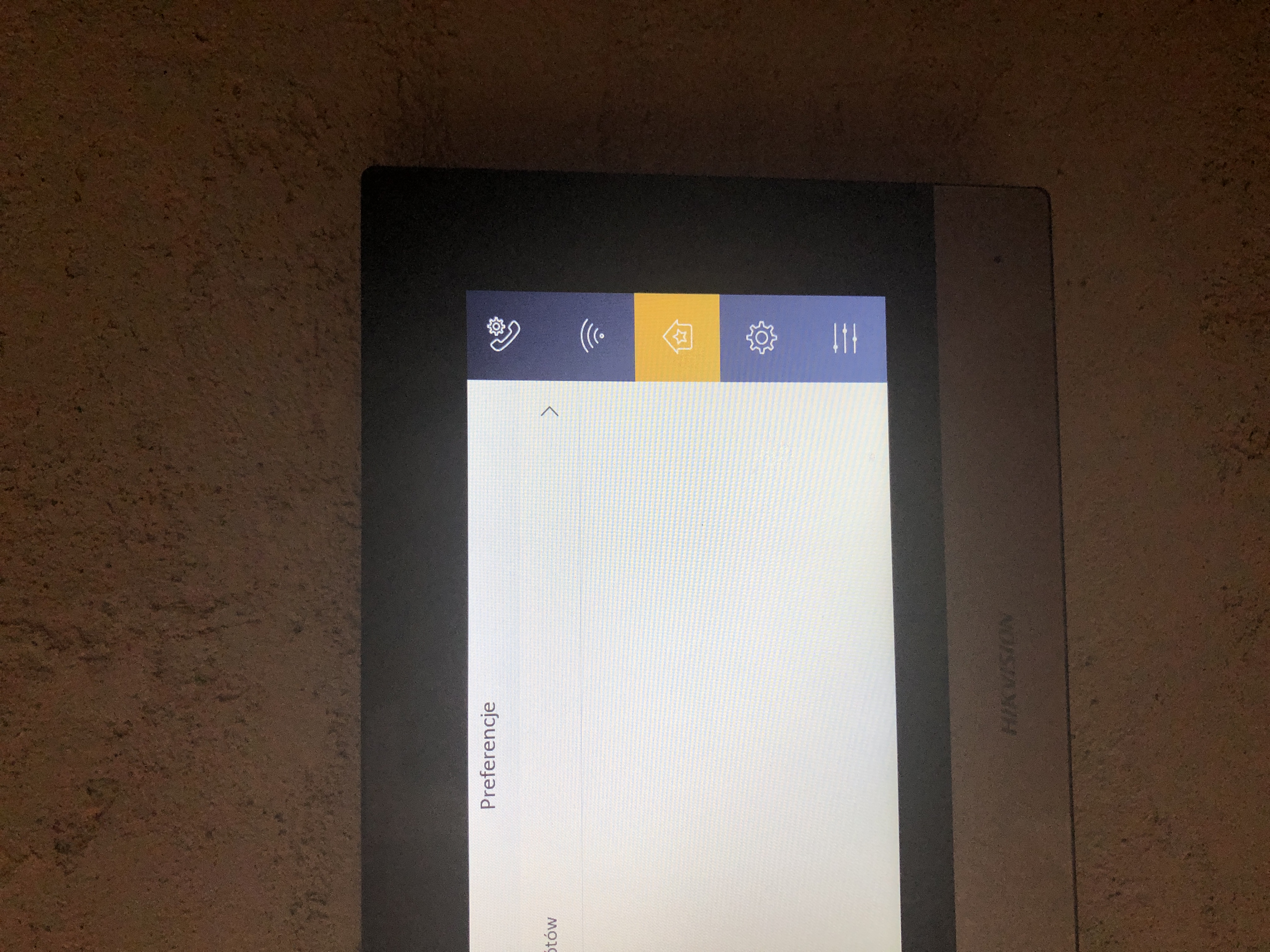

Touch screen inside the building - DS-KH6320-WTE1/EU.
Cog wheel (Settings), then Preferences (little house icon with star inside)
