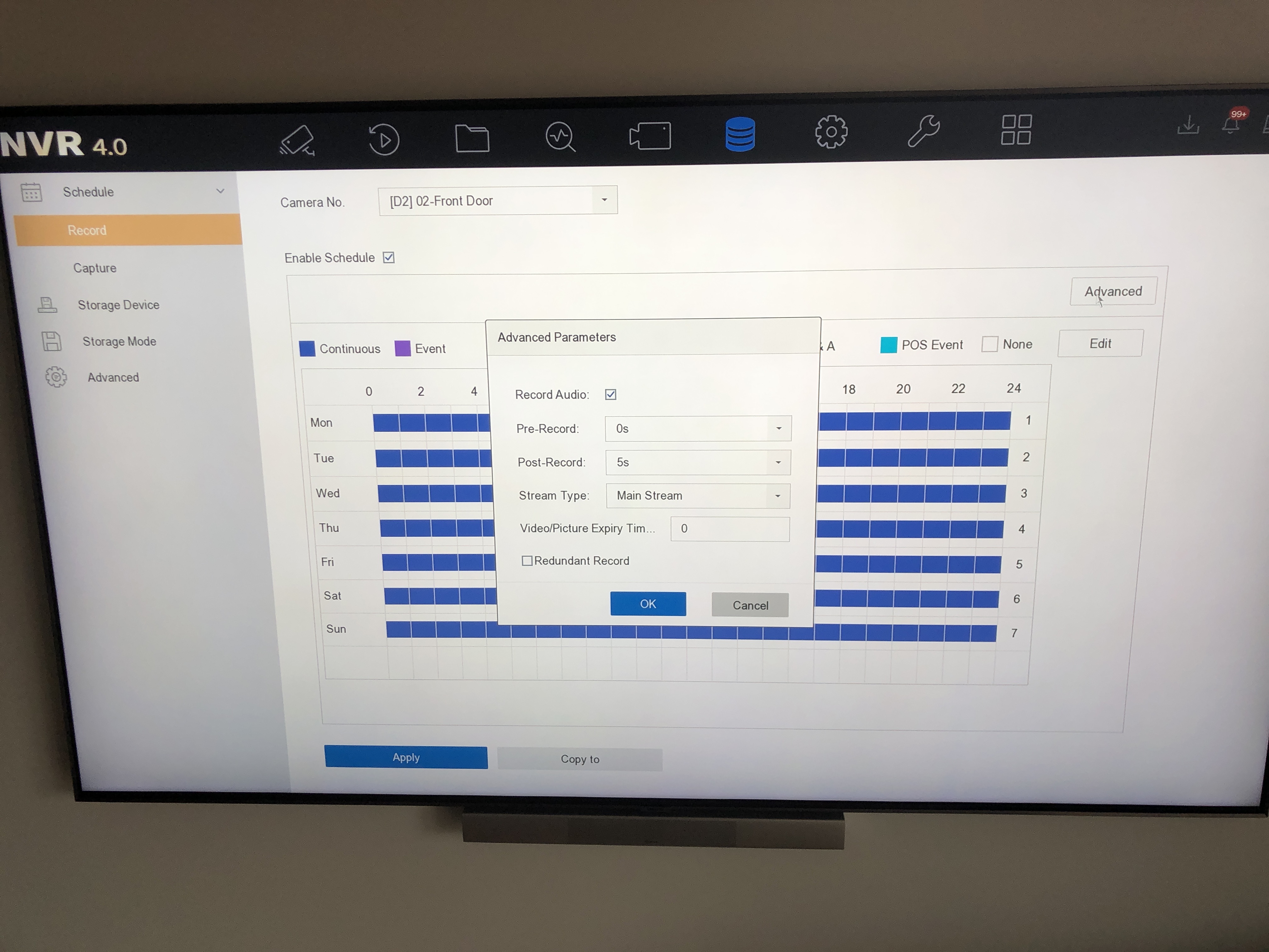

Does the camera record sound? Just viewing my videos back and don't hear anything.
We had a person wandering about last night, but because it was on perm record It took ages to find it. I need to set up motion detection.
