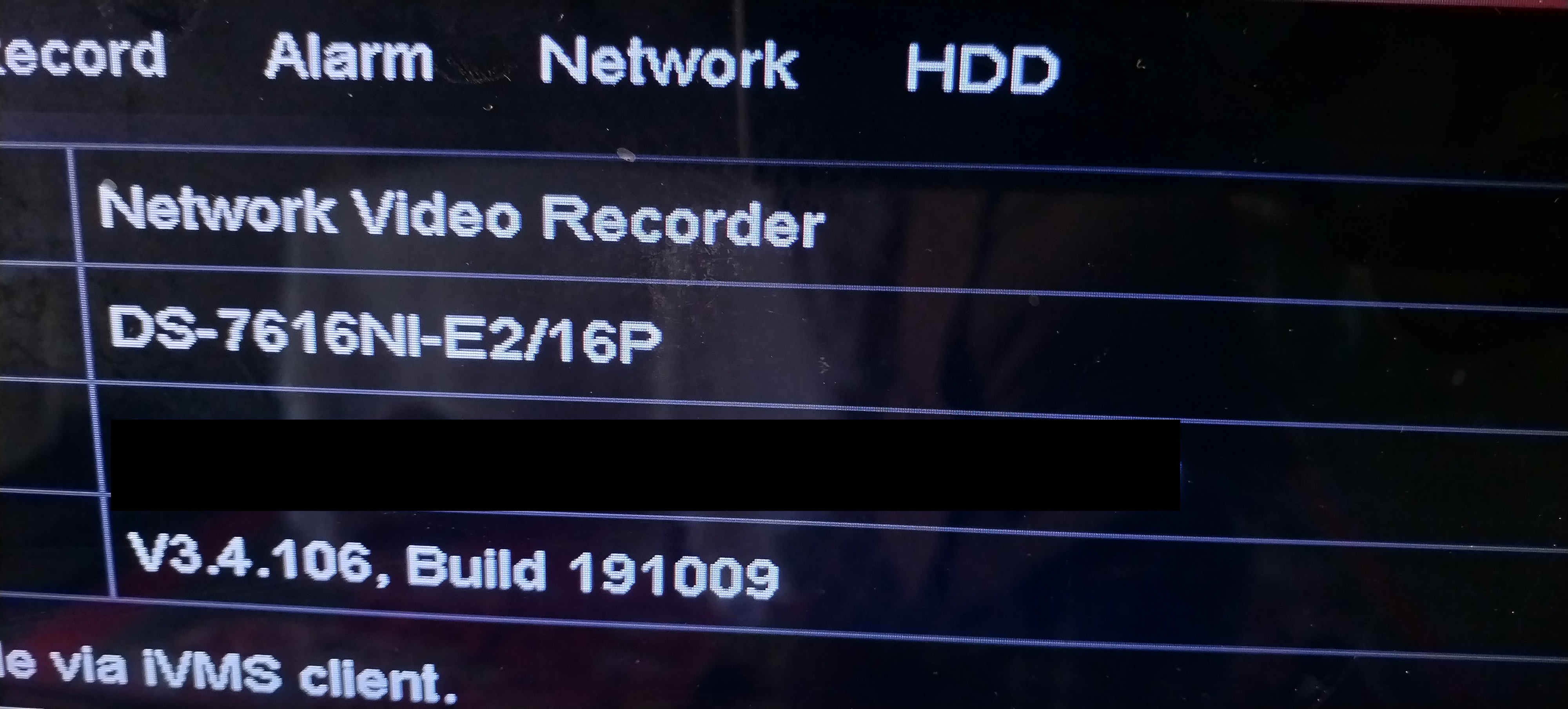

I have tried to upgrade to ver 106 but still can any camera connect to my NVR (DS-7616NI-E2/16P)
Any solutions, please help.
What firmware version is your NVR currently running please?
Thanks @Leo2moro
So you are already running the latest firmware, can you please confirm the model number(s) of the camera(s) you are trying to connect to the NVR?
Thanks @Leo2moro

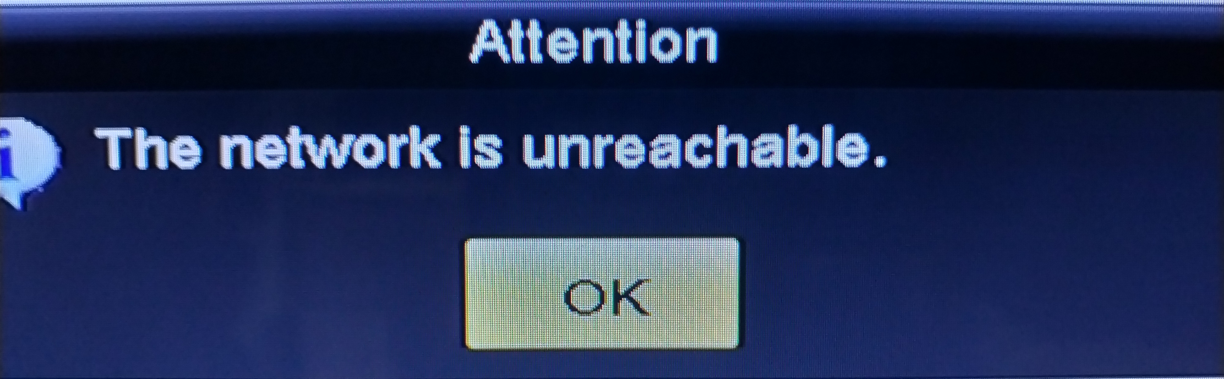

I have reset the camera manually but still having the same problem, it loops on detecting then stops and again loops.

Yes, have tried other cameras and they too don't connect including brand new ones.
Hi @Leo2moro
So do no cameras work in any of the PoE ports on the 7616NI-E2 NVR or is it just the 1st port that doesn't work?
If all the ports are not accepting any cameras then I think it is likely that there is a hardware fault with the NVR and you will need to upgrade to a newer NVR model.
