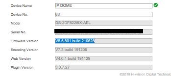

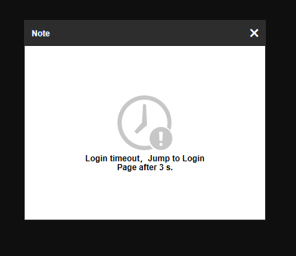

I'm part of a team operating Hikvision IP Dome cams, watching for wildlife in Africa. As such we might load several cameras, in separate tabs/browsers, using the webGUI. One of the cams seems to be triggering 'Login Timeouts', precisely every 15 minutes, requiring the user to have to log in again. Unfortunately, when this happens, it also frequently takes down other cameras, even if on another browser! It can happen whether using IE11, Edge + IEMode or Chrome + IE Tab.
Can anyone offer any suggestions as to why this is happening and how to prevent it, or extend the time to a longer period if that can't be done?

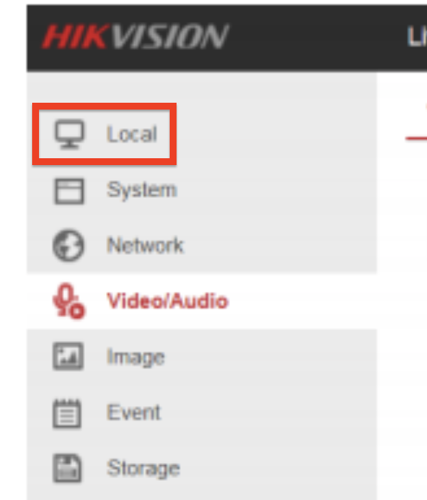

Hi Salamat,
On the Hikvision web GUI main page there should be a Local tab, can you set auto logout there?

Hi Salamat,

I've had a look at Local, and no timeout settings there, unfortunately. Researched through the manual for every mention of 'time' and there's nothing about timeouts! :-(
