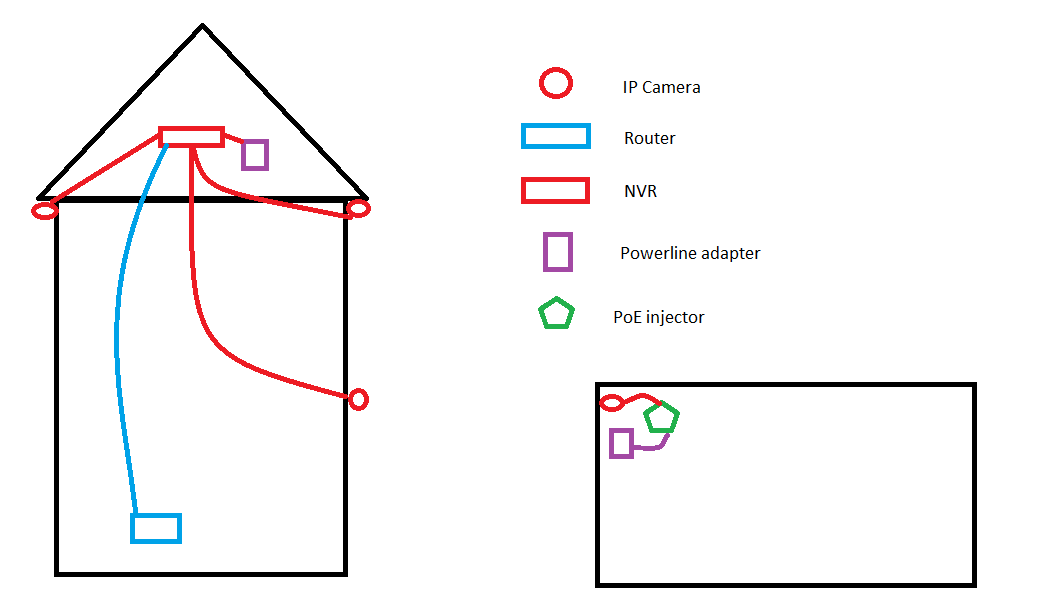

Remind me, does your camera connect direct to the back of the NVR or your LAN?
David
Picture attached of how it's set up. the 3 existing cameras are connected with ethernet cable, NVR hard is also connected to router with ethernet cable.
I didn't actually do anything since last time but it has appeared back on the NVR now, however still not connected to HikConnect so I can't view from my phone

inexplicably, the garage cam just appeared in Hik-Connect. I just had a browse in the app and it just popped up. so everything seems ok for now I think. the way I have connected the powerline adapter in my house(directly to the NVR) is that really necessary, or could I connect the powerline adapter directly to my router downstairs, would mean a shorter distance? I think from watching some videos that possible but could be wrong...
I'd rather have my camera on the hidden subnet of the NVR than on my router. Just my 2 cents.
