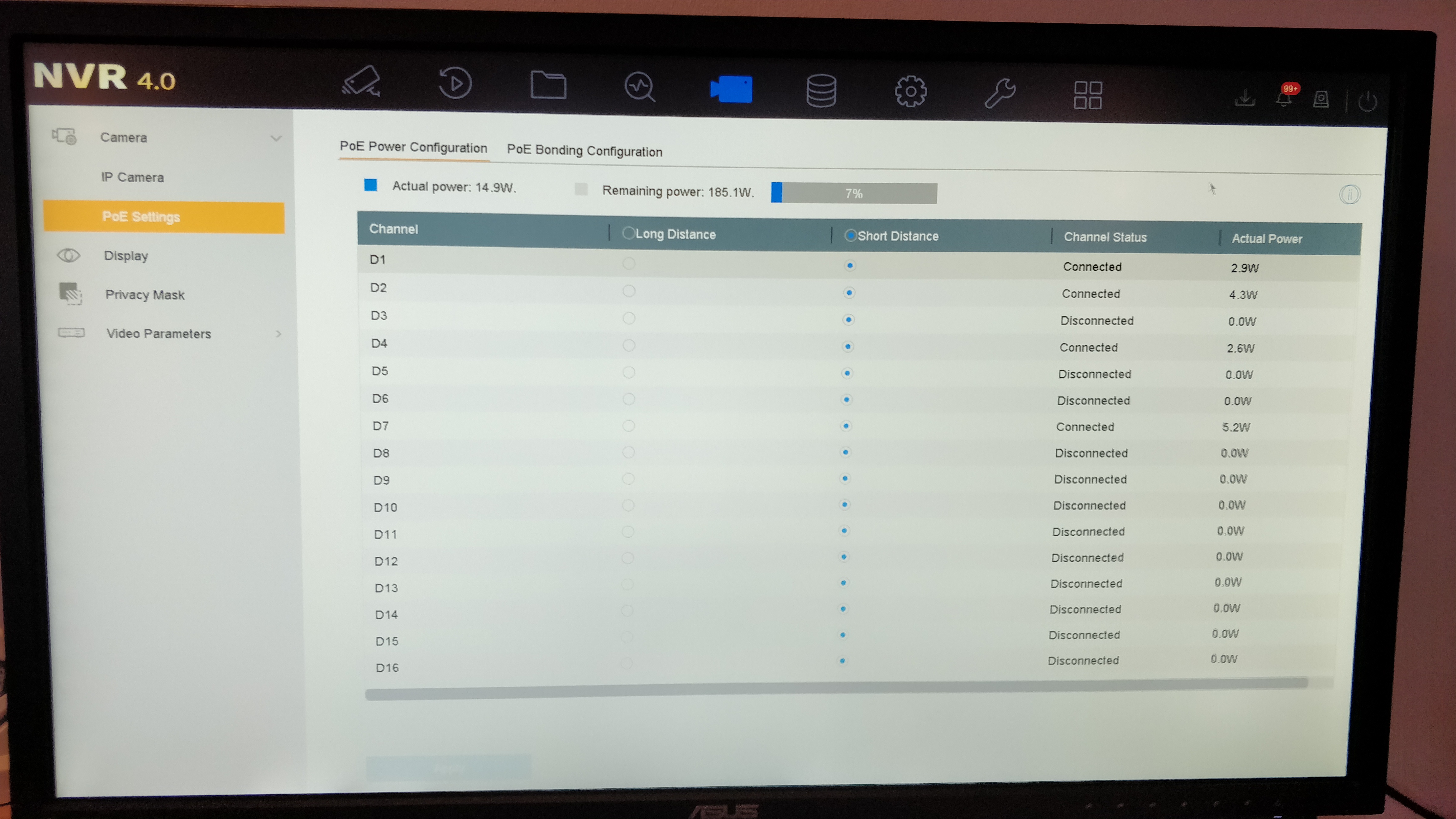

If you use a directly connected monitor you can navigate to the page shown below which gives you a live reading of the PoE consumption of the directly connected cameras, be aware that the total PoE level may appear low under the max. PoE supported when you view this data in the day time but most cameras will more than double their PoE usage at night when the IR LEDs are turned on, so maybe check both in the daytime and at night.

Thanks @Dan will try and get a monitor from somewhere as NVR in loft and my monitors in office are wall attached.
I would say that the fact that i can put PoE Extended in the way suggests either the NVR is under-rated to supply the 8x ports it has given I have only 6x IPC's connected and working out the numbers from data-sheets suggested that should not be the case, or another issue. Also, the previous failures/disconnected of the new (2163) and old camera happened during day and night, therefore peeking PoE load due to IR's (i would have thought) would not be the case.
