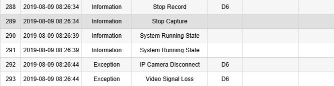

@fullboogie snip of log attached. Yes exceptions. That attached is the typical log posts when the camera disappears its #D6.
@Phil .. cable isn't CCA on this on. Although has been there a number of years (my 1st order with you :) ) so may have degraded. Is a mix of inside and outside as well.
NVR PoE load .. how can I calculate that? I would say of 8x ports on this 'new' NVR from April I only have 6x cameras on it currently. The total rating of the 6x cameras is 44w whereas the NVR as 7608 /P is <120W so assume load isn't an issue.

Thanks @fullboogie for reply. I have attached exported log. I you look (for example) toward end of this file you can see more of the detail where D6 (the camera in question) is lost/disconnected followed by NVR reboot which I did manually.
This is log from today, so you can also see other similar D6 disconnections in the log.

Man, you're getting lots of "IP Camera Disconnect" exceptions on several cameras, D3, D1, D6, D7. I've never seen that in any of my logs. Have you noticed the "POE Power Supply Exception" seems to occur immediately before those disconnects? The description to the right states the power is going to 0.0W, then you get the disconnect. They may be related. Below is at 15.09
@fullboogie agreed, I came to the same conclusion myself
I am far from any kind of expert, still learning. But I have to wonder if the POE ports or power supply is failing?
