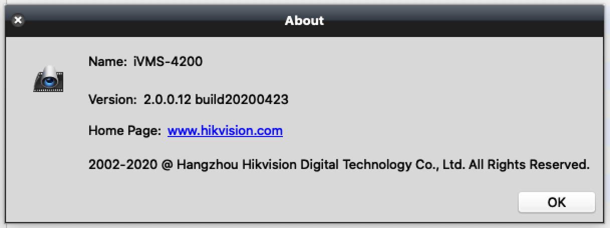

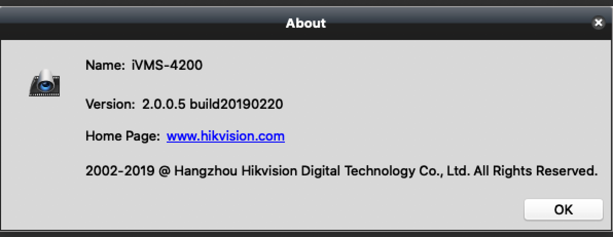

@David Drewitt what version of ivms4200 are you using? mine is (see pic) and keeps crashing. @Dan
I find Hikvision software releases and versions confusing. The Hikvision US site shows iVMS-4200 v2.0.0.10 Mac64 as the latest available version... but the UK site shows 2.0.0.12. Anyways... I tarballed the 2.0.0.10 version in /Applications and installed 2.0.0.12. It seems more stable (2.0.0.10 is awful for bugs) in the short time I've used it.
Update.. I noted there are still issues with the individual camera tool bars from iVMS bleed through to other active windows which is a pain.
