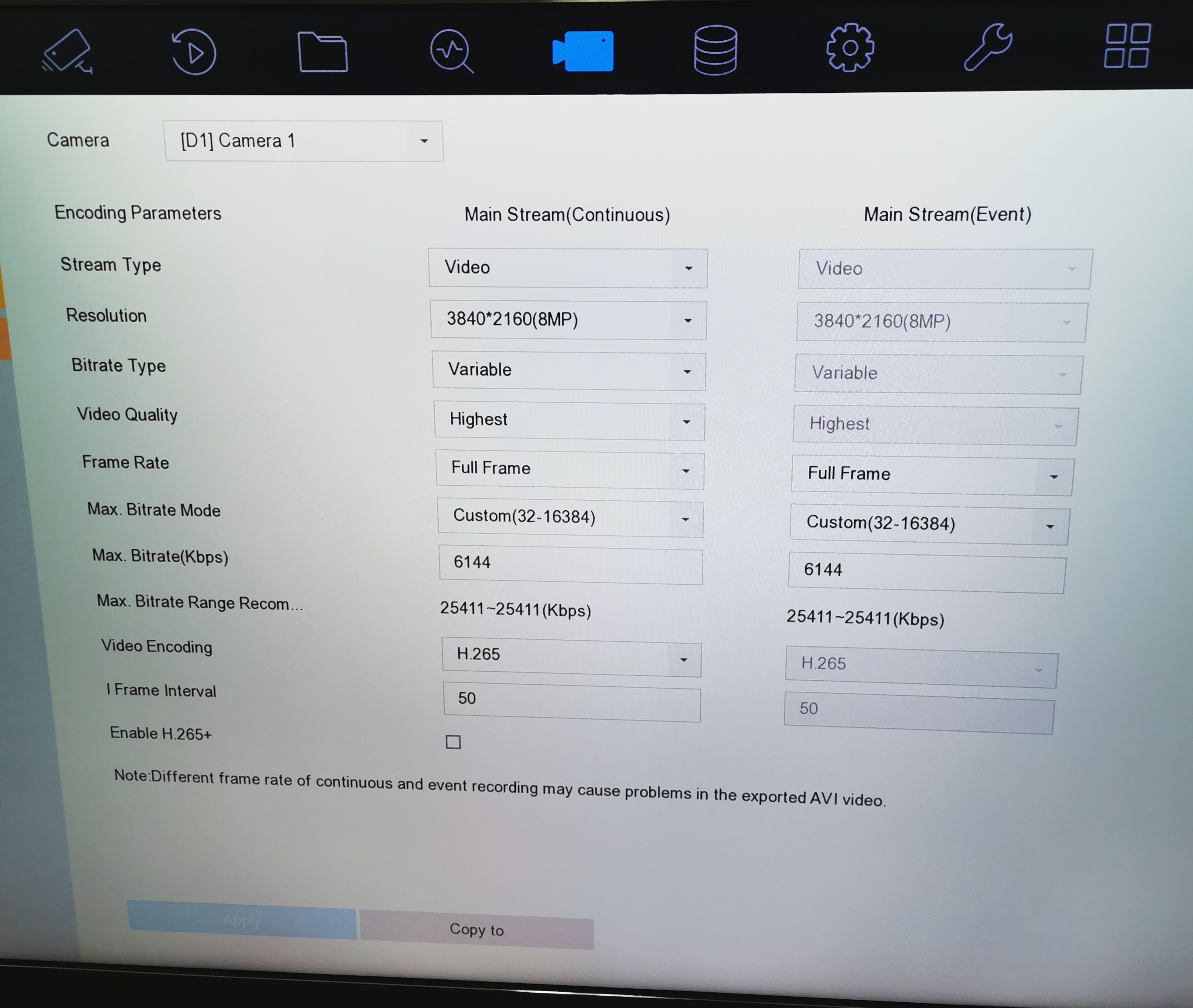

Add video streams edited. The only thing I could not do was on the Sub-Stream and that was to set the Video Quality to 'Medium', as if the Bit Rate is set to Constant that can't be changed.
Question: Ref the Main Stream can the video Quality not be changed to 'Highest' to get the best feed?
Testing - Hmm I had to the iframe back to 15 it to play back in VLC. If I went higher I only got audio playing back.
