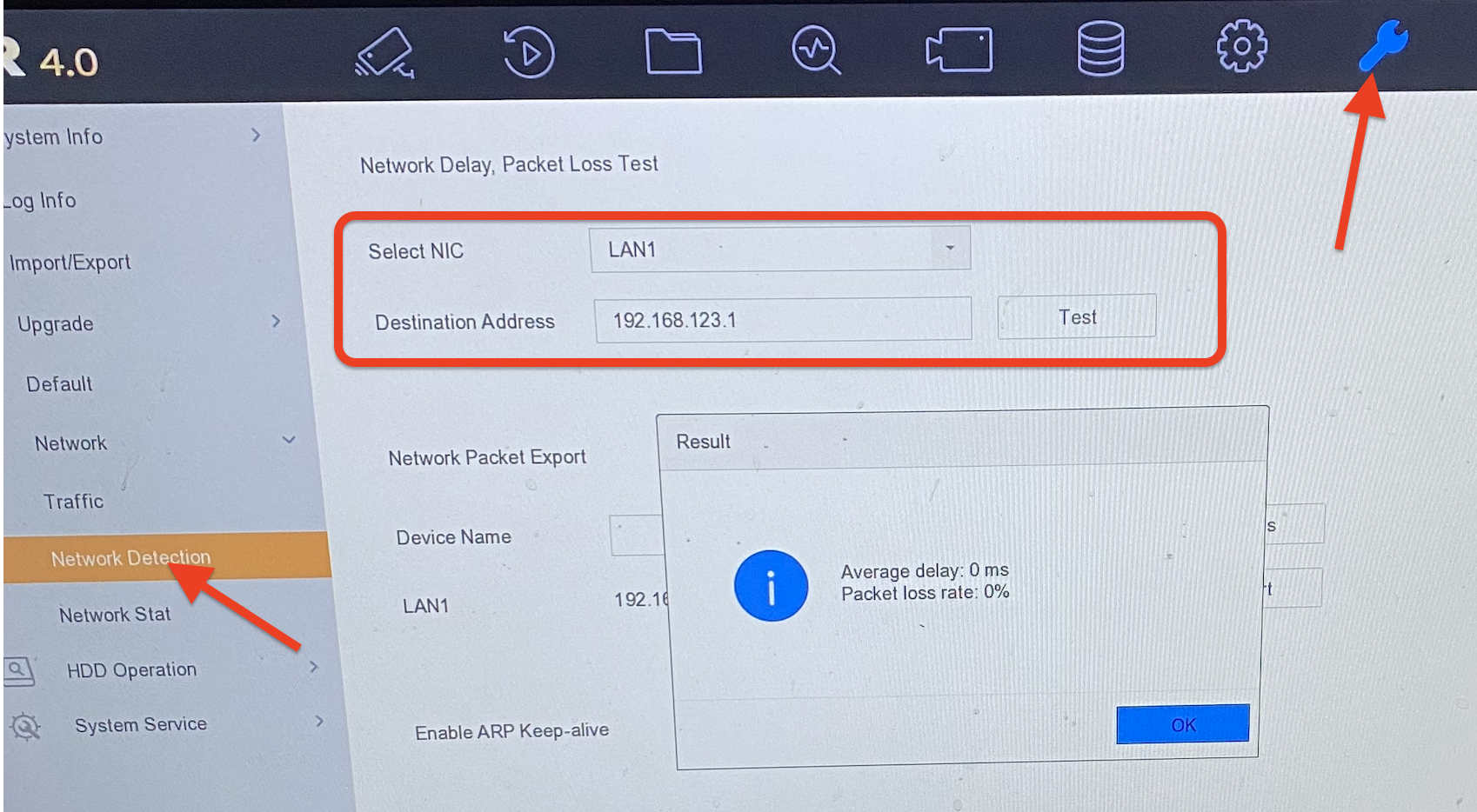

See attached image from my older NVR, should be similar to yours. Your NVR ping test may have more functionality. You may be able to ping the cameras from your NVR, I don't know what the ping does so the results could be misleading.

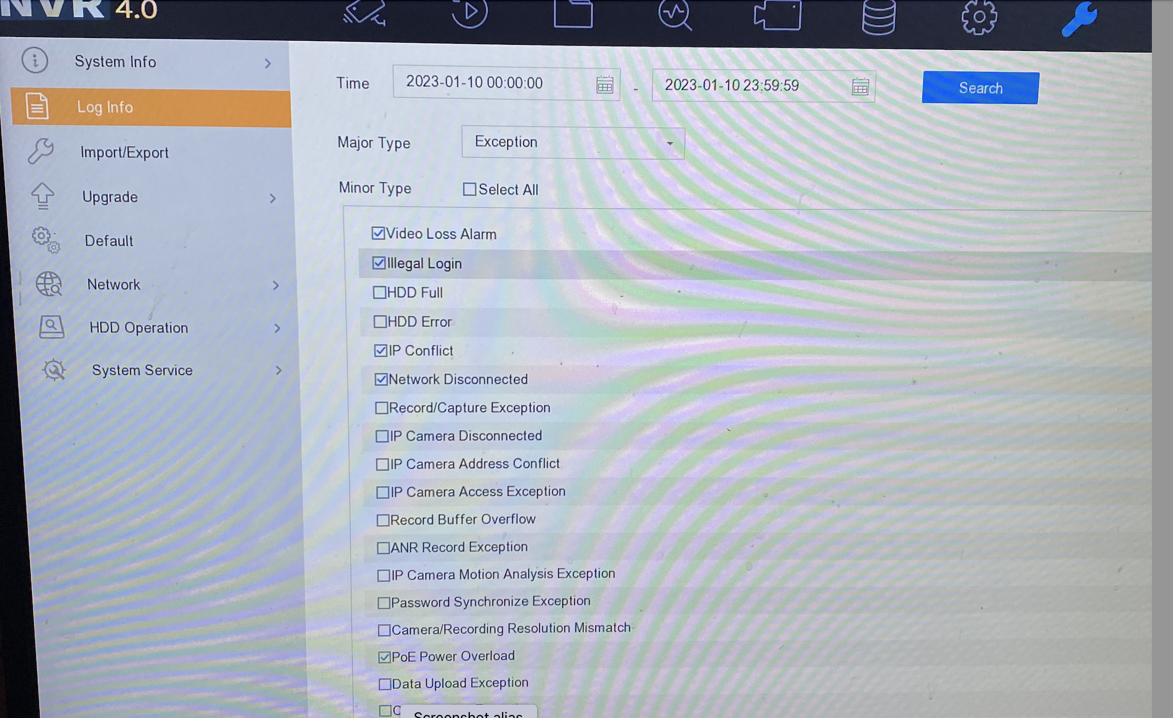

Can you export this log from the NVR?
set date time range
Major type exception
uncheck minor type box
select ones I've checked. Deselect the illegal login box.
you can check others if you think they are relevant.
set date time range
