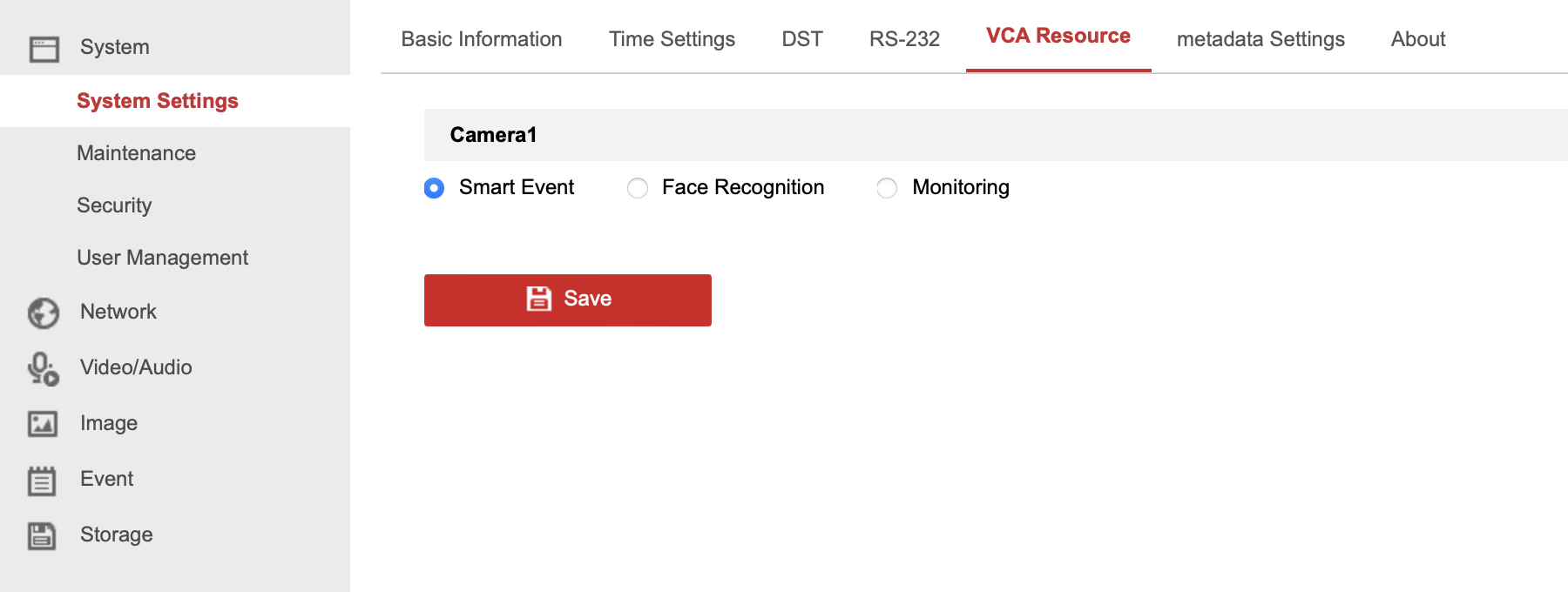

Your camera does not support Vehicle Detection. The AcuSense feature can be used to filter out events other than Vehicles (and/or Humans). 'Vehicle Detection' is something different entirely.
The camera can be set up for Face detection by enabling it in the camera (not the NVR) here:
The camera will reboot after the setting is changed, then you should be able to configure the Face Detection settings. However if you choose Face Detection, you are disabling Smart Event so you will lose line crossing, intrusion detection etc.
