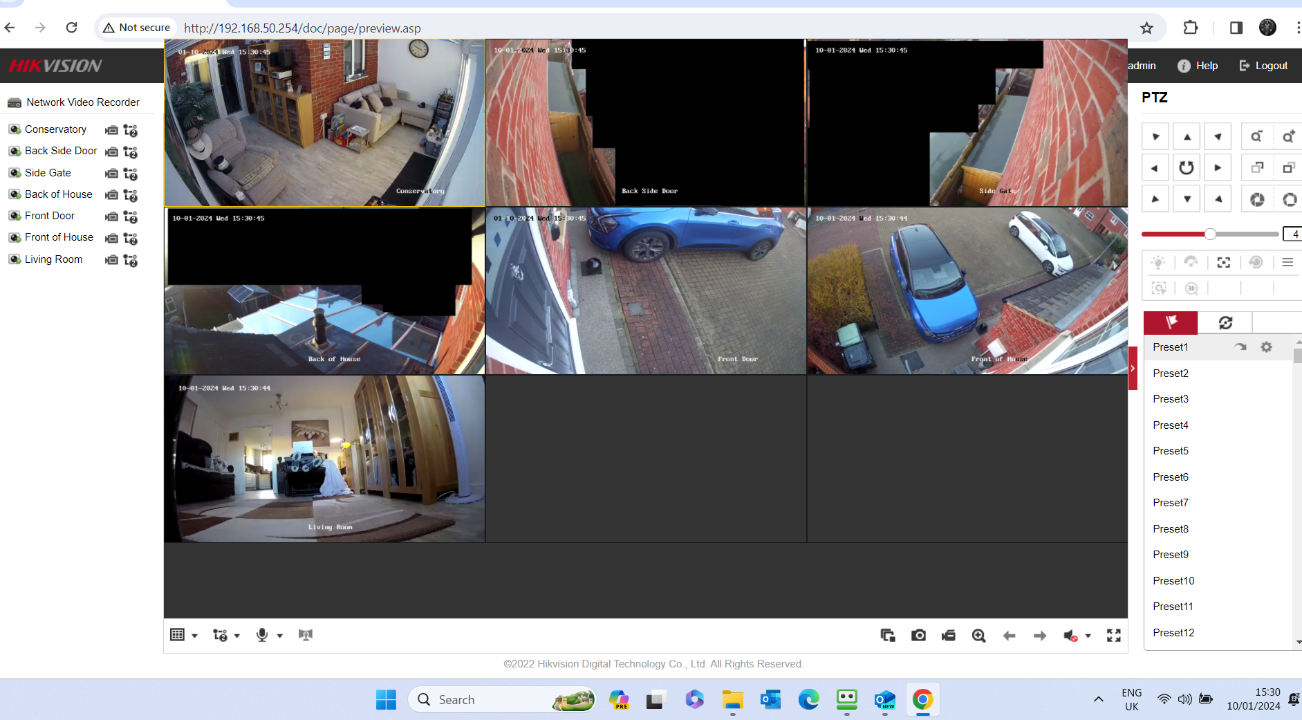

Can any one help, See pic attached.
The live display on the NVR or TV HDMI or if go to camera direct, it makes no difference, the display covers the menu bar.

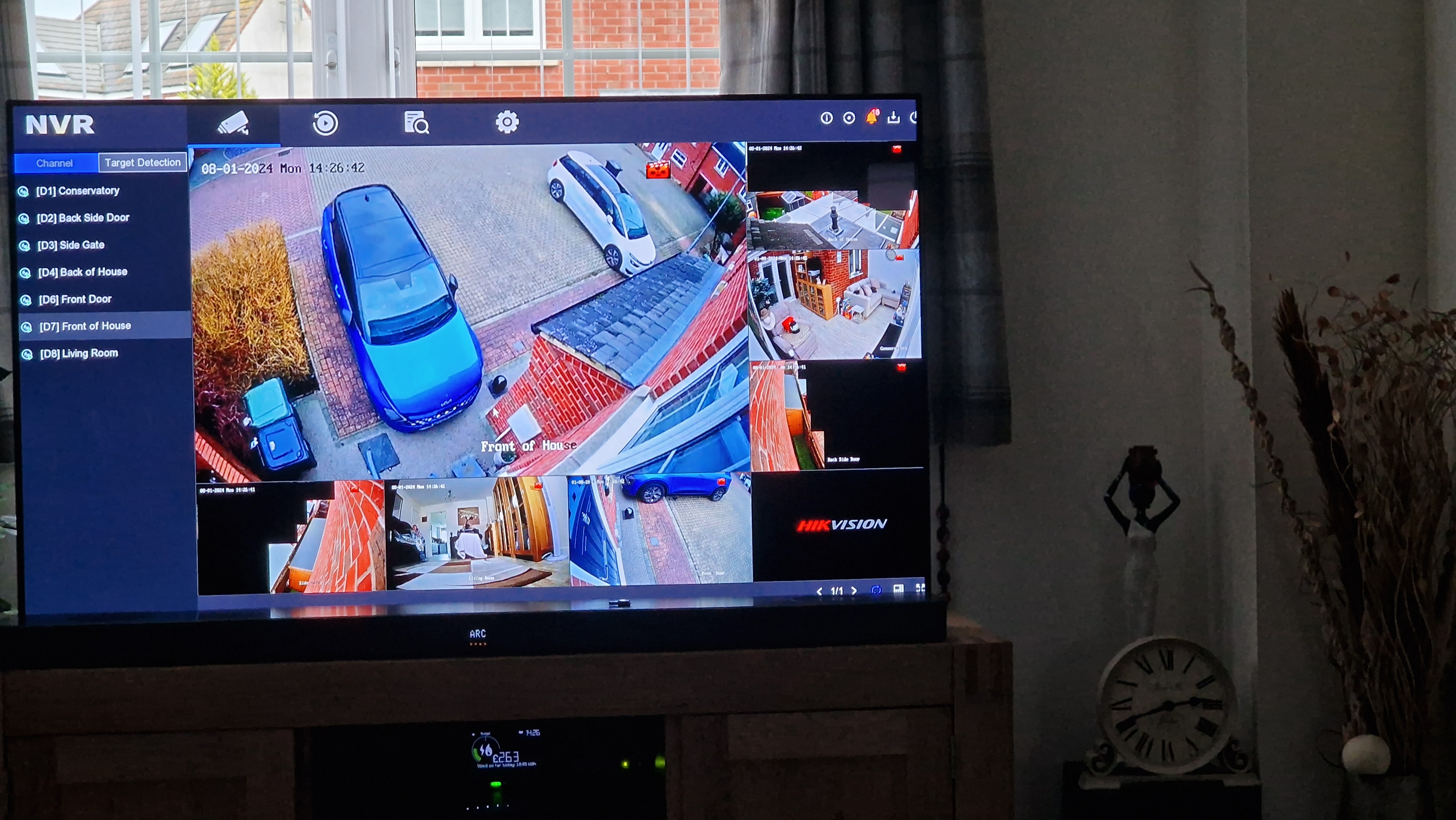

Thanks @Ryraum

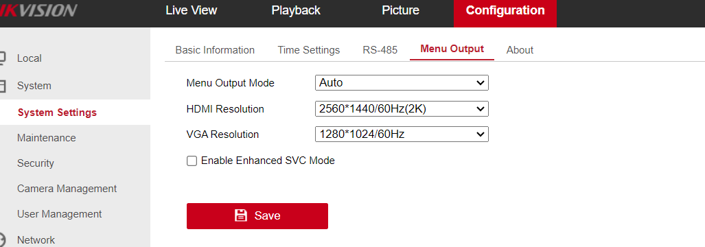

What is missing from the direct monitor GUI? Looking at your photo and comparing it to what we can see on our demo NVR you aren't missing any menus.

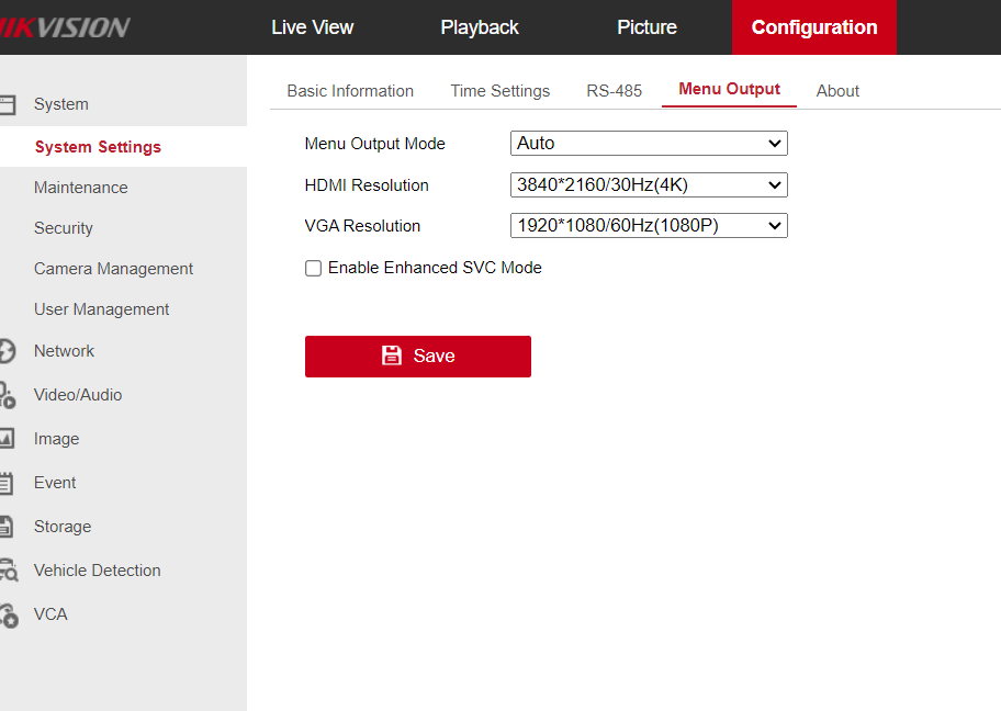

The resolution is pushing slightly beyond the screen limit, you can adjust the NVR output resolution by going to Configuration (cog symbol) > System > General > Basic Settings where you should see the drop-down labelled "VGA/HDMI Resolution".
Hi Dan
I changed the settings you suggested, from the 4K to 2K, this had no effect.
Bit the first image shows the live display before I load the LocalSeviceComponets, it is then that the display changes in both screen settings.

@Ryraum. On the TV it is your TV settings causing the issue, I see this all the time. Adjust the aspect ratio of your TV with the remote control. If it's on Auto change it to 16:9, if it's on 16:9 try Auto. If after adjusting that, the edges of the screen are still missing, you need to go into the menu of the TV and somewhere in the advanced picture settings you'll find an 'overscan' option - turn it off and then adjust the aspect ratio again. Also change menu output to HDMI from Auto if you're only using the HDMI for the connection.
I have checked the TV setting and they are correct.
It has been displaying on the same setting since first installed, only in the past two months have this problem arose.
IF it was the TV, why is it the same on my Laptop.
Strange. The settings on the NVR will only affect the HDMI output and directly connected monitor. They are not linked in any way to the display output to a browser. I think there are two issues:
1 - The TV scan is not correct - look for that advanced setting I mentioned earlier before adjusting the aspect ratio and using the 'fit to screen' option if there is one.

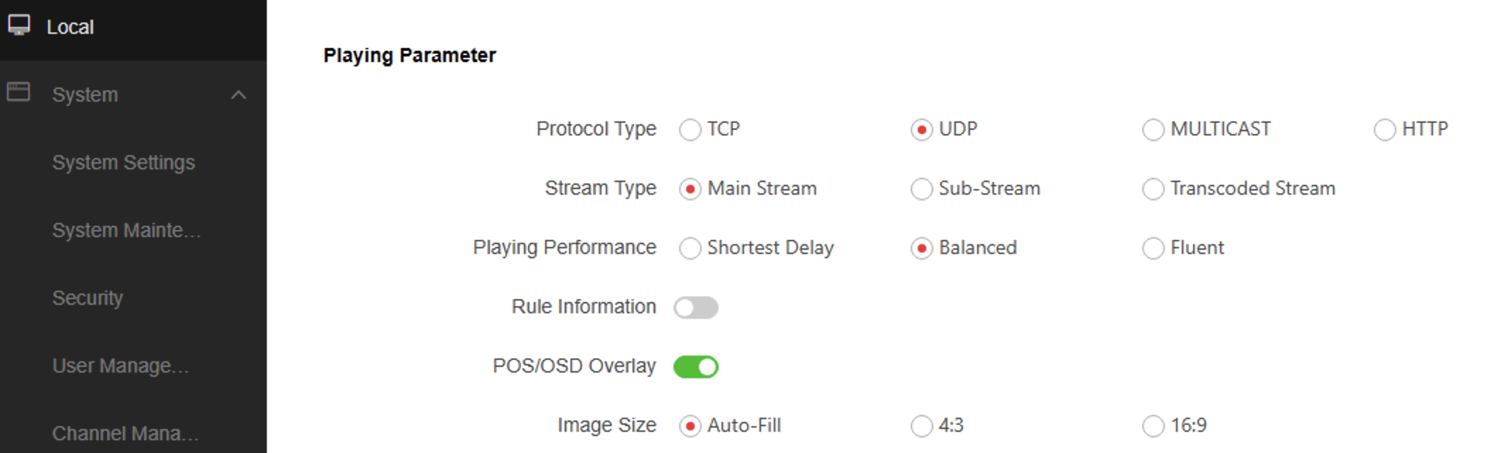

2 - The display output to the browser. While connected via browser go into Configuration > Local and try altering the image size perhaps as shown below:

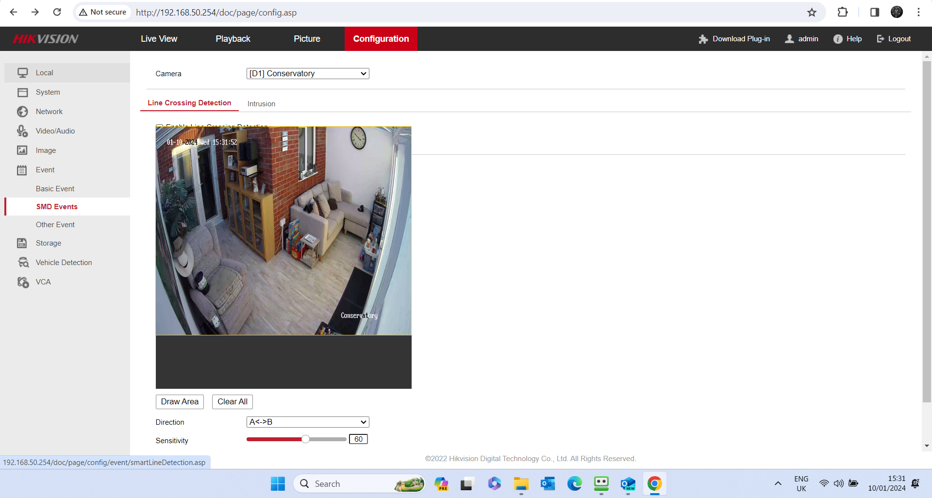

Maybe I did not make it clear.
The TV and Laptop are both displaying the screen correctly.

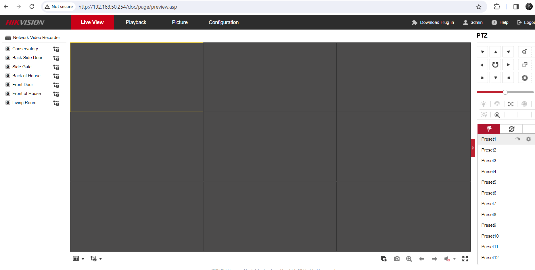

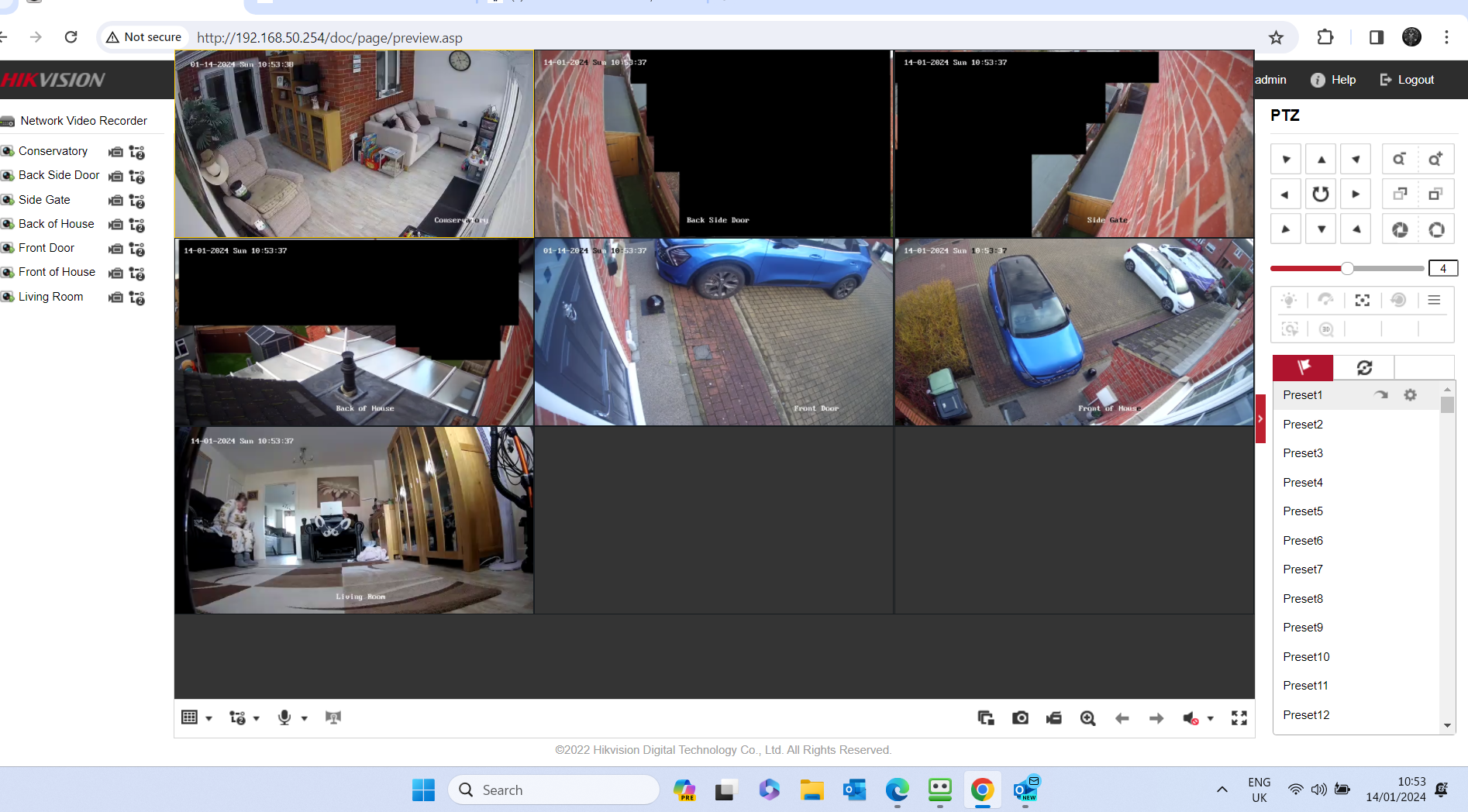

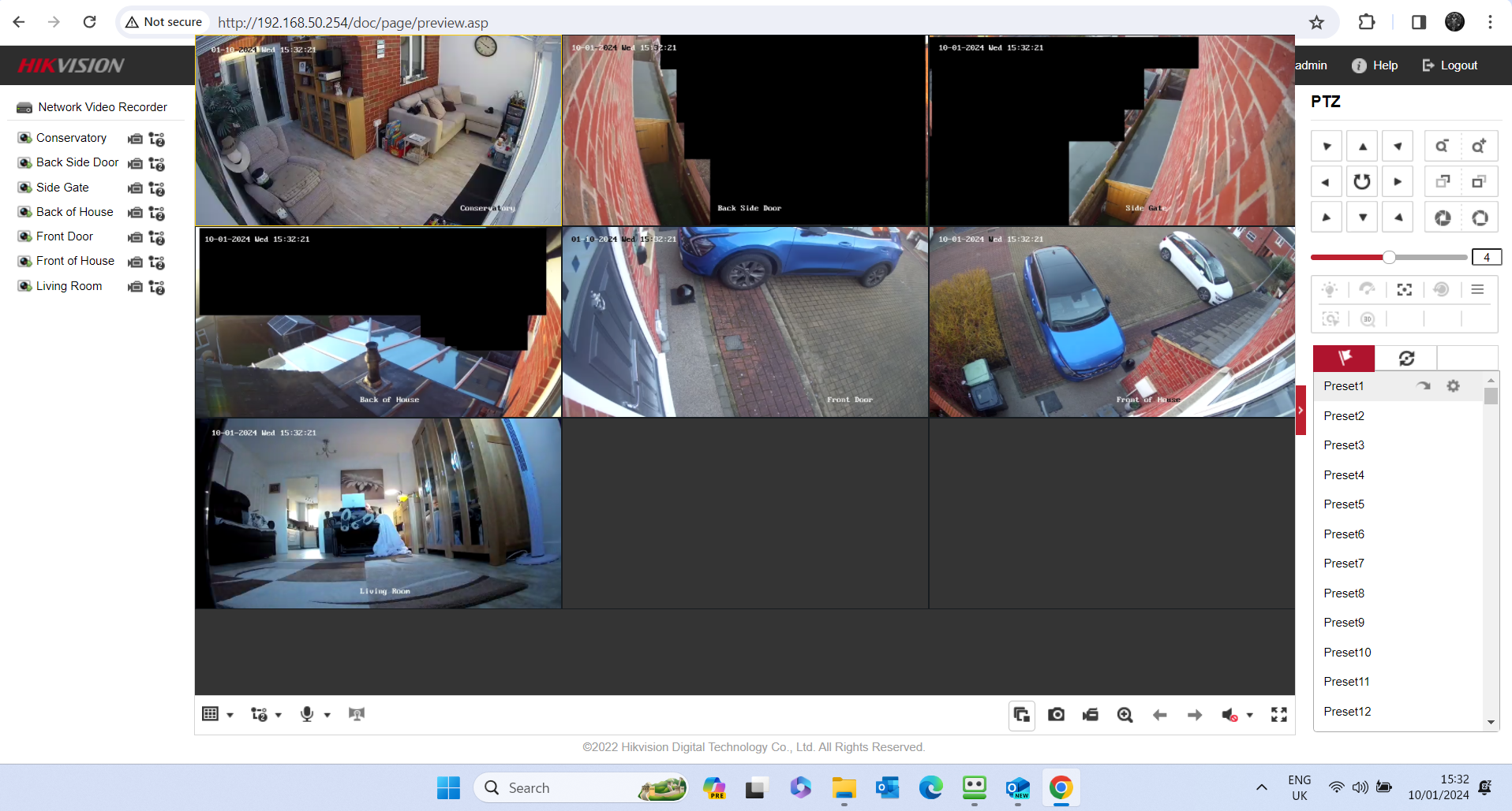

The problem is not the display, but the area where the live display is, see examples below.
Try connecting using a different PC. It's a browser issue, or at least a problem with how your specific laptop display driver is rendering the web UI elements. I've not seen this before. Have you get some 'page zoom', 'text size' or other accessibility option enabled?
Also maybe try disabling any browser extensions, particularly those dealing with video play such as the popular "Disable HTML5 Autoplay" or other similar extensions.
I think it has something to do with the pc screen resolution... changing the pc screen resolution may correct the issue... but you probably don't want to change your screen resolution... so a better fix may be to change (reduce I think) the zoom level on the browser. I use Edge and it remembers the zoom level individually for different sites... pretty sure all modern browsers do.
Hi
Sometimes, wrong or not fully compatible plug-in causes this issue. Wrong position and picture not moving with page scroll
Download and install plug-in shown top right of chrome
Or try opening with Edge Reload in IE Mode. Install plug-in if noted
In general there are many issues with plug-in compatibility. iVMS installs its own ie plug-ins, Hikvision has generic plug-ins in support pages that work with some devives and do not with others, every device asks for its own plug-in even if a newer one is installed....

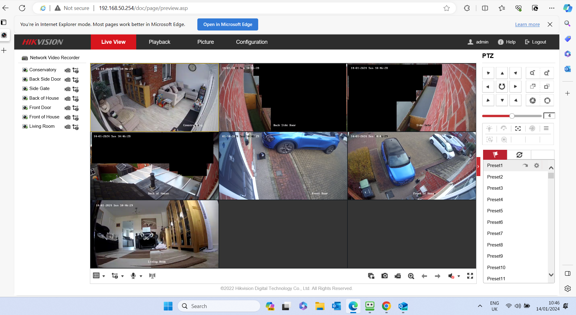

Hi All
After a few more tests and playing with Config, I would like to share the following with you all.

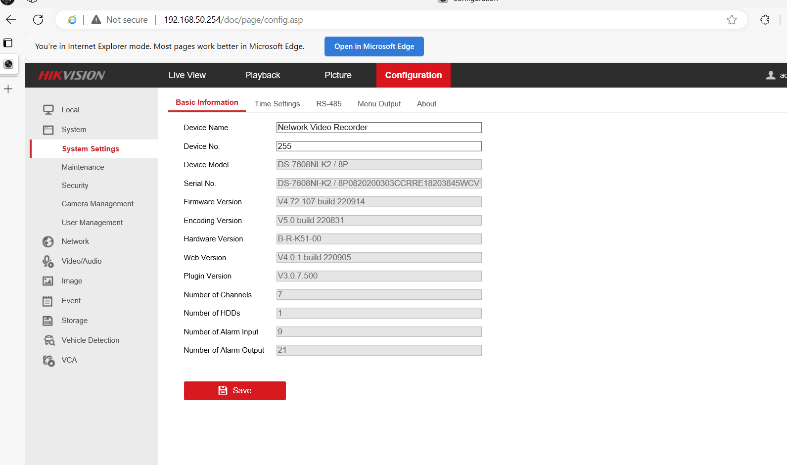

I added Internet Mode to Edge and set up the address
The result was all works fine on Edge, see below image and settings.

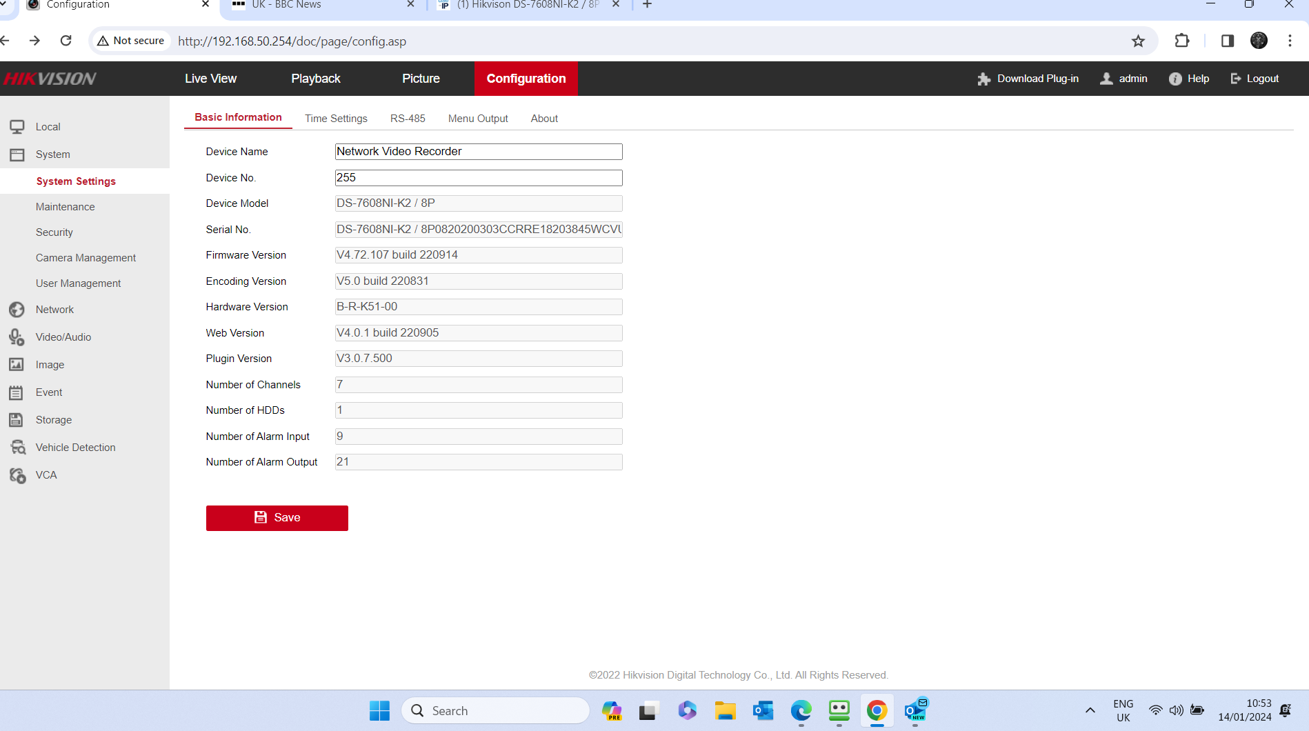

Chrome still showing incorrectly, Settings below,
Here are the setting from the last time it worked correctly on the Chrome and TV HDMI.
Model NVR DS-7608NI-K2 / 8P
Firmware Version V4.32.116 build 220112
Encoding Version V5.0 build 211229
Web Version V4.0.1 build 211217
Plugin Version V3.0.7.500
Number of Channels 7
Number of HDDs 1
Number of Alarm Input 9
Number of Alarm Output 21
