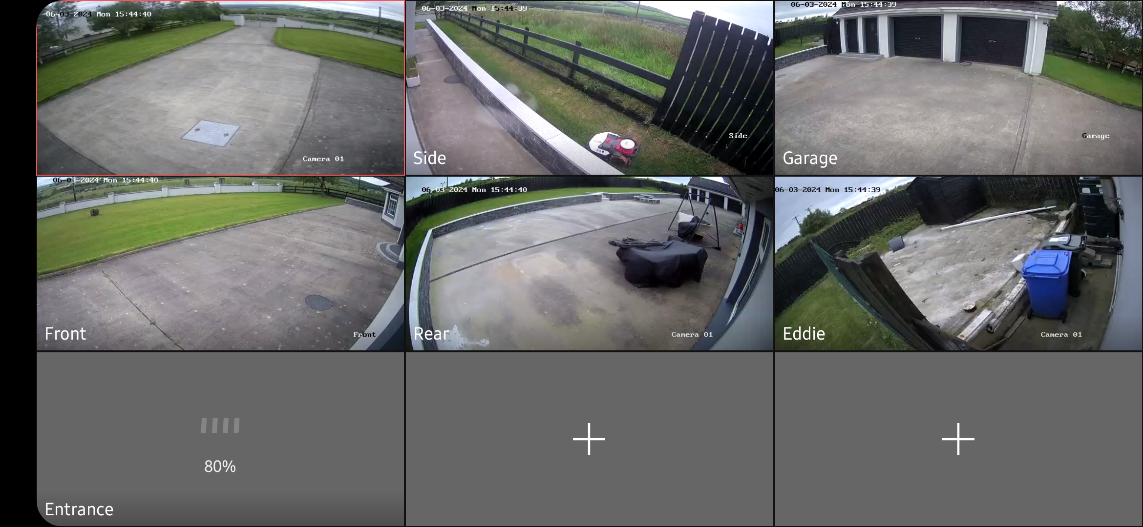

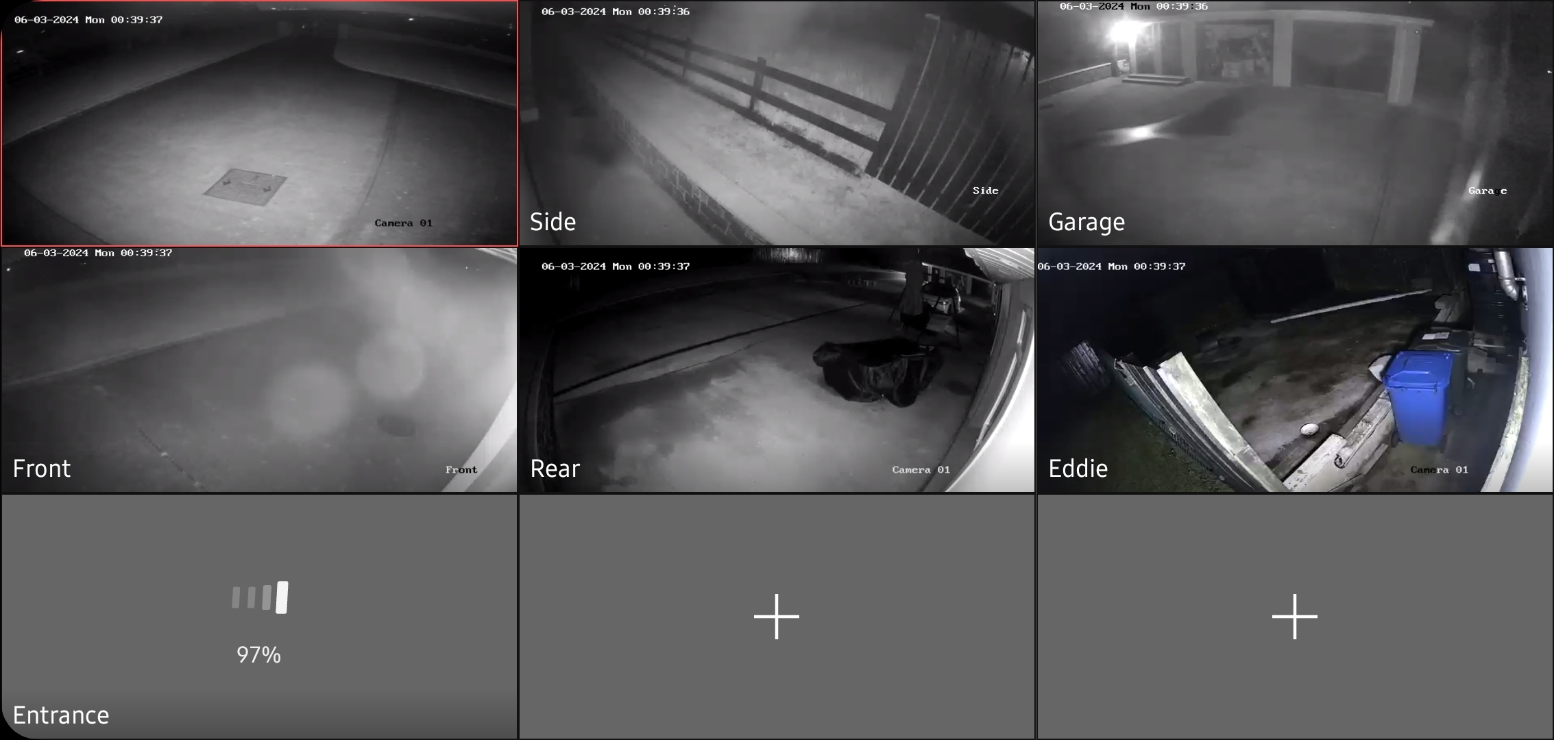

This is a day & night look to give an idea of layout. These are the SD feeds.
Excuse the angle on the dog run, I was adjusting the other day and haven't aligned it yet. Plus I've been doing a clearout so the place is a tip.

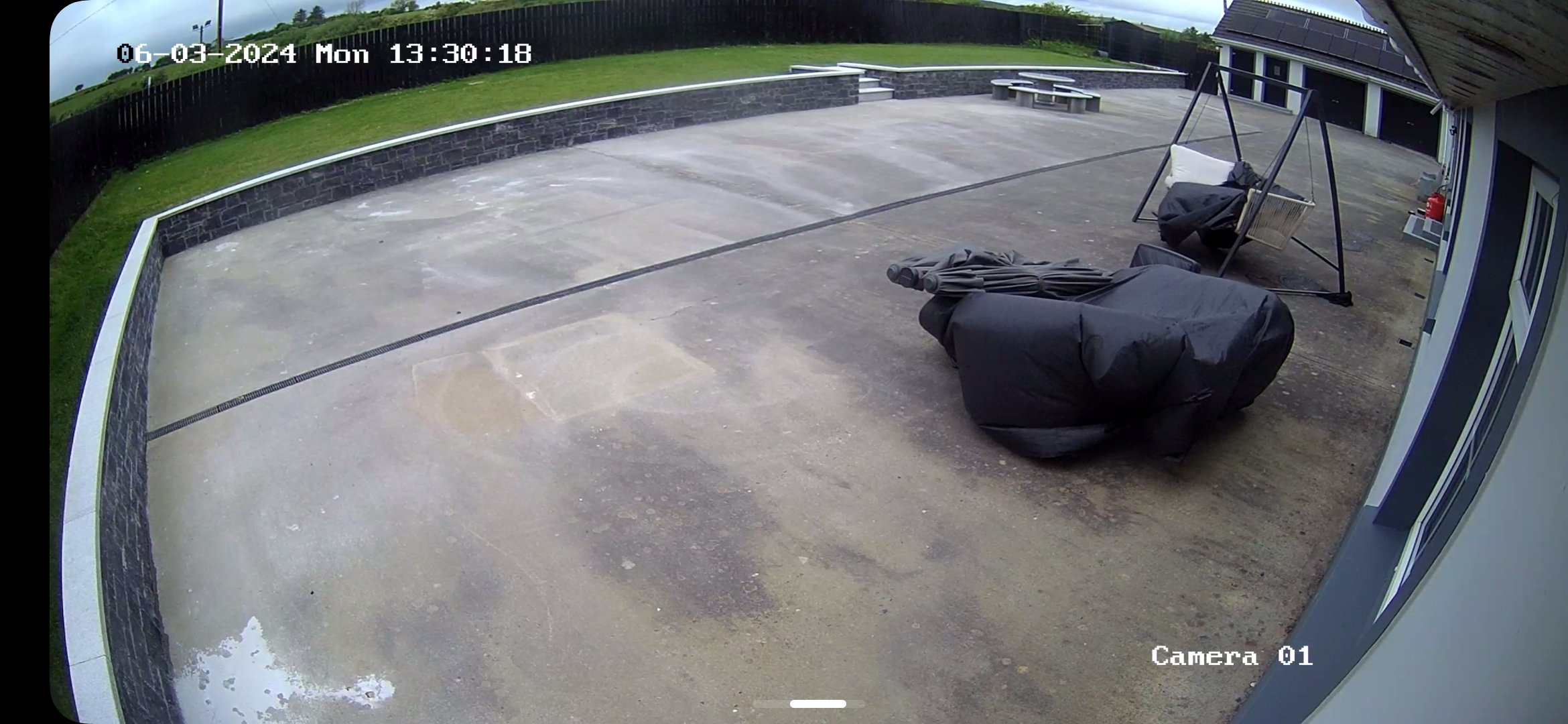

This is a HD feed screenshot of the back yard:
