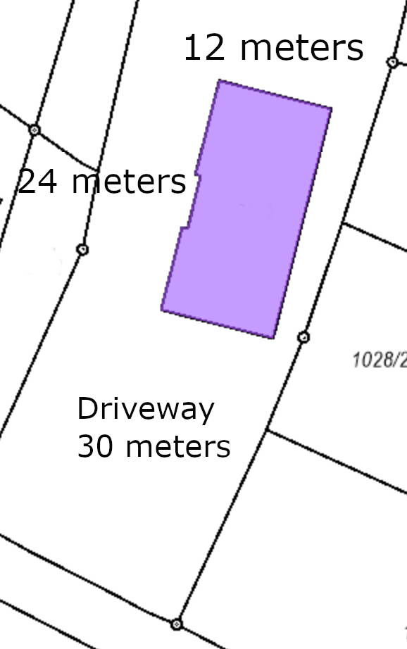

I want to ask you for advice, I want to buy cameras from Hikvision and I would need advice. I have cables in the corners of the house and a POE switch ready. There are no street lamps or nearby houses around three sides of the house. In front of the house, a lamp approx. 30 meters. The house has sides 24 m long and 12 m long, see attached image. Can you please advise me which cameras to use?
