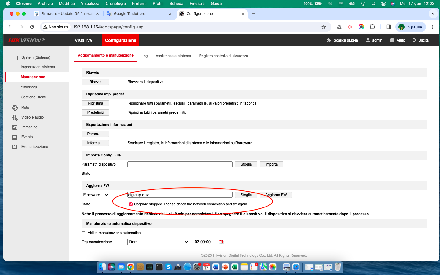

@JB1970, sorry, I don't know what to tell you. I used a Fujtsu lifebook with windows 6, and I can confirm that it asked me for a configuration password. If I can reply with a borrowed Windows PC I will definitely send you a screenshot. If I update to the old firmware V5.5.113_210317 with Mac and Chrome it gives me the attached message. I'll try Safari soon

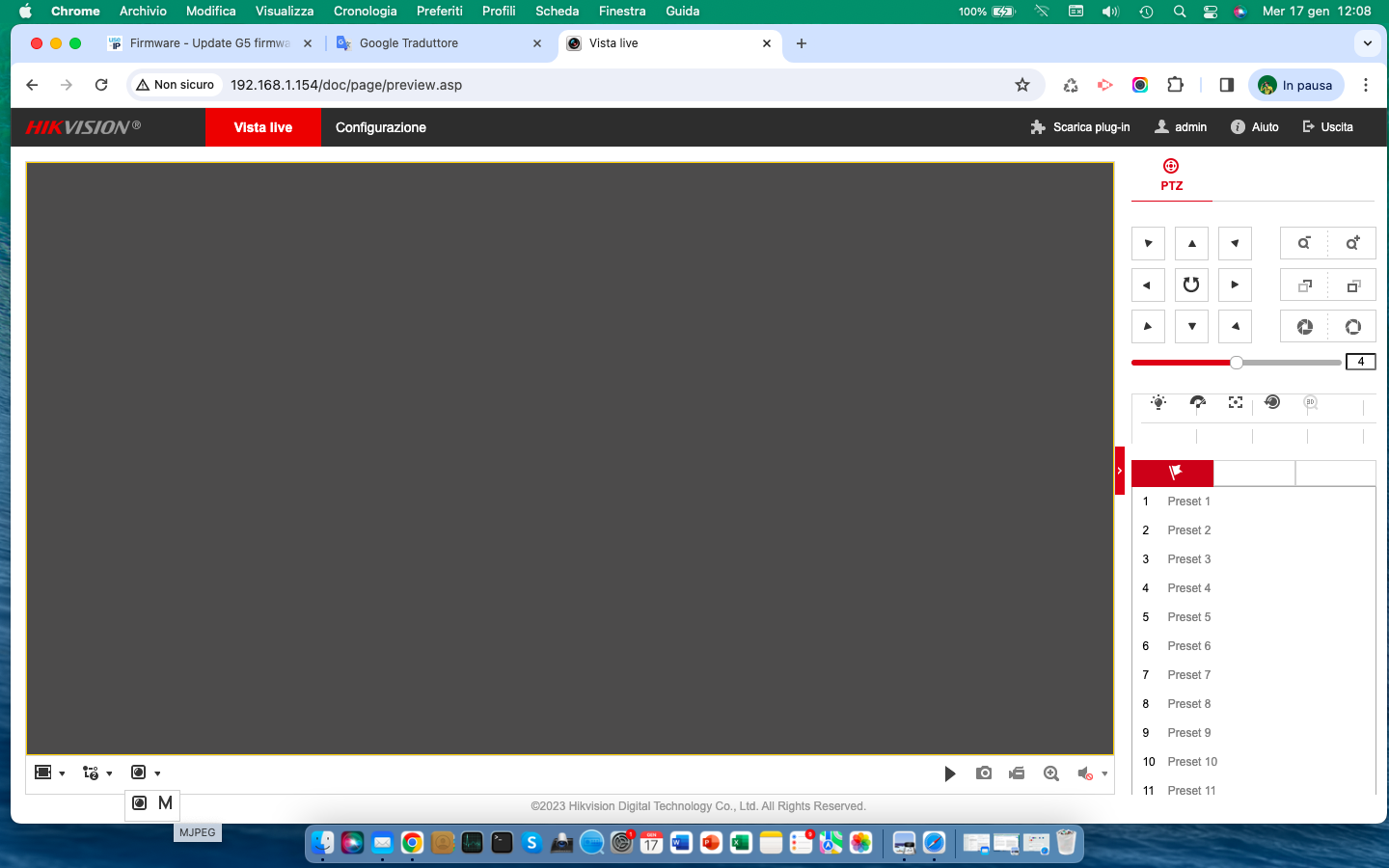

@alfaclvi The plugin switch button shows only MJPEG (attachment) and the page goes blank.

I tried using Safari V17.1.2, and to my surprise everything seems to work, even live view. Therefore I believe that it is no longer necessary to go back to the old firmware version, considering the new features with the latest firmware. So the problem is using Chrome. Thank you all, without your help it would have been difficult to reach this conclusion.

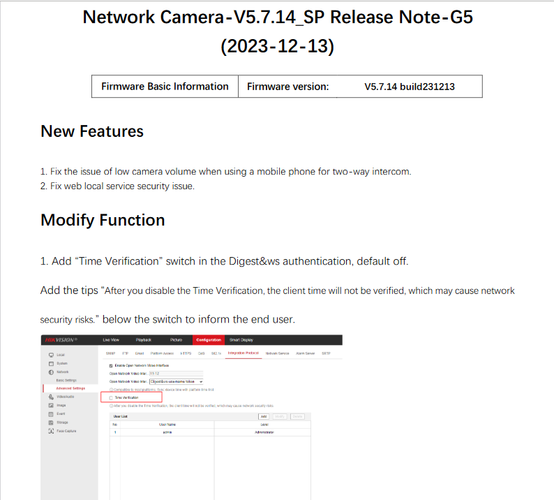

Hikvision pushed a new update for ColorVu camera :
V5.7.14_231213
No changelog, nobody have ?
Thank !
