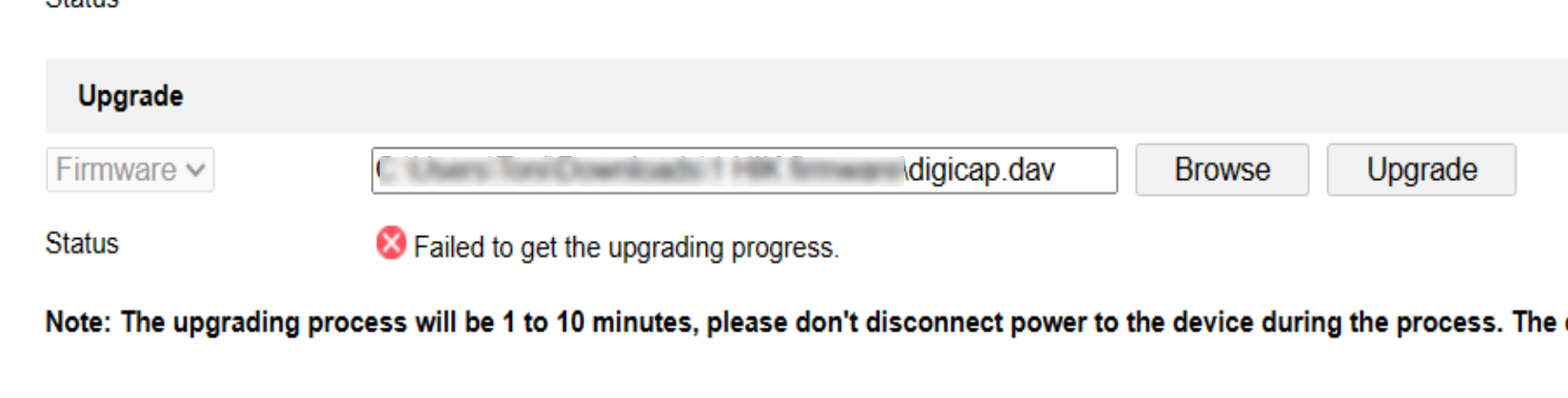

I've been sent a file by Hikvision via Wetransfer. I get the same error message, although this time it ran through to100%, but the NVR did not reboot. I'm waiting for them to advise.

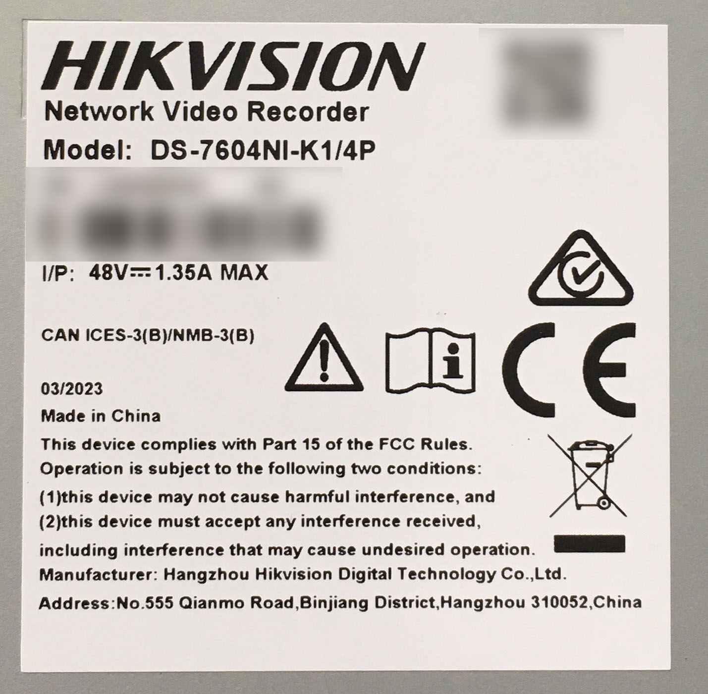

This is the info on the bottom of the NVR by the way...

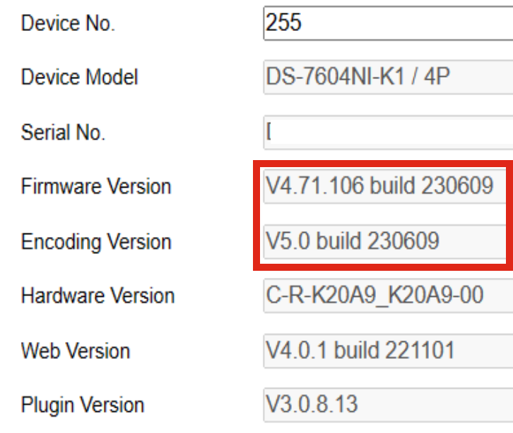

I decided to try running the upgrade from ivms-4200 on a whim...and it worked! No idea why. Perhaps this will help someone else in future.

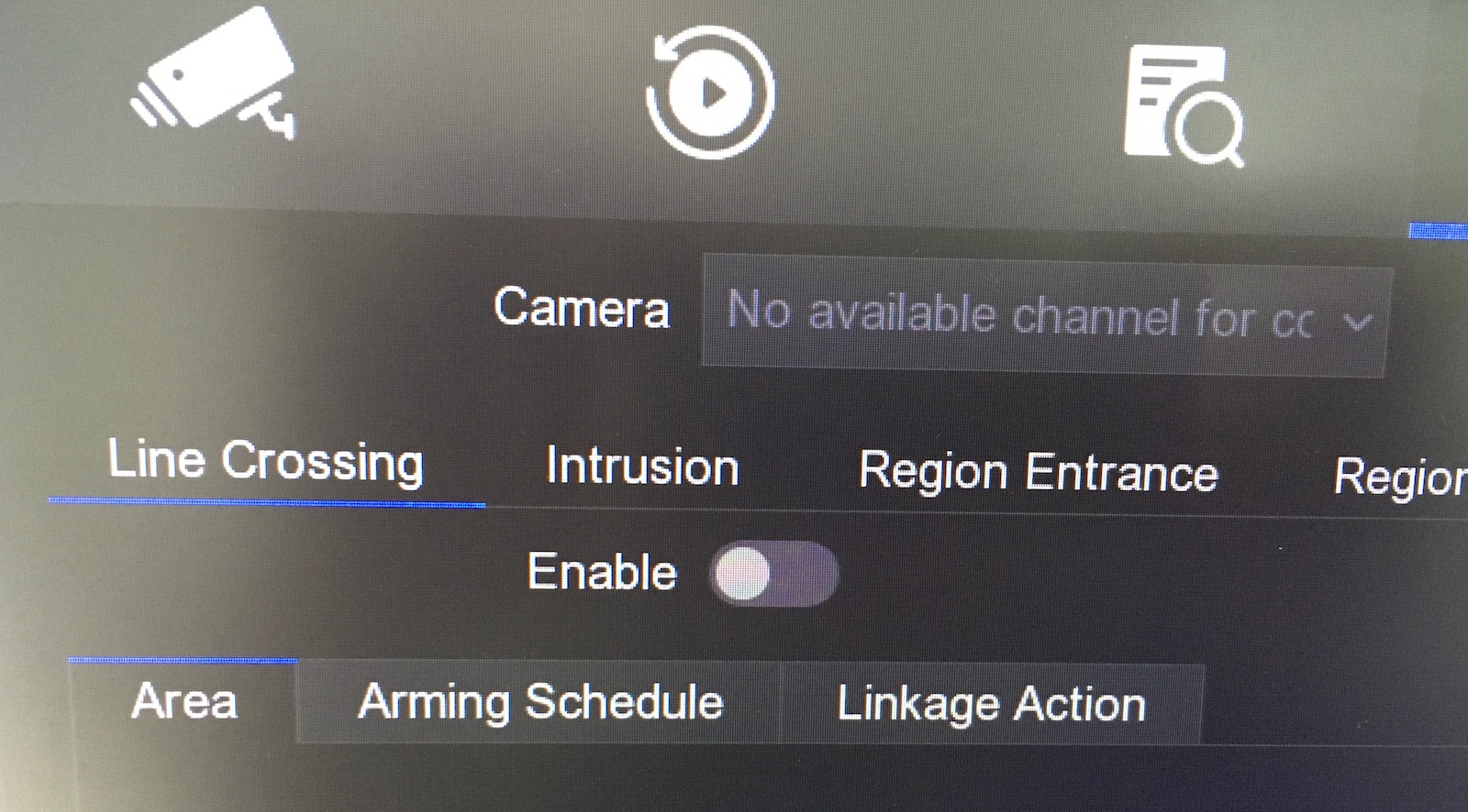

I now have additional menus on the NVR interface, but I still don't see anything in the target detection playback, there's no red indicating motion events - same story as before.
There is now an option to set perimeter protection, but it can't be enabled. Camera dropdown is greyed out (no available channel for...). Perhaps cameras are not supported?
I was hoping to set up line crossing, because as Dan said, motion detection is a blunt tool.
Did you tell Hikvision what your current firmware is?
I am wondering if a full factory reset of the NVR would help, the current config could be corrupted. The key to this is where your existing firmware came from, you need someone who has access to Hikvision technical resources.
I suspect the web GUI firmware upgrade path was the problem, I think ivms4200 uses a different method.

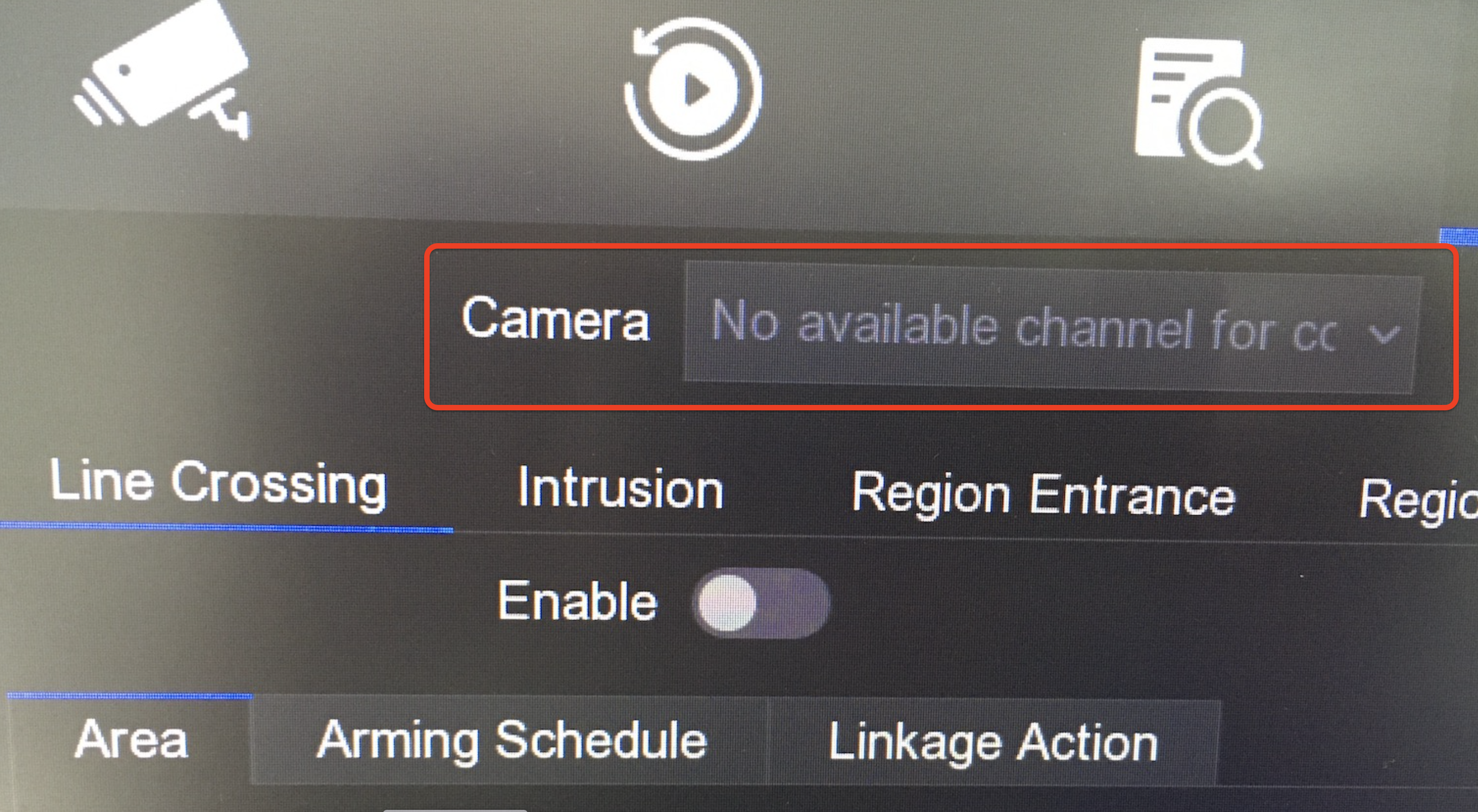

Perimeter protection is unavailable as before (from both interfaces) - not able to toggle "Enable", thus no Line crossing, intrusion etc. are configurable.
It would be great to be able to solve this.

Yes, but the dropdown is greyed out, and it's impossible to toggle the "Enable" button.
Normal events and Face Recognition can be enabled, and the camera dropdown is active.
Perimeter Protection and Other Events both don't have the option to choose a camera, and the Enable button can't be toggled.

I'm unable to select a camera at all. Not on the NVR interface or ivms-4200. I haven't fired up my Windows VM, because I know it will be the same issue.

I have been working on the NVR. Absolutely no way to choose a camera or enable anything under perimeter protection.
Yes, the cameras are connected to the POE ports on the NVR.

I asked them this:
I'm unable to use Perimeter Protection or Other Events with my NVR. Can you confirm whether this model supports those features? Only "Normal Events" - (motion detection) - and Face Recognition can be enabled. The dropdown is greyed out and says "No available channel for ..."
My model number is DS-7604NI-K1/4P
