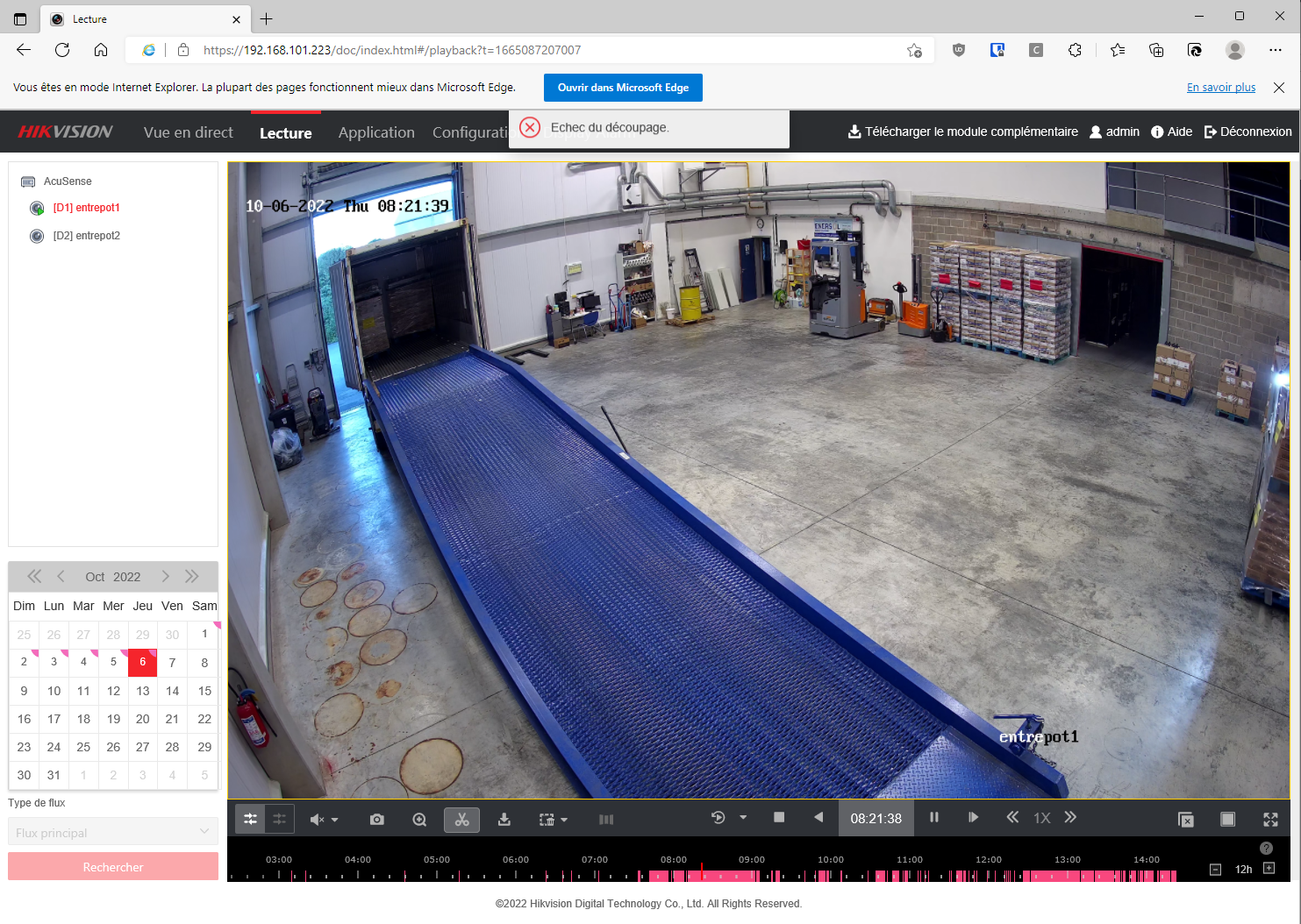

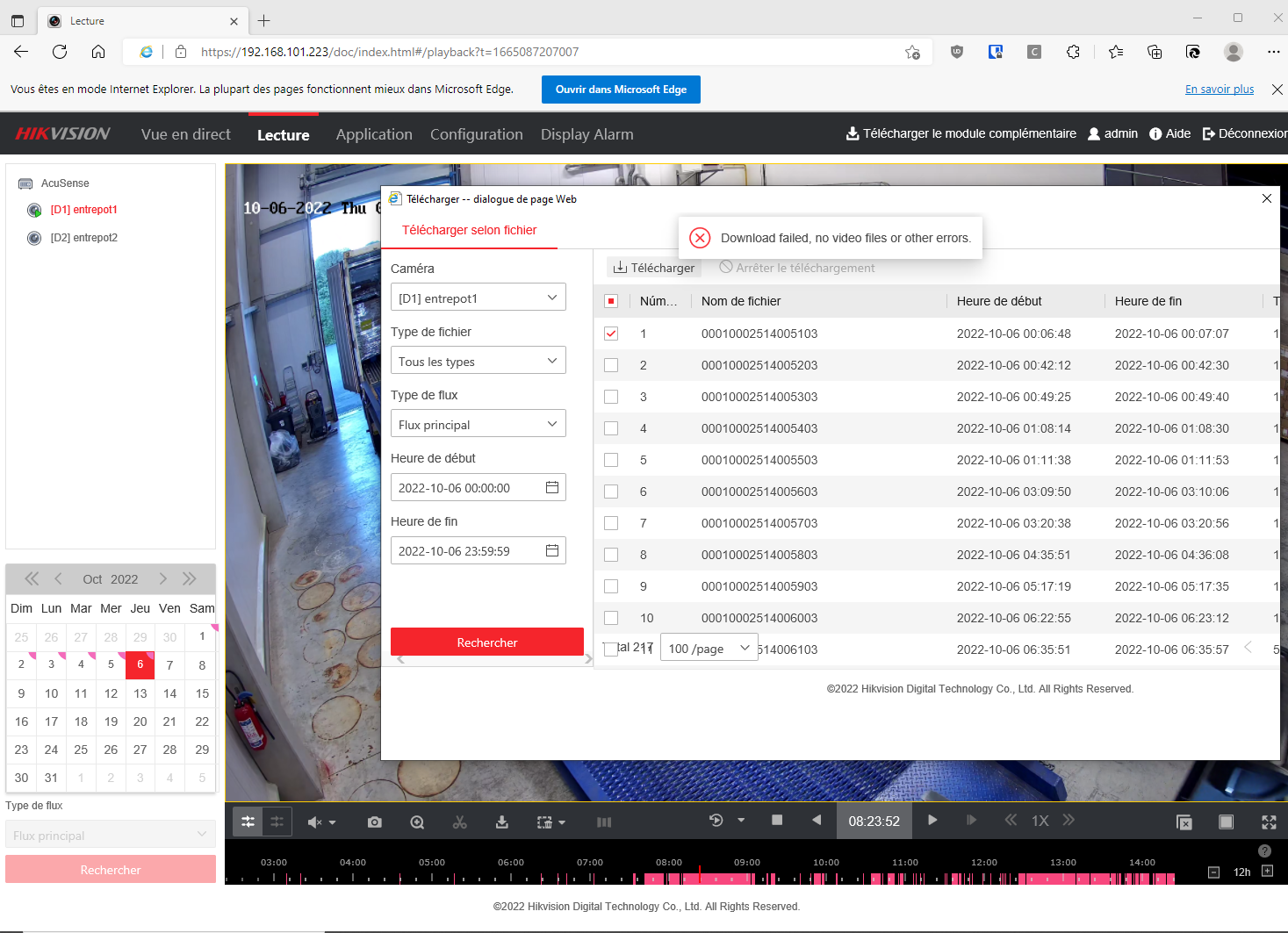

Hello,
I'm not able to cut video or download file... I get error messages. I tried with 2 different PCs... sorry screenshots are in french (unable to get interface in english)
I'm able to view live and reccorded videos bit not to download it...
Any idea or suggestion?
I tried updating webcomponent.exe... with no success...
Thanks for your help, questions, experience, ideas...
