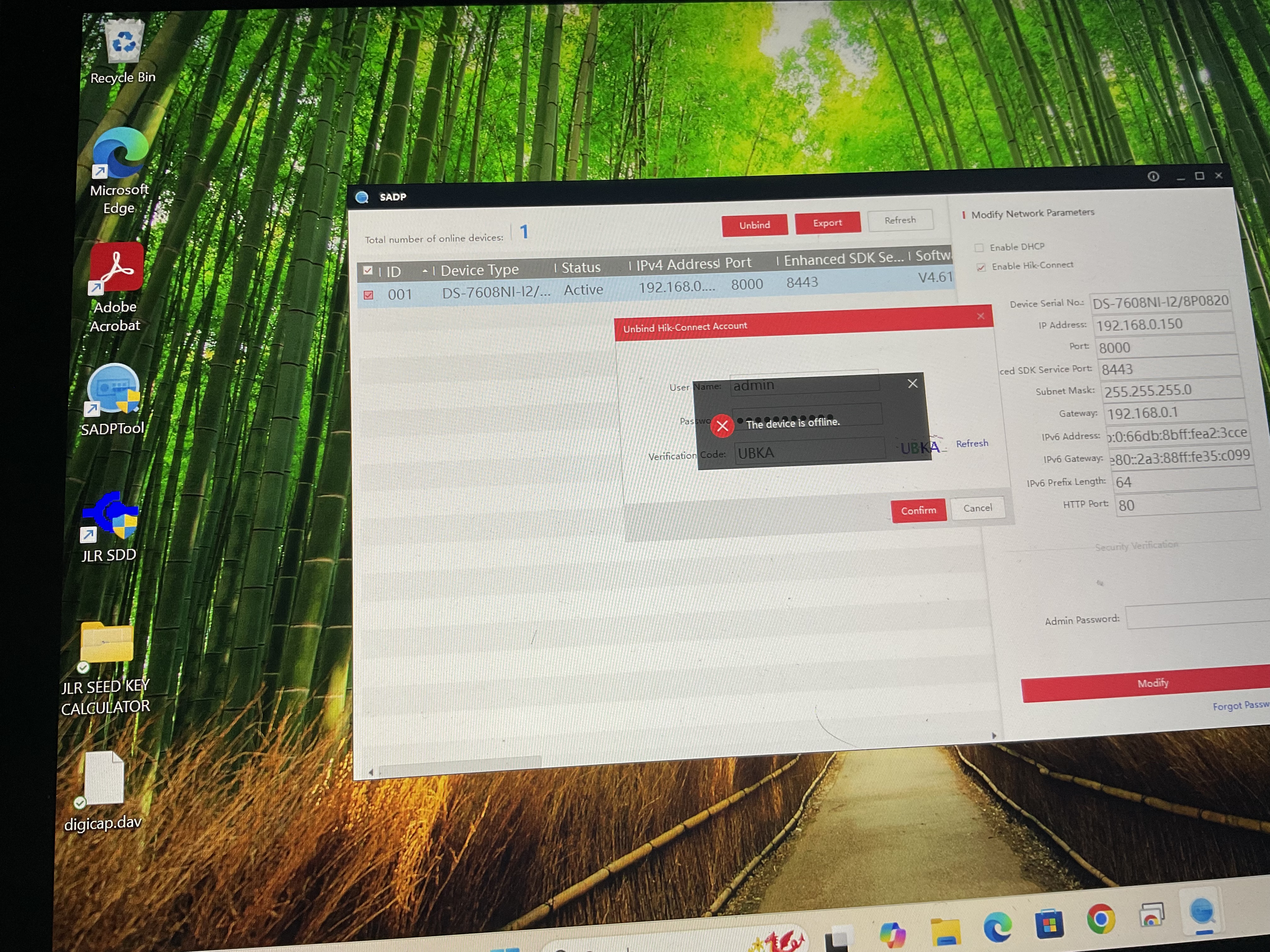

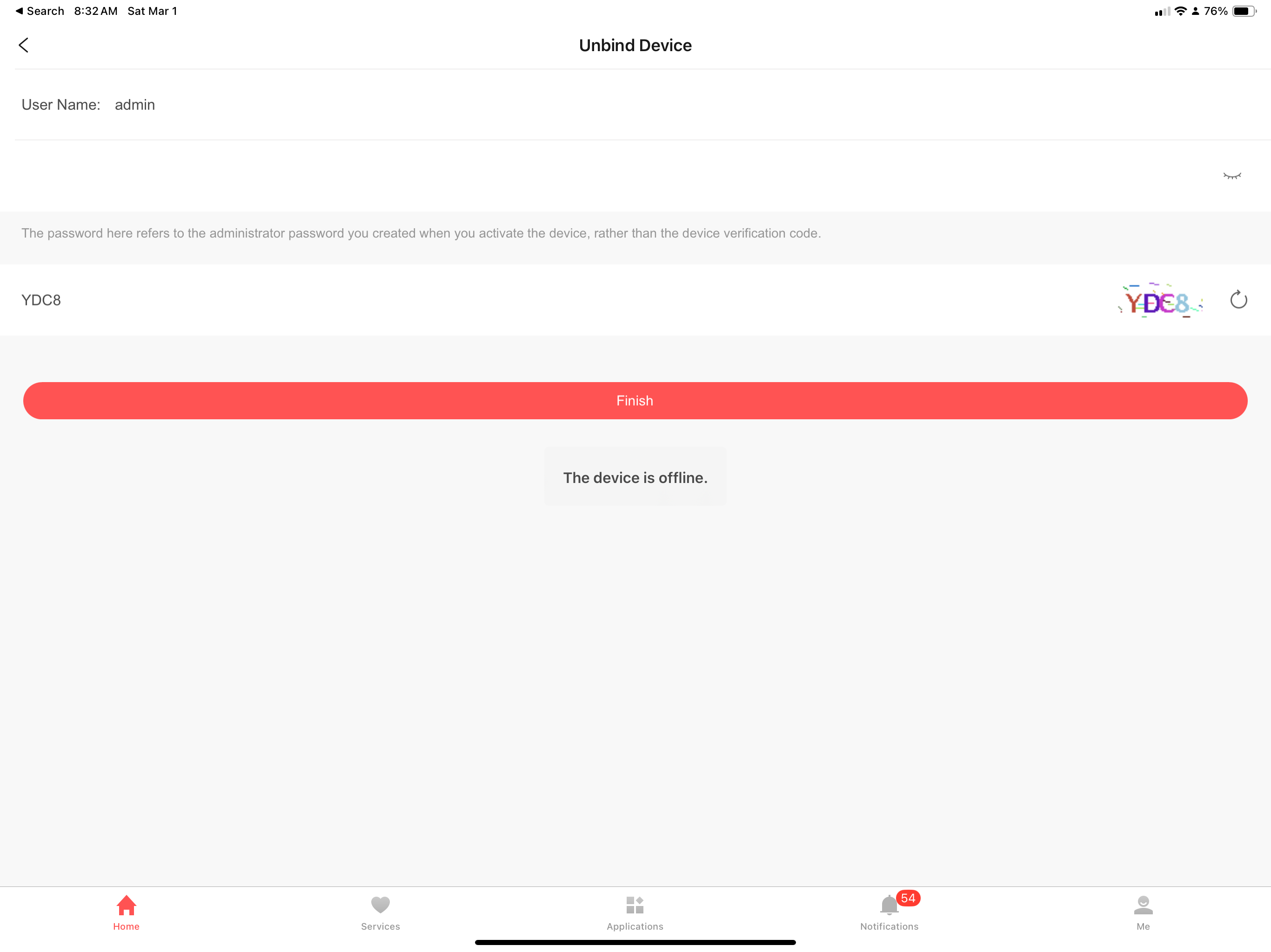

JB was so excited to see your message with more options. Too late to try last night when I saw it. Anyway couldn’t sleep so wasted a few hours this morning.
Annoyingly the fault I get now is device offline on both SADP and hikconnect.
Think I’m done for with this one, and the one I did a software update on for him.
Thanks for trying however, it is appreciated.

I hadn’t but I’d already made sure they were set, after your message i was inspired to have another go, including deleting them, different options, setting it to DHCP all to no avail.
Thanks again though for taking the time to give support.
