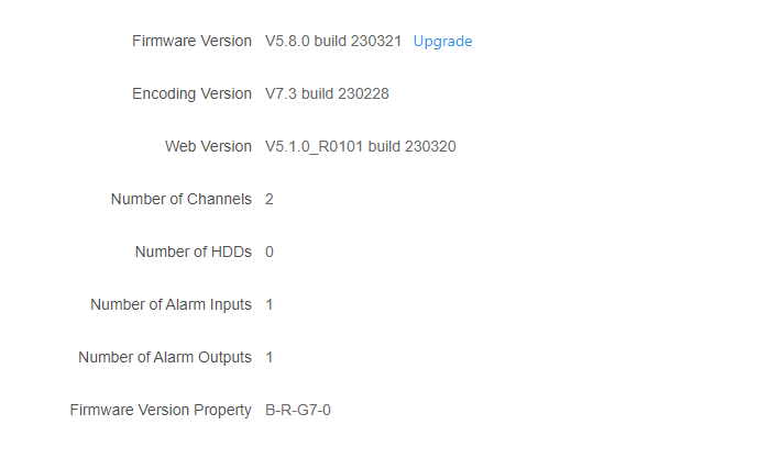

But I think it is more as errors caused by the new GUI. (web version 5.1.0).. When I call hikvision support, they are surprised with the new layout.

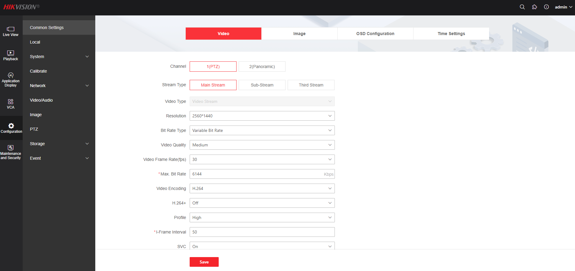

How can I get this information to the right person, because tech support just informs me to file a guarantee and have the unit replaced. and if the new one has the same issue? sure it will be a firmware problem..

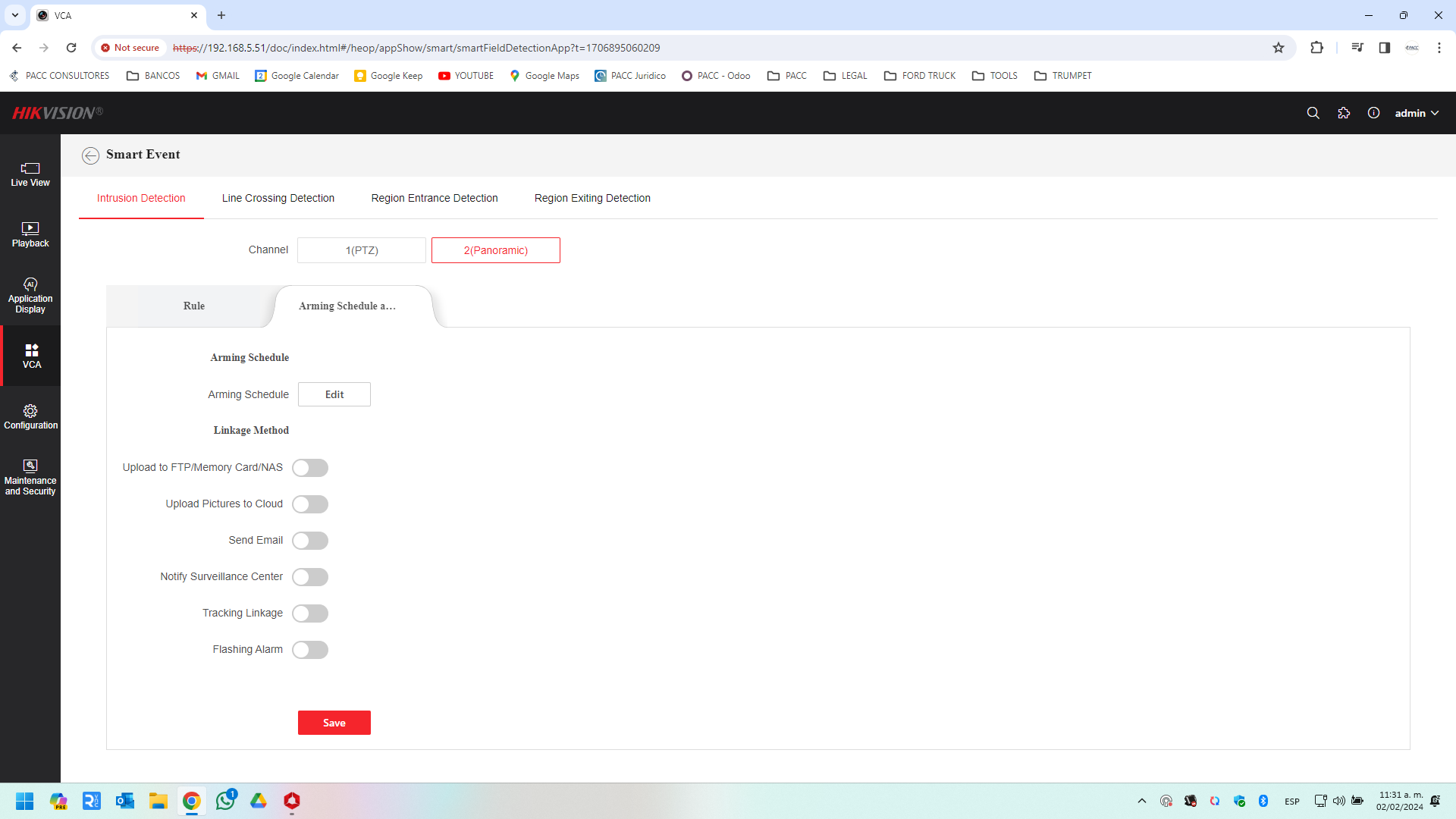

I cant even find there menu references on my unit.

This is the problem, with the new GUI, these menu optiones are not there. Some times when the page loads very slow you can see them before they disaapear. I has requested a old gui firmware but with no luck.

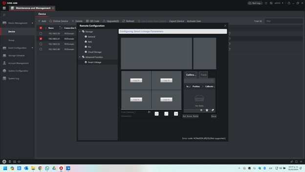

I get an error HCNETSDK.dll when trying to configure the smart linkage. Do not know if this helps. When using the iVMS-4200 for Windows I get all the same menus and options.

With regards to iVMS-4200, I think you should also have the option to open 'Basic Settings' after clicking on the cog, which should show you the configuration menu you normally get in a browser - could you check this too please?

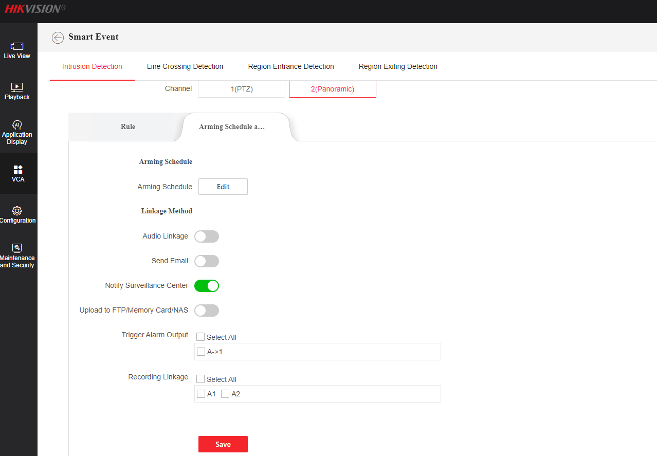

In this screenshot you can see the tracking options and flashing alarm, but these are only visible for a few seconds and then they disappear. It took me several tries just to capture these options. What I understand here is that when movement is detected on this channel, the PTZ moves to that area, as it is linked.

Thanks, the video / screenshots are clear.
I'll share everything with Hikvision and ask what they suggest and if earlier firmware is available.
