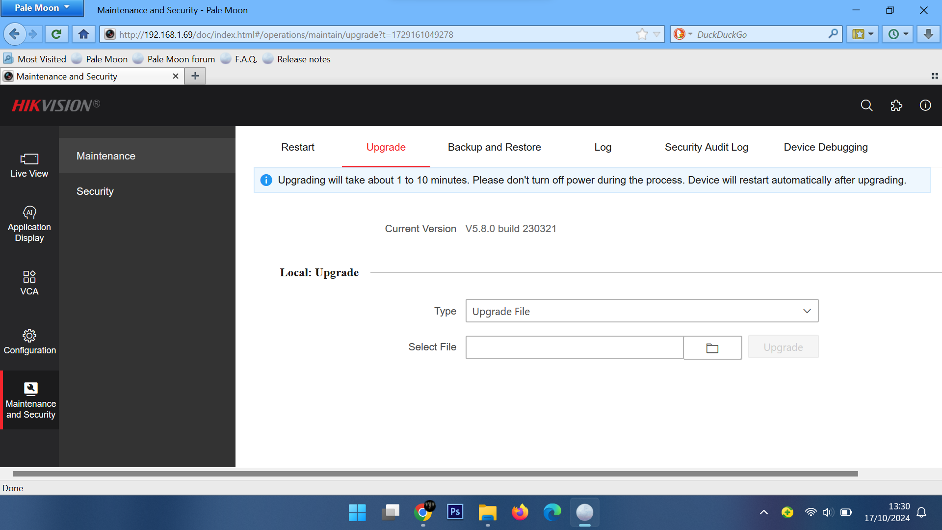

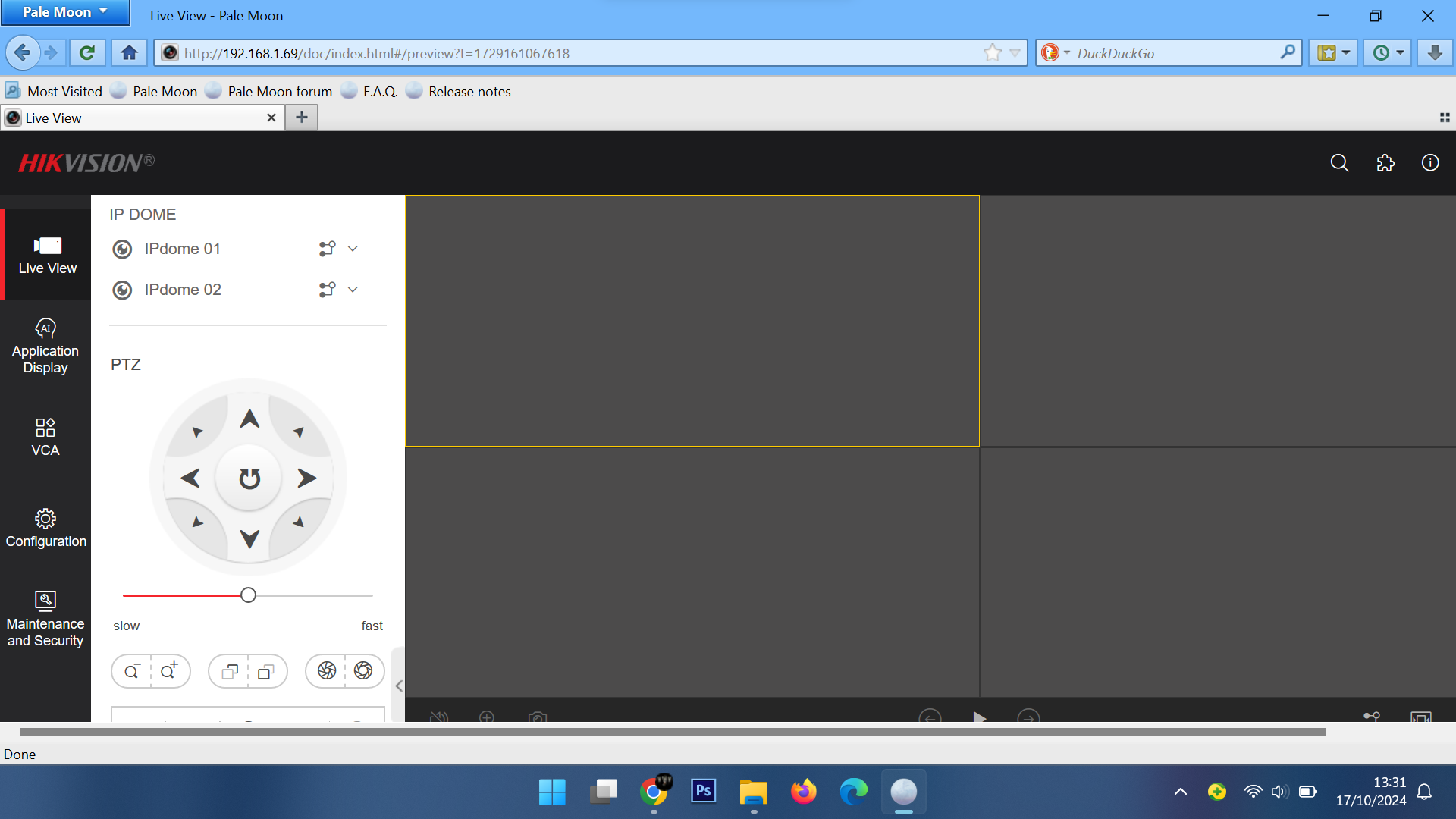

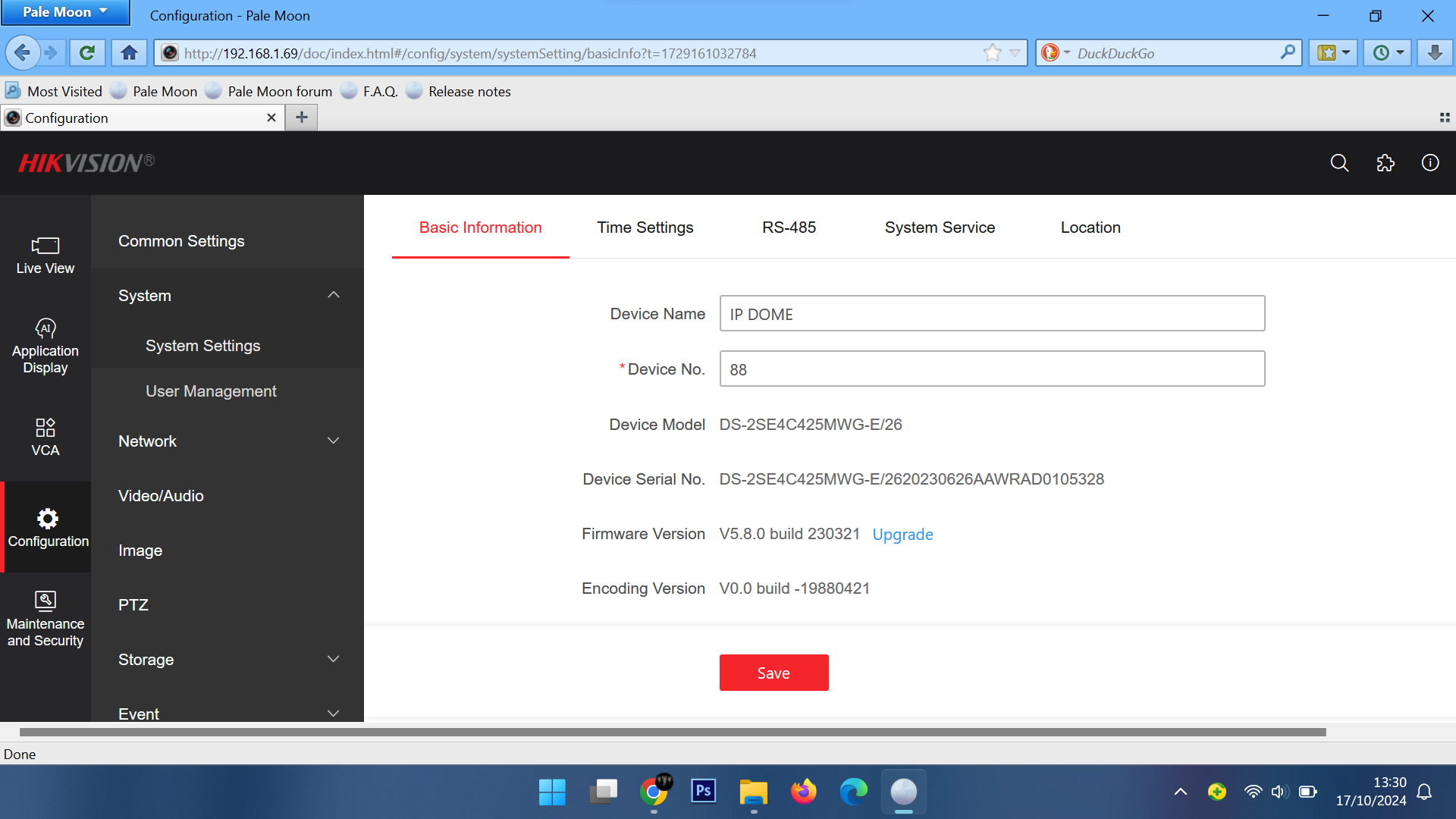

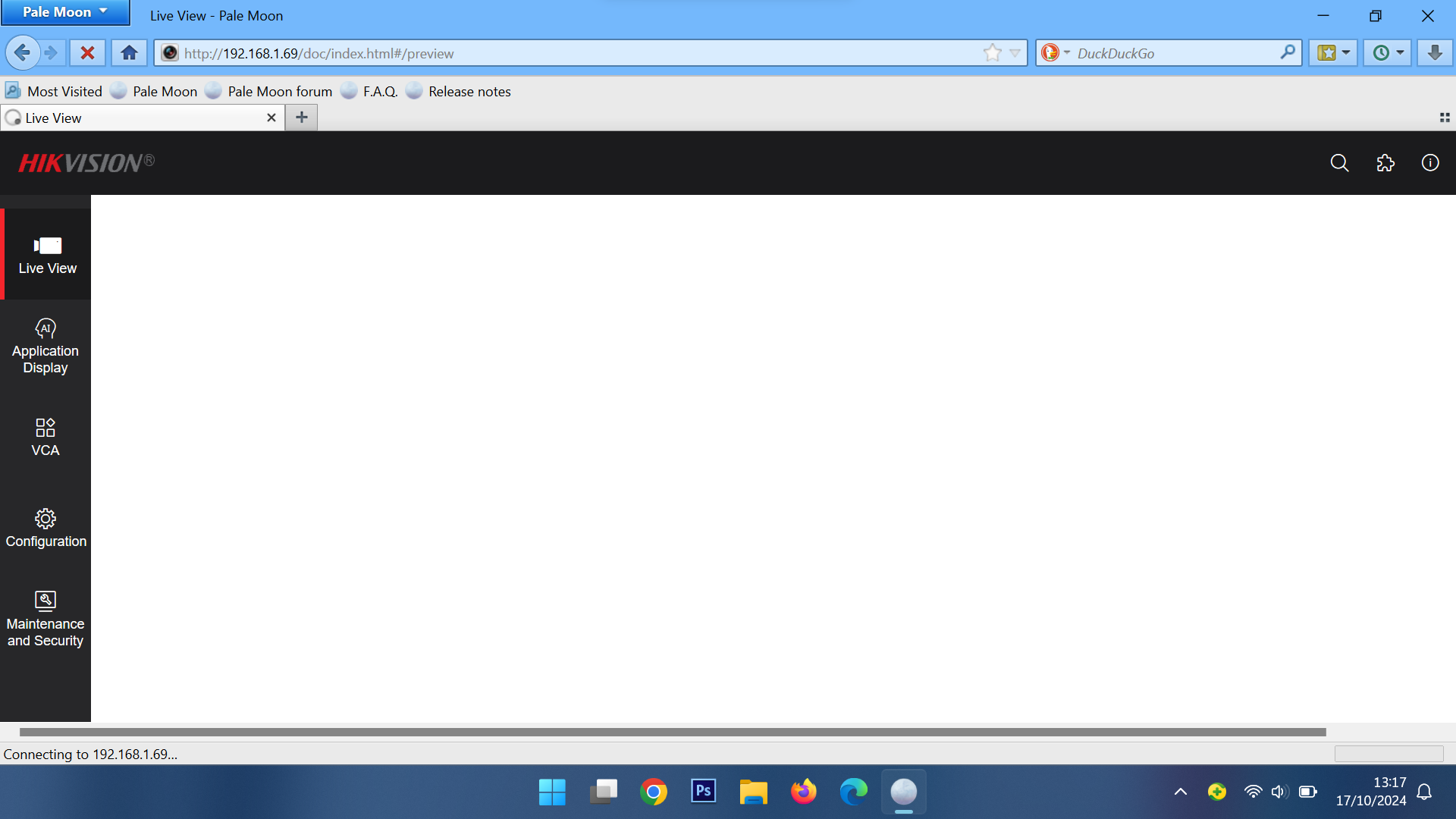

I have this ptz ds-2se4c425mwg-e-26-f0 camera. I can view the camera in the SADP tool and in the web browser but the cameras don't show any images and videos.
I have tried to upgrade the firmware using the batch configuration tool but all in vain. It failed to show videos on the NVR as well. It also has a boot loop every after 15 minutes.
I have tried using Pale Moon browser 32 bit and IE but the issue of the reboot every 15 minutes is still existing.
Surprisingly I have 3 cameras and it's the only one doing this.
Unfortunately, I can log into the camera and access its settings but it won't display anything. Attached is the image of what I see.
Any other advice, please..

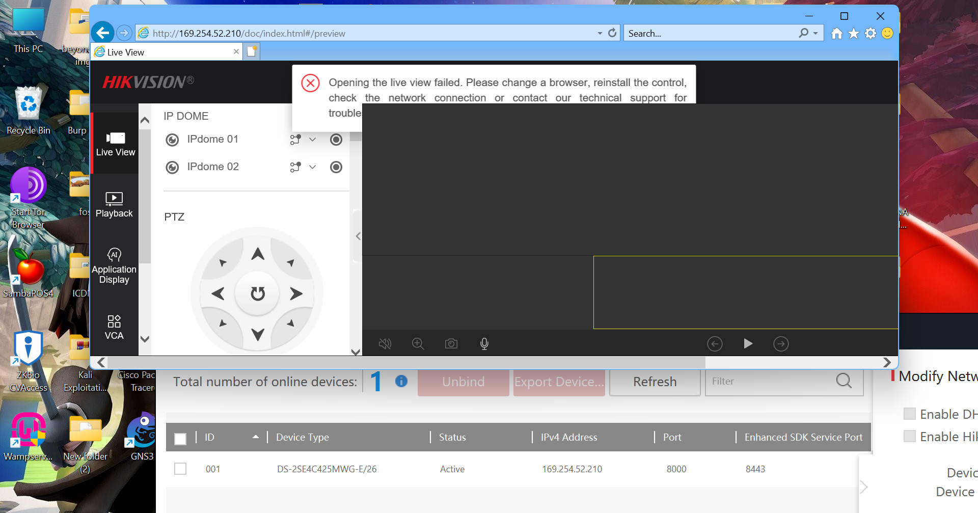

Attached is an image of what the camera shows.
