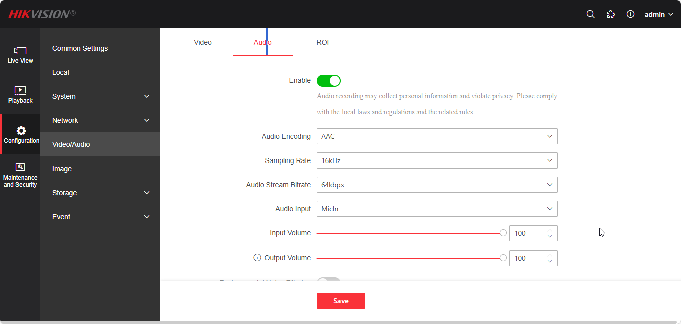

Can you share a screenshot of the audio settings in a browser from one of the cameras please?
